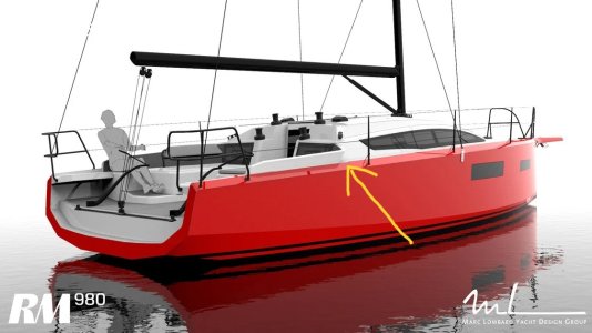

Reckon RM are onto something, with their RMxx80 series designs. Which sport a Class40 style deck breakwater. Here on a render for the new RM980

Reckon RM are onto something, with their xx80 series designs. Which sport a Class40 style deck breakwater. Here on a render for the new RM980

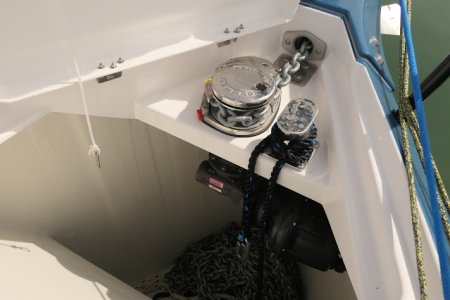

Not often you see a cleat for the snubber built into the anchor locker. Detail from a different RM1080. Like you say, thoughful touches.....

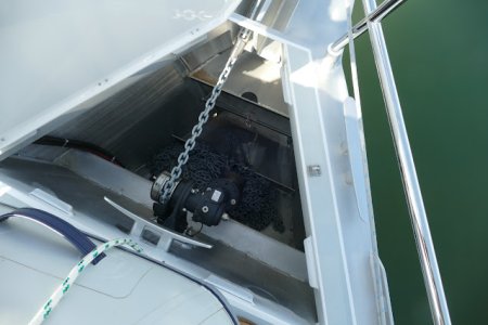

Better effort on the Ovni 370. Integral snubber cleat mounted higher, with direct lead to a dedicated roller at tip of ‘sprit. Not sure about sailing performance / upwind ability though. Lovely secure cockpit and impressive deck saloon accomodation. With (most unusually, in latest designs) plentiful & practical stowage. Even a wet locker. No more drying foulies in the shower!

Not sure about the direction of pull on that cleat. Looks more like a token effort rather than something I’d like to rely on in a blow and waves
Ovni must agree. The pic in the post was taken on an early boat, which I was aboard in 2022. A boat review shot last summer shows this improved cleat arrangement. With a better angle of pull. (Although, being an ali boat, the cleats are welded, rather than bolted, which must also add strength)

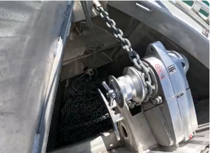

Hello John,
is the photo mirrored? Left is right/right is left?
My photo in post # 212 is un-manipulated. The video screenshot, in #215, I can’t vouch for. See why you ask though. In ‘my’ pic the chain exits to port, in screenshot to port......possible explanation is that 'sprit is twin roller (see below). Although the second roller looks more intended for the snubber / a mooring line. rather than for anchor stowage. Although, if the anchor were a roll hoop type, that's where it would have to go......But possibly some manipulation in the video. It's here (should open @ relevant bit).

Yep sorry, the windlass is a Lofrans Cayman, it usually comes with the chain gipsy to starboard and the rope drum to port; I have a (rarer) factory version with both gipsy and drum to starboard; the picture/videos shows both gipsy/drum to port, I was wondering if they have introduced a third version

Personally much as I love the Ovni's I'm not a fan of the first arrangement trying to pull the cleat off the bulkhead, or the later arrangement with the cleat underneath the windlass which is a pain to reach, especially if trying to work it under any tension. On our Ovni 385 we just led the snubber line back to the main deck cleats and never had any issue, and some of the Ovni's had a central welded foredeck cleat for that usage.
