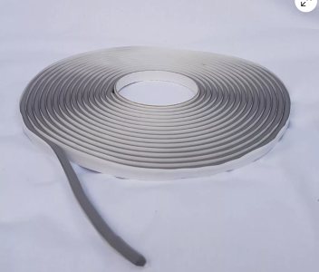

I always use Butyl tape - never sticks permanently and always flexible. If fitting windows etc always use a small ss washer where the fixing screws are so it doesn't get all squeezed out. Alternatively use the rubber adhesive 'P' or 'W' profile draught sealing strip where water tightness is not critical or if you need to remove items occasionally.
