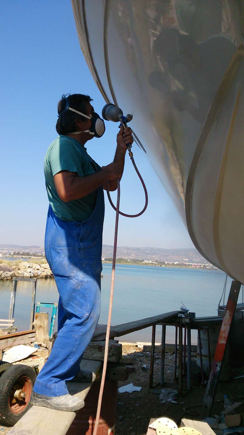

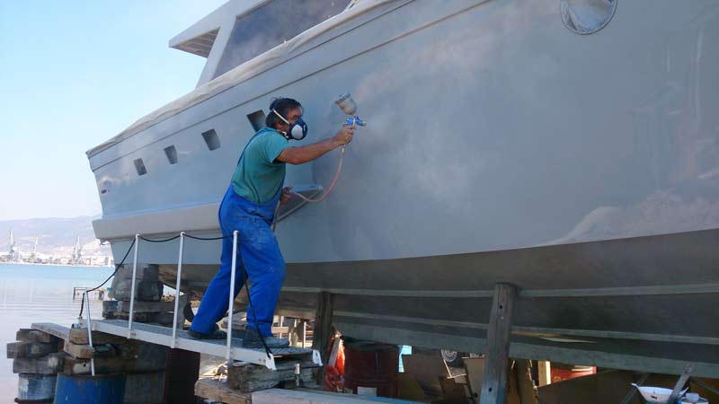

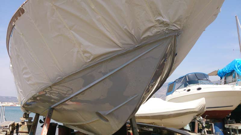

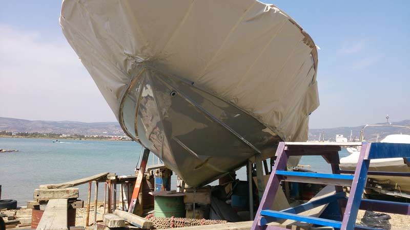

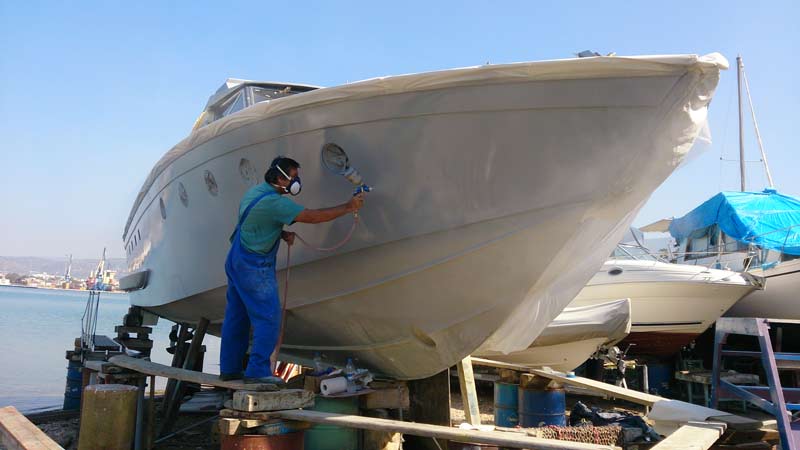

Seriously, I was actually confused myself when I saw Alekos painting only the top. He explained that the hand/body movements done in order to get this brilliant result can only work in certain area sizes (relating to his physique and size) and the chine with the need to actually have a lower thing to stand on and the overall height of over 1.5m is not feasible. Took a video of him painting the second set of top coats, explains why it wouldn't work, will upload it sometime after editing/converting.
Mind, now he has to mask the bloody lot in order to paint the bow from the chine down to the yet unknown W/L. Painting low and after the winter in the water, I'll adjust the antifoul up to the right level.

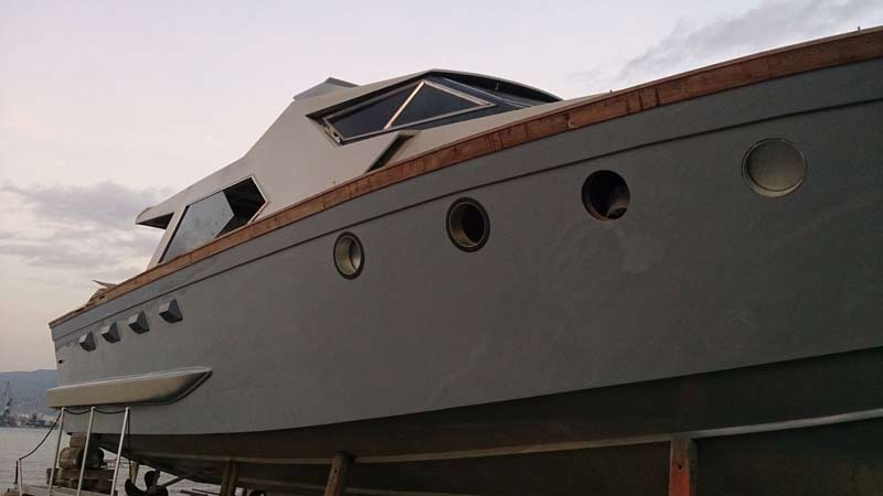

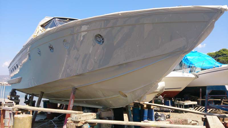

Today stbrd side was done, again result is amazing, this time took a few more pics while painting:
And this is the result:

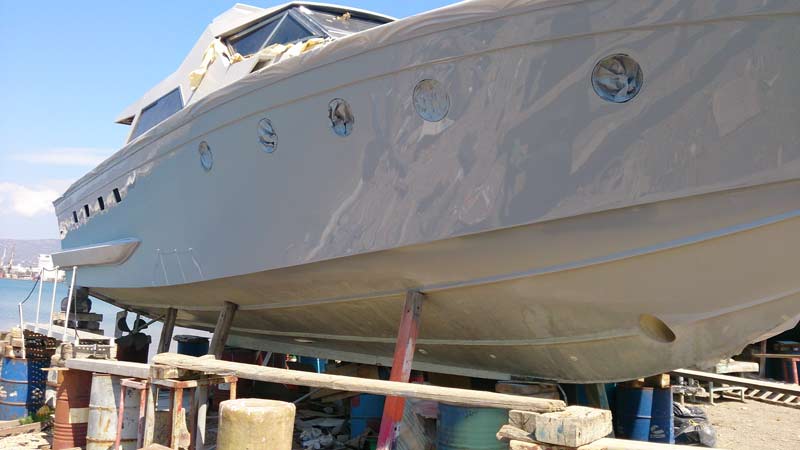

BTW, got the courage to do the port side skin fittings:
  • shower
  • bow bilge pump
  • blackwater tank vent
  • diesel tanks vent
  • water tank vent
  • galley sink
look excellent (but forgot to take pics as Alekos masked the whole port side before painting)

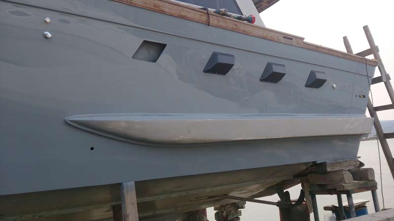

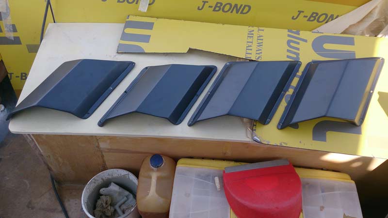

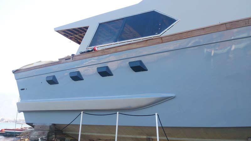

now, after half a week of unstable weather and a few showers, we're back in summer mode. Alekos painted in a mat charcoal grey the engine vents, portlight rings, AND today after 3h of preparation (2 of them were masking ffs!) spend 20mins painting the lower bow bit.

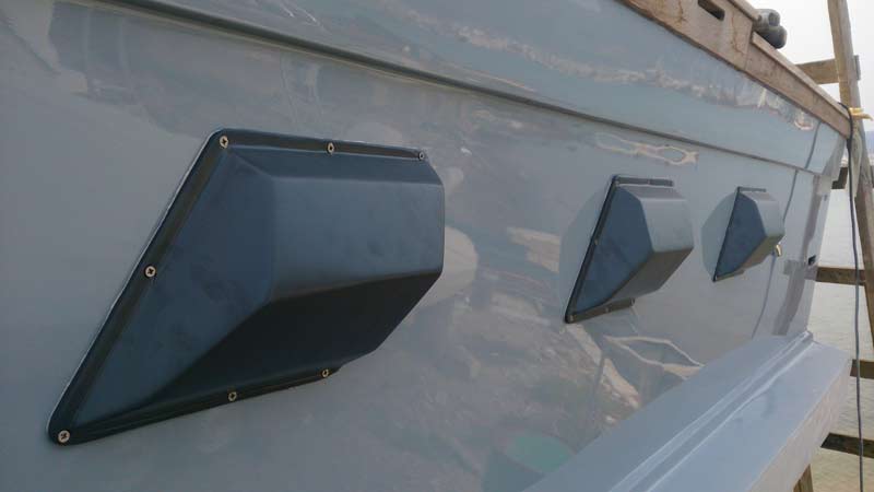

Stbrd side vents to be fitted tomorrow:
port side (bar one that had a tiny prob and will be repainted together with the exhausts this week) :
closeup, I issue is that unsurprisingly there are no black ss countersunk screws... I can live with that as they barely show from a distance and I want to be able to remove them easily for repairs.
Also, used TDS grey caulking that I used for my teak to seal them in place. Hope it's going to be ok (should really!)

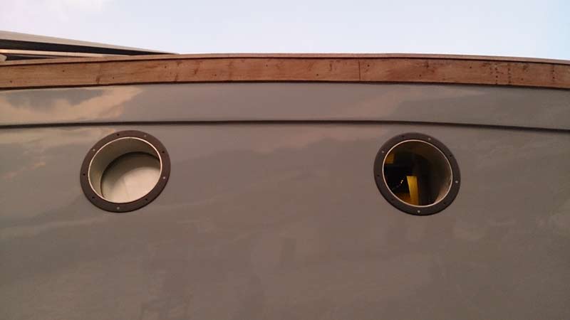

OK ppl, two more issue!
Did the stbrd side engine vents and temp bolted the two portlights for the stbrd cabin (that's daughter's cabin)
Then bolted (temporarily) the anthracite mat ring outside.
Now end result looks carp (unsurprisingly...)
Bearing in mind that most of the portlights have some degree of pitting on the "tube" from the glazing to the hull, it does make sense to pass them over to Alekos for some treatment and painting at the same anthracite (just the tube)
Inside can remain anodized alloy which is generally in excellent nick except for the brass/chrome plated accessories which I'm removing for replating (as I did with the light fittings couple of years ago)
Mind the one on the left of the pic has the "window" and blind closed, the one on the right has them open. Blind is a plane sheet of anodized alloy so looks whitish from outside.
I guess we'd all agree that the portlights part visible from outside should be the same tone of anthracite grey.
So a bit of extra work for Alekos (and for me disassembling ten portlights!)
Second issue is that Alekos finds the shiny ss bolts too much and wants to drop a blob of paint on each one :eek:
