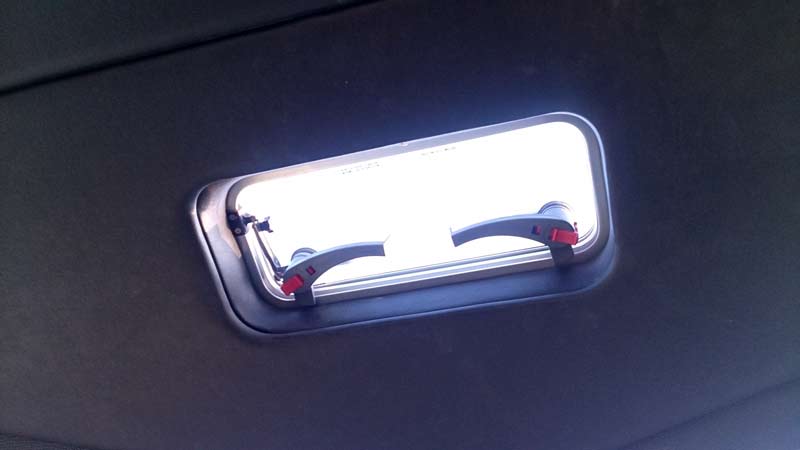

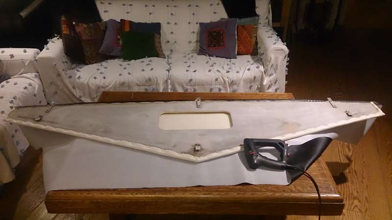

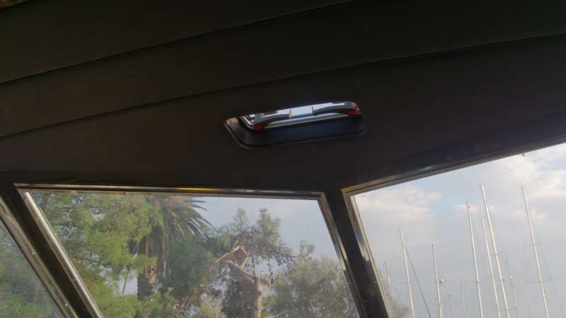

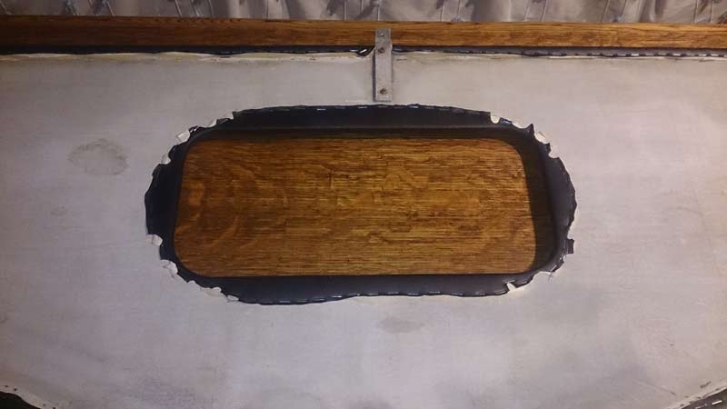

Last week I decided to have a go at a bit more upholstering finishing the lower helm roof lining, and particularly the piece with the hole for the newly installed portlight. Worked out quite well, and fitted it in place yesterday evening. Following pics show the lining process (took me a good 2hrs..)
and fitted in place:
As you've probably seen on the horn placement thread, horn restoration hasn't gone as planed, so I'll pick that job up later (knowing me, probably two days before launching...)

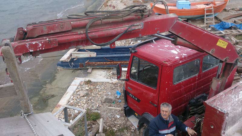

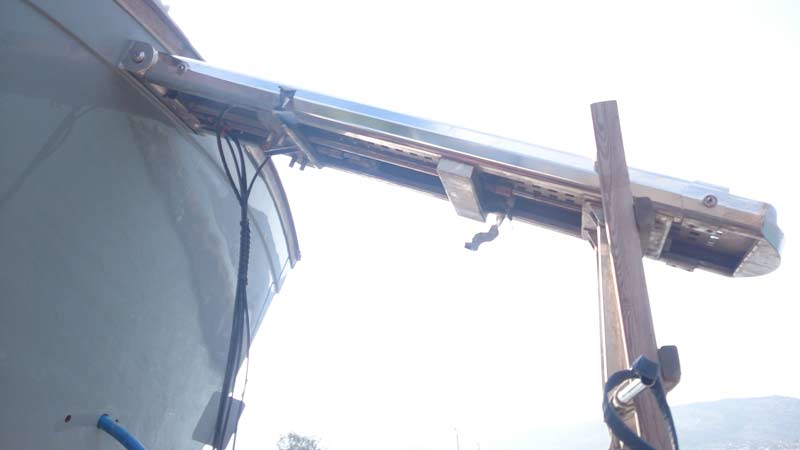

The other job postponed for ages was the passarelle fitting. Being a good 50-60kg lifting it by hand to 3m something in order to get the 400mm 14mm dia bolt through the bracket already mounted on the transom is pure science fiction. So got my next door neighbour (in the boatyard that is) with the P45 to lift it and hold it for me with a small crane. Job done in 10mins!

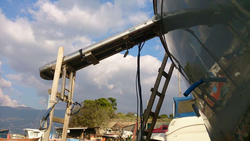

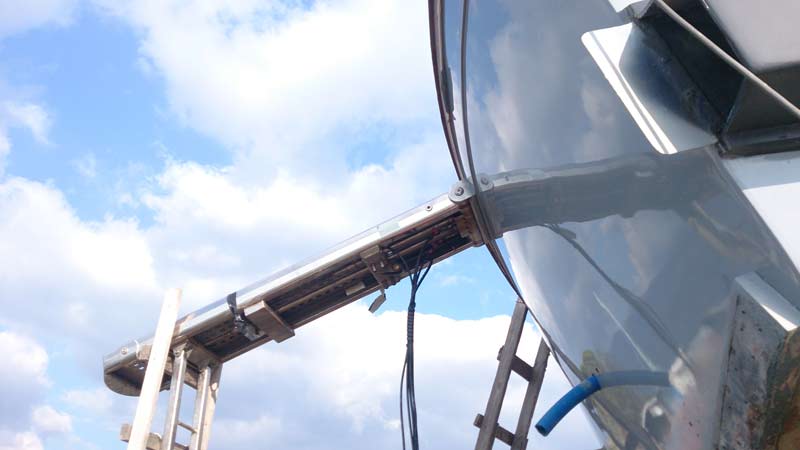

We temporarily put a ladder to support the passarelle at what I roughly calculated as the lowest spot and I now have to do all my calcs so that the passerelle has the right travel and still be able to perform it's intended actions.
Passarelle is rather long, approx. 2.7m fully extended and I want it to obviously not go low enough to push/break the bathing platform on it's supports, nor stay too high up for lifting the tender. Remember some discussion that took place last year, so trying to accommodate all ideas expressed then.
The ladder with the (bended on the one side) cross beam to hook the tender is at 1.7 from the transom and comes down a good 0,45m.
Quick sketch shows that a good size for the bathing platform is 1.3m (at the centre, obviously 1.5m on the edges unless I decide on a curved ending which I find no reason for). AutoCAD section is on it's way, more measurements to be done tomorrow. Bear in mind that the transom slope is approx. 23deg

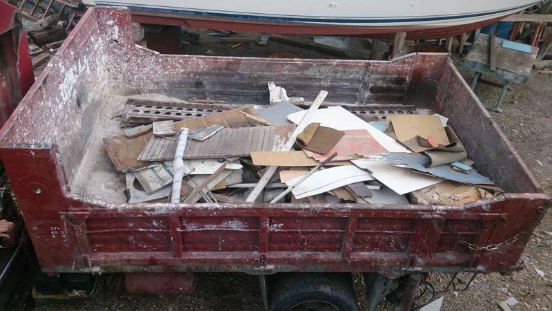

Since crane was on a truck, we emptied most of the rubbish that had gathered over the summer under the boat plus a couple of scrap batteries (with the crane). Need a few more hours to clear up the space and have it ready for antifouling...
V, aesthetic might be the reason. I've seen a few swim platforms retrofitted on traditionally shaped sterns like yours, both with the external border following the same curvature of the stern, and with a more square-ish design.
And imho, the latter looks much more as an afterthought, while the first has a more "consistent" look.
