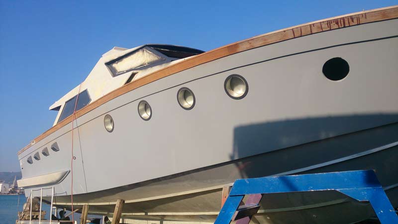

I am gobsmacked at how well it looks painted. All the effort with filling and sanding has certainly paid off.
Re your shinny screws/bolts, can't you heat them up and drop them in some old diesel oil for a nice deep blue colour?
ah, good point, I've done it many years ago, should be able to get a blueish tint like that, will give it a try, thanks!
I am glad Alekos wants to paint the screws!
I was thinking black screw caps might be an easier solution?
Alekos is very keen on doing a proper job and doesn't like shortcuts.
IIRC screw caps mean certain type of screws with a threaded hole in the middle (but may be wrong) Doubt other snap on covers are going to last the heat, vibrations, salt and uv out there.

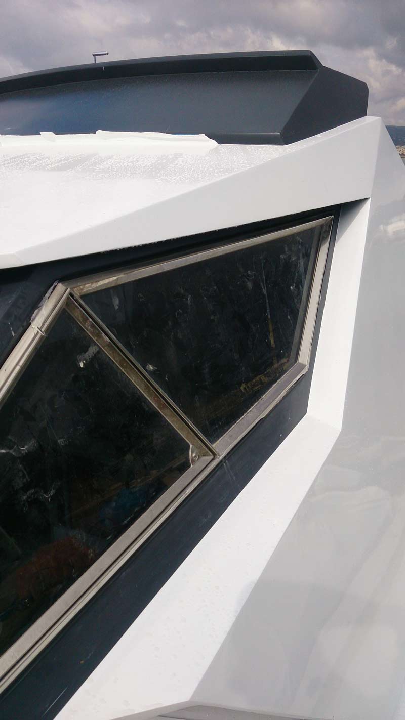

None commented on the anthracite ring and alloy tubes on the portlights though!
V.
Ok I wasn't going to say anything but I think the anthracite grey doesn't look right on the porthole surrounds, IMHO it would look much better in the same light grey that has been used on the hull and then I don't think you would need to paint the tubes anyway. Just my 2c.
Ignore this comment if this is the original colour scheme of course but I don't think so.

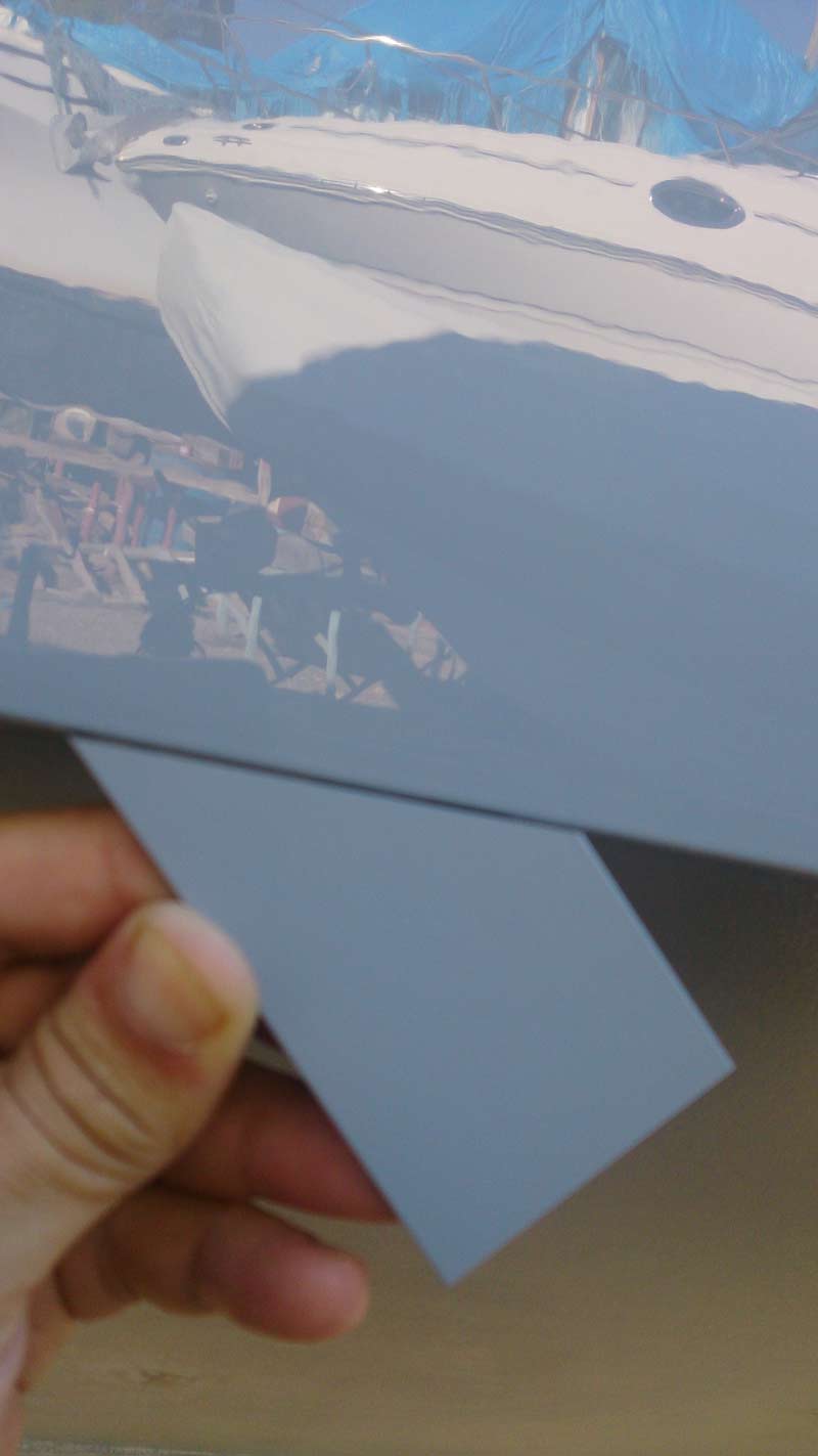

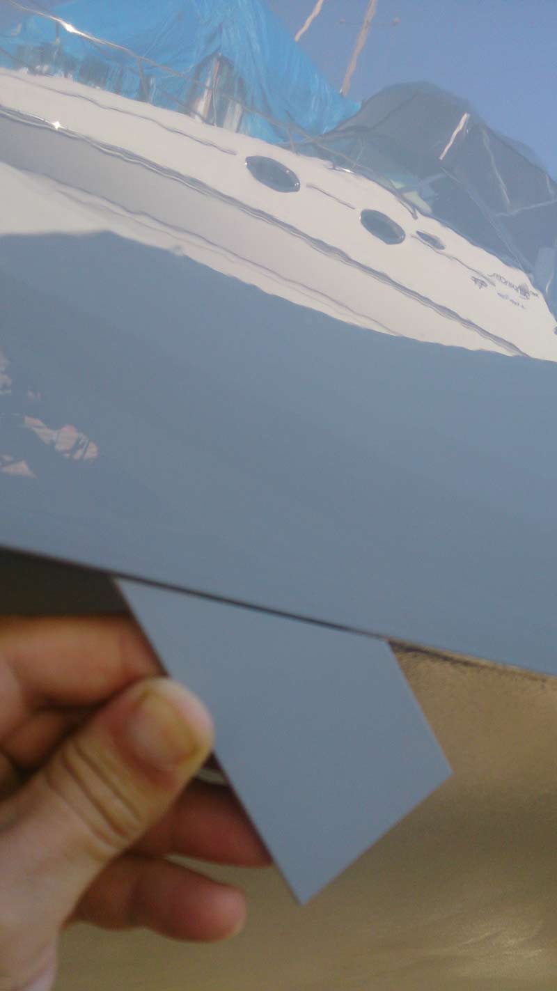

That is one approach, the more discrete one if I may say so. Not too keen tbh, and wanted to have these 9 elements on each side show and "mark" the hull, not hide in there.
Vas I stole this photo from another post today. A very nice swift trawler with a dark hull. How about getting the portlight rings plated?
Yep, if I had paint the hull darker, the polished chrome look would be excellent, but mine is much lighter, so the contrast is not going to be enough.
Further, considering the pitting on the anodized alloy after almost 40yrs in the sea means that there's no way they're going to polish properly.

Alekos agreed that anthracite ring and pitted alloy tube is carp, so he's going to lightly sand, fill and paint with the same anthracite colour the inside of the portlights sorting out my great problem regarding polishing and sorting them out.
Inside, everything will remain anodized alloy (no pitting and in generally excellent condition).

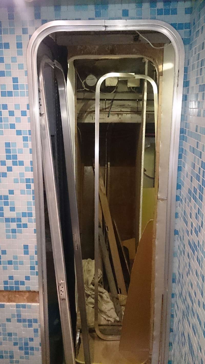

All that means that I have to somehow disassemble the shade and glazing out the assembly (NOT an easy task) They are hold together at a top pivot point with a ss tube sliced along it's length. Need to get the RIGHT size of pin and press it on/off (I feel hammering it on wont cut it).

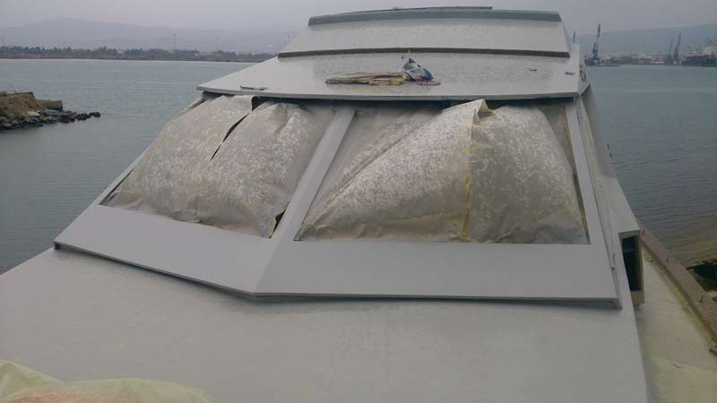

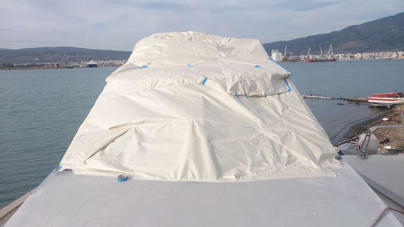

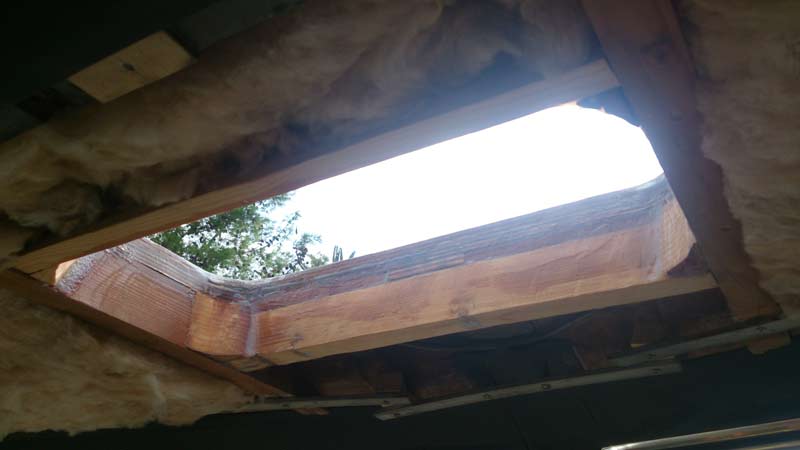

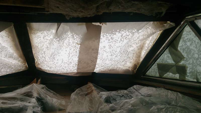

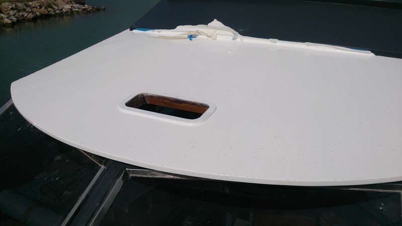

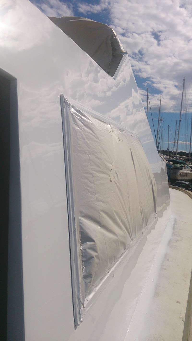

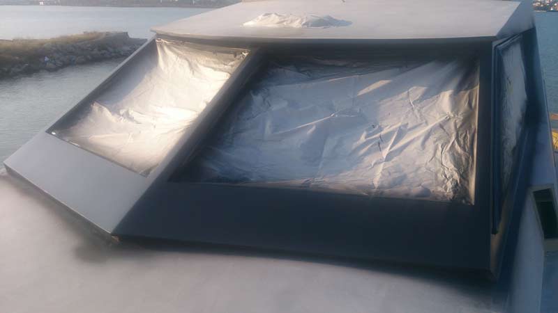

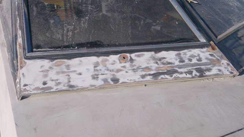

So, removed the two windscreens on Wed or Thu, did the repair, started raining, covered it all up, cleared, Alekos did the filling and sanding and today primed it. Started raining when we met today lunchtime to fit the two screens back in place (temporarily) in order to be able to secure the thick plastic sheet on top and make sure that wind wont push/pull it away with all the water ending in the nice new interior. Anyway, made it just in time (wet polo shirt is drying in the chair next to me in my office to prove it...)
next pic shows the sanded area and the troubling bit between the two windscreens:

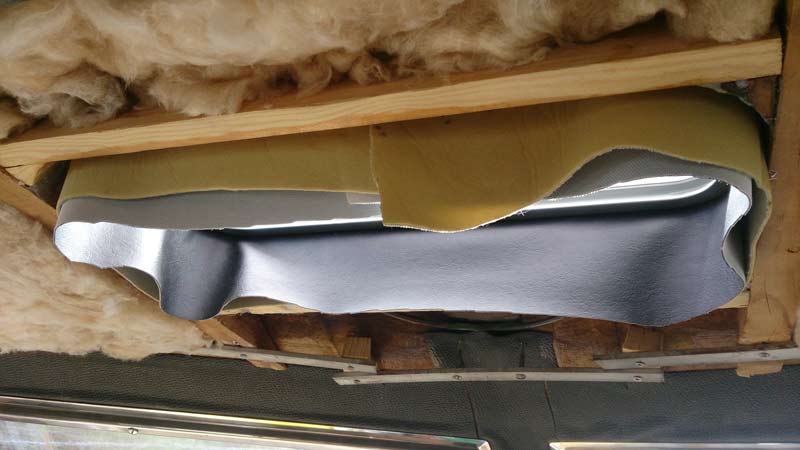

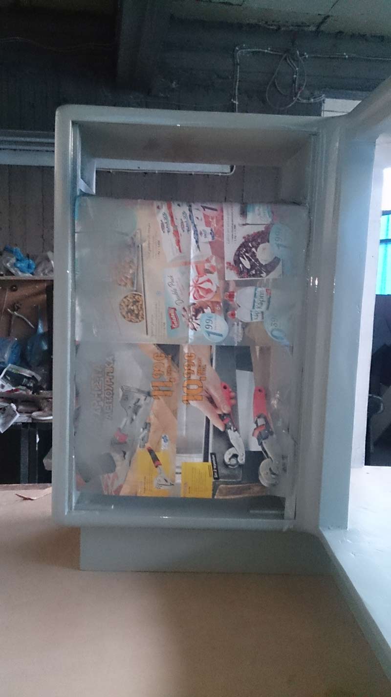

Securing the interior from potential failure of the covers:
All sorted and primed now:

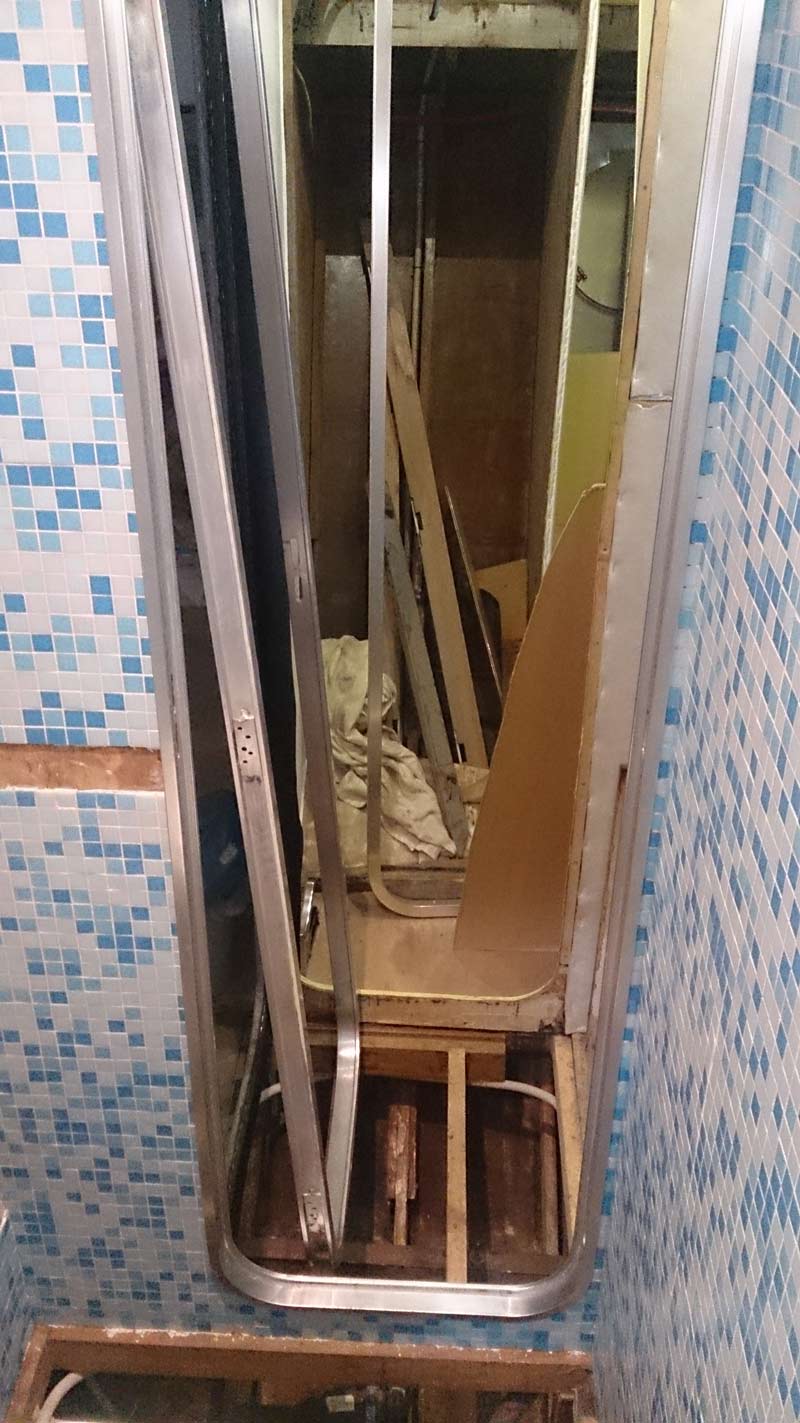

Regarding the salon sliding door, checked with the fabricator, fits perfectly in place and also did a match test of the colour Alekos was painting with the door frame. Seems that we have a pretty decent match, so the bulkhead around the doors will be definitely painted the same hull gray:

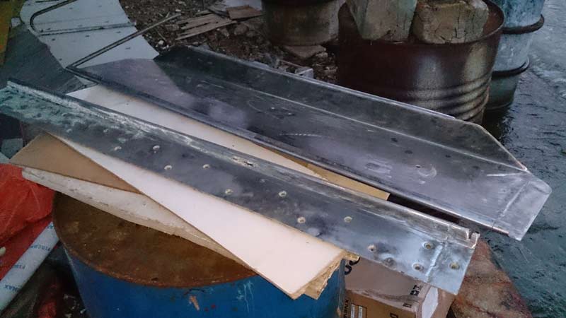

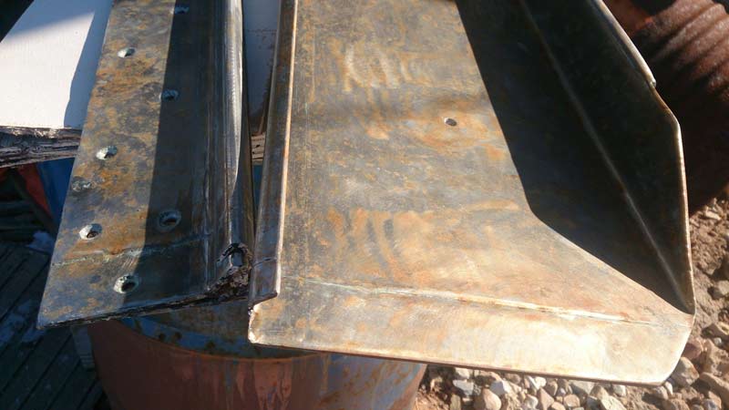

Last w/e did some work on the trim tabs, massive pieces of ss (around 1m long :eek: ) with all sort of carp on them. Sanded them clean on stbrd side, and removed port side as well. Wondering what I'll do to them as:
  • if I'm going to a/f them with normal a/f I've been v.stupid cleaning them so well from all primer and a/f (wasn't flaking anywhere must admit)
  • if I use TK spray and keep the boat in the water all year round I'm going to get some nice growth
  • I cannot use copper based a/f (or even try diy coppercoat) on them (still not happy with explanations given though)
Within one week and a fair number of showers, they have now a bit of surface rust which puzzles me a bit, any ideas:

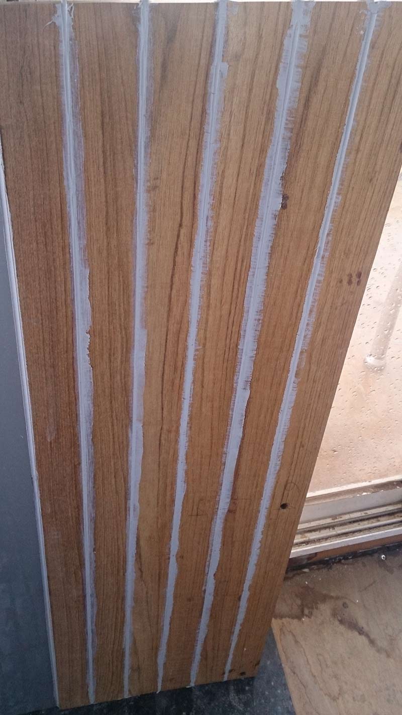

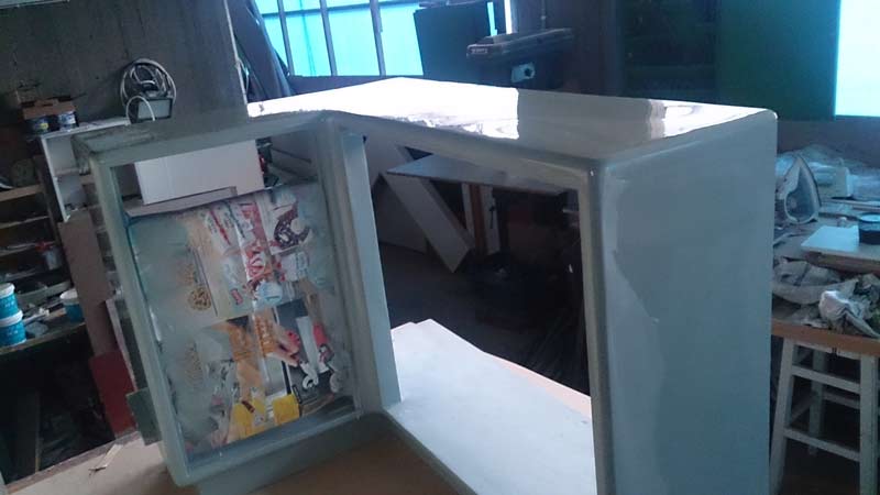

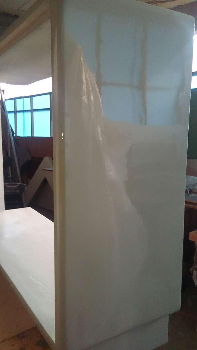

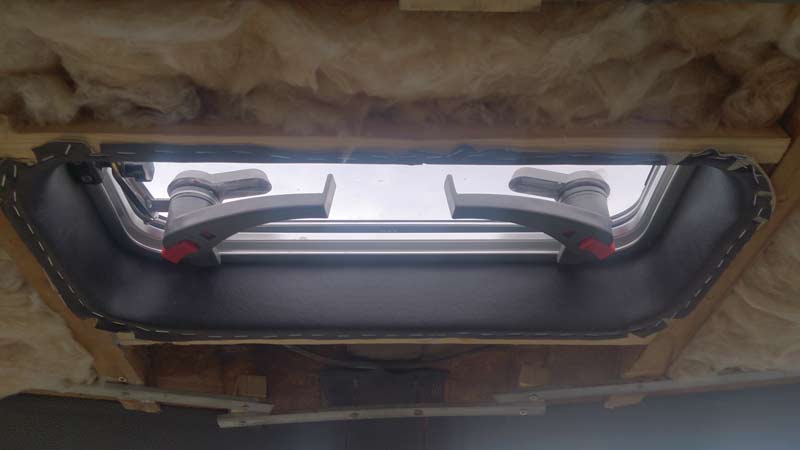

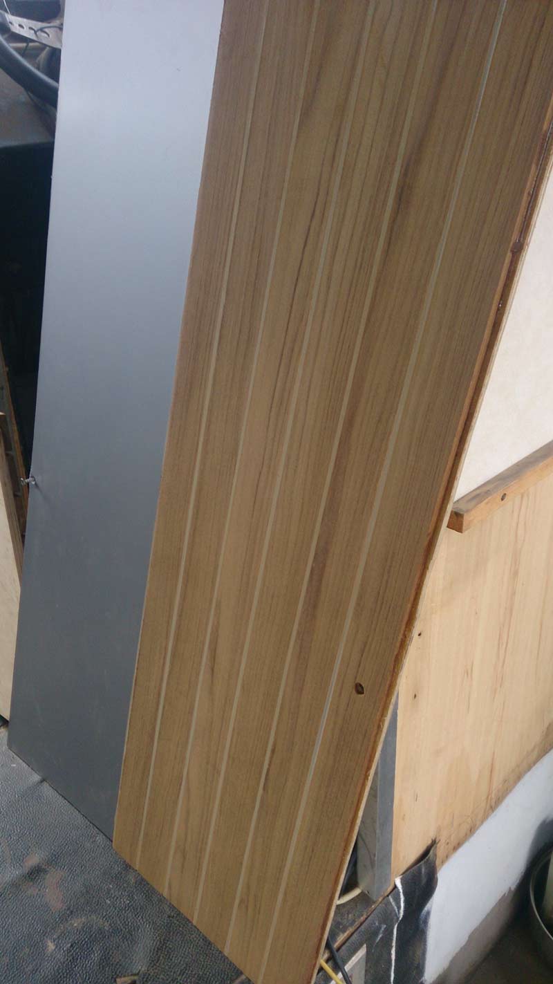

In the interior, sanded one but the last piece of caulked teak panel for the heads, this time the hull lining for the shower area. Looks pretty good, so happy with that. Bolted it in place (wont glue them as I want to be able to check what's going on behind) and it will be sealed all around in due course.

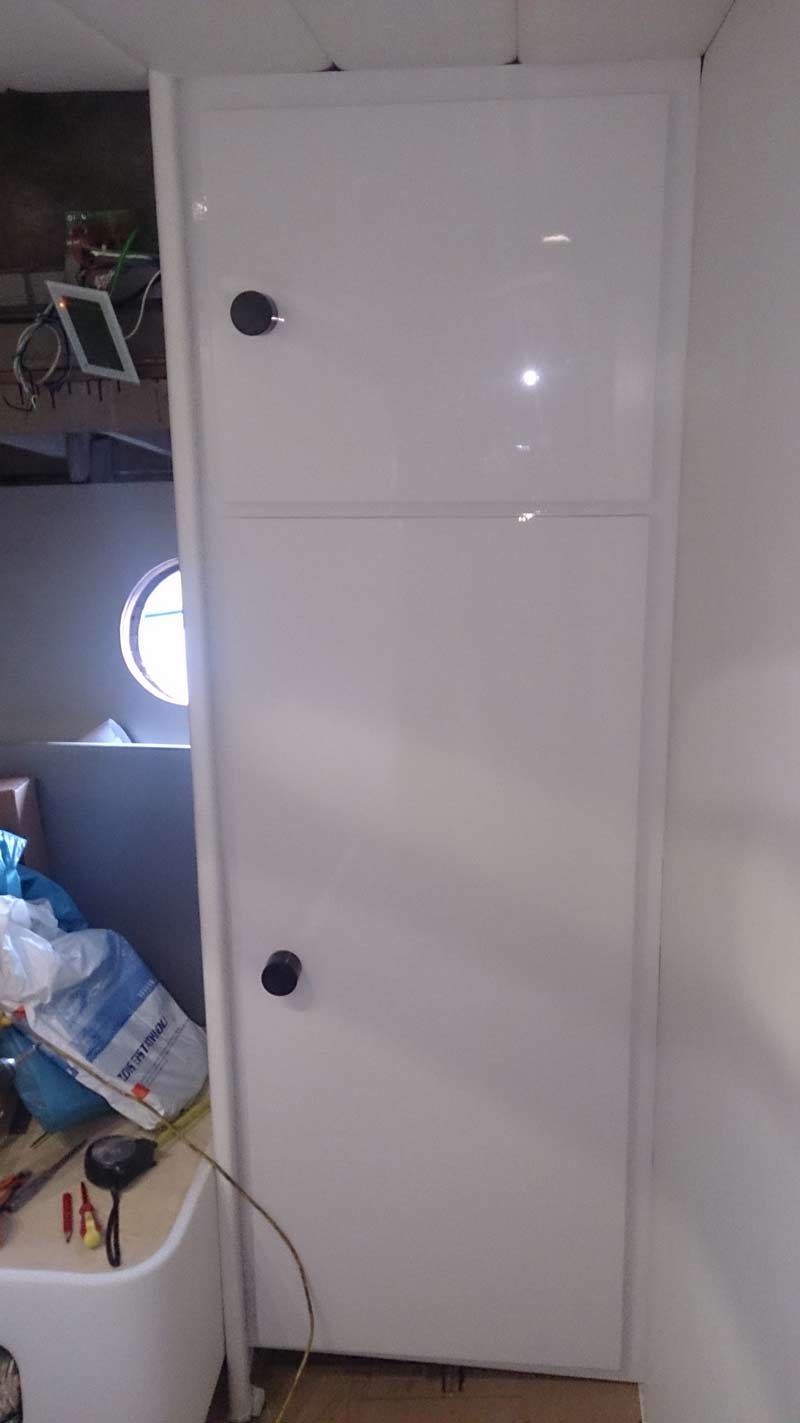

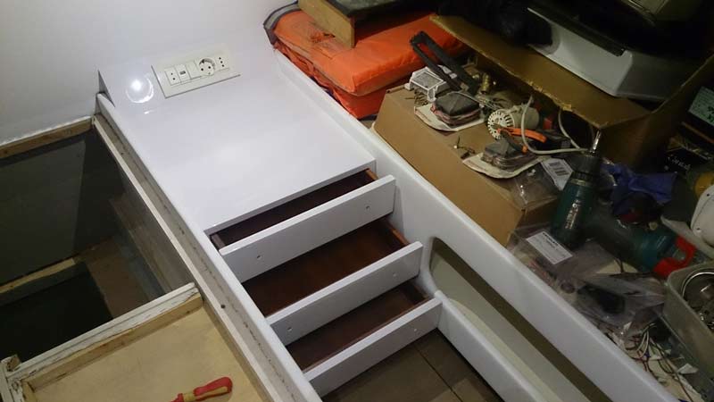

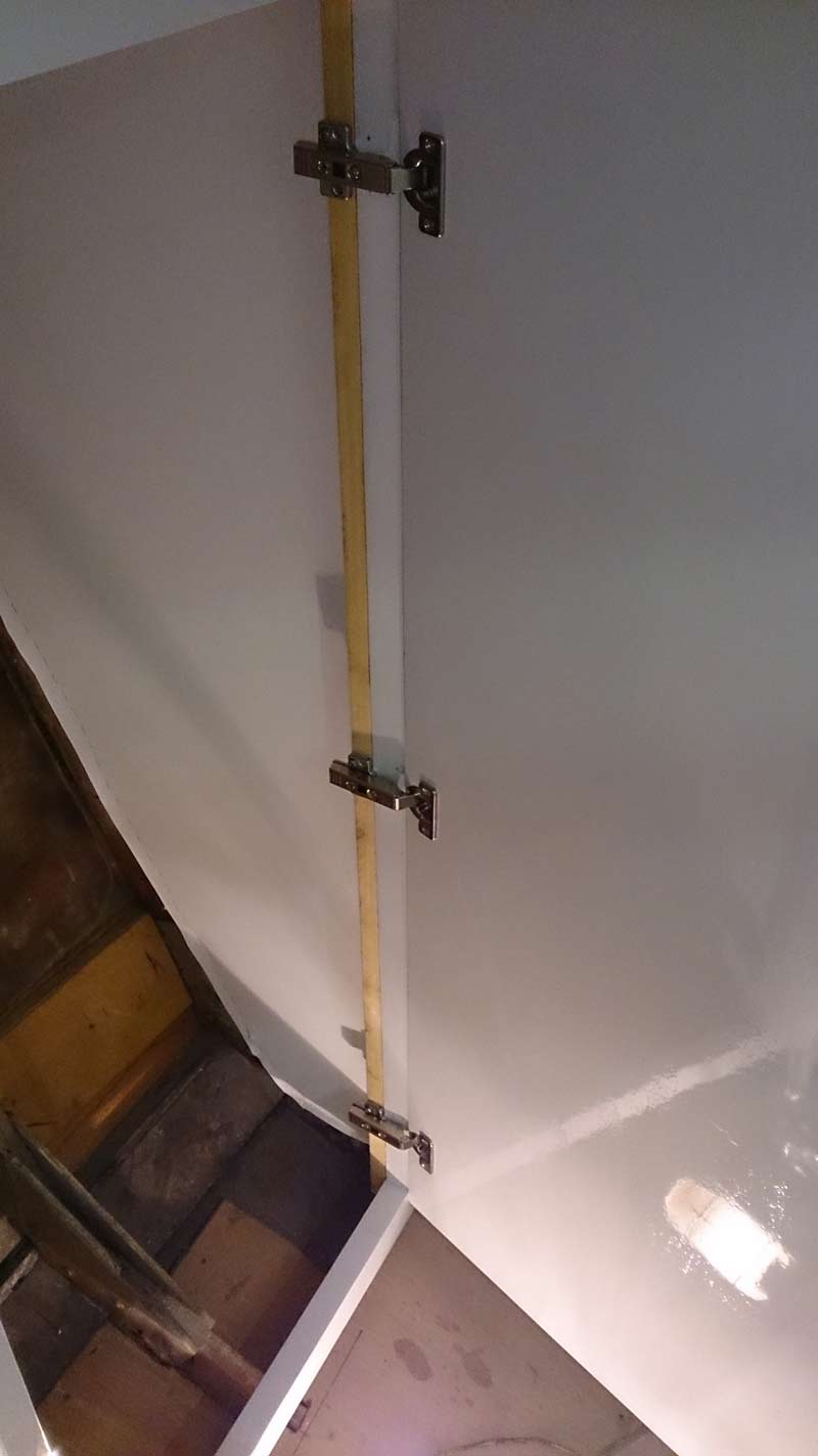

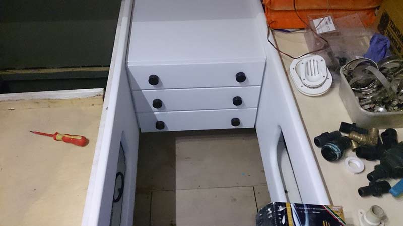

Finally, worked a bit in the port cabin and fitted the three drawer cabinet (is this what you call it?) that George brought in, mounted and fixed the VIMAR sockets/push button and usb charging port, secured it in place and even fitted the handles (some elbow grease to clean muck and old paint out of them!) End result looks v.good:

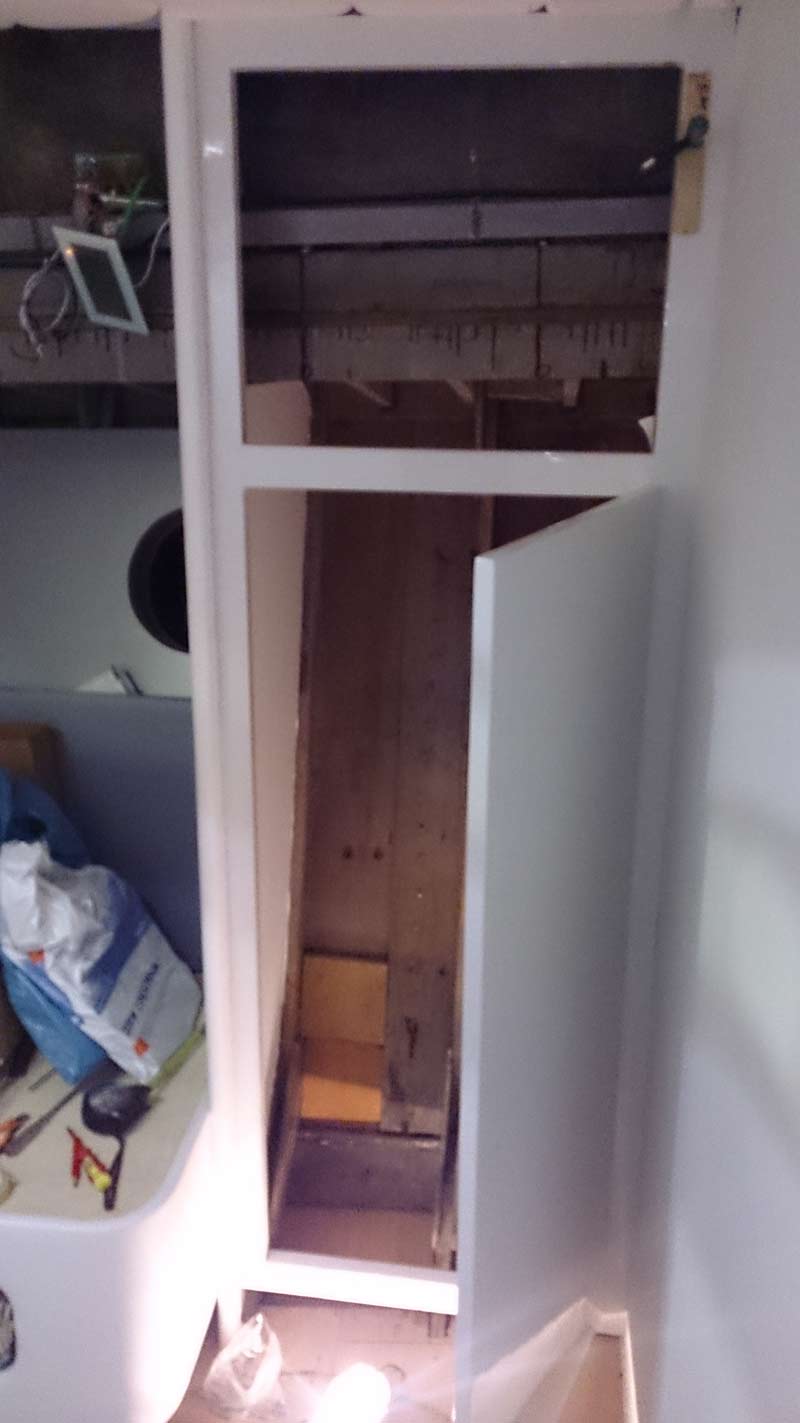

Also fitted the wardrobe frame and doors, but had two issues with it.
First was that the new 1.5euro each BLUM mechanisms I bought (I gathered that even if I change my chrome plated BLUMs every couple of years I'll be dead before I break even with the potentially shocking price of the ss items that I couldn't even source down here...) have their fixing points further away from the door meaning that there wasn't any timber there, easy to fix with a 20x30mm batten epoxied and bolted in place (helps cover some staples and get a clean finish there):
Second (still not sorted due to lack of time) is that either the main door panel or the frame is slightly warped and I cannot get the door to fit properly, but I'm sure I can sort this out in an hour or two.

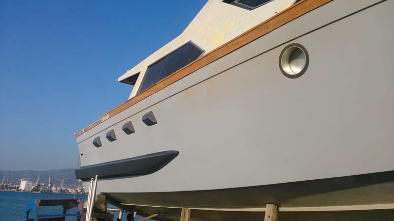

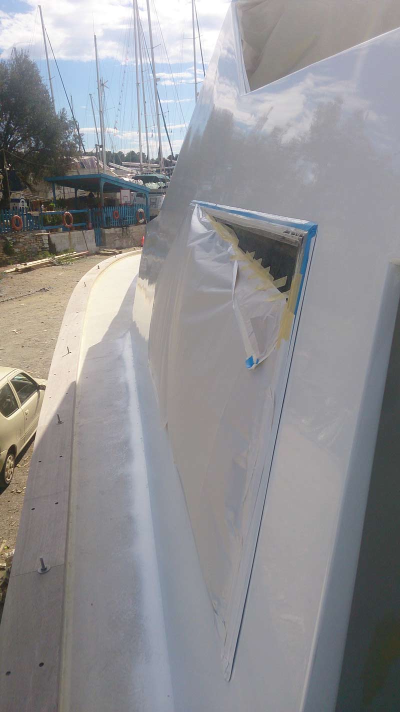

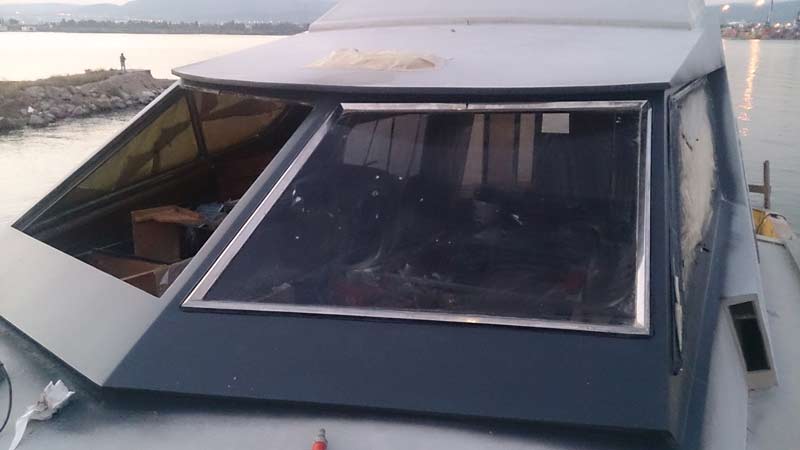

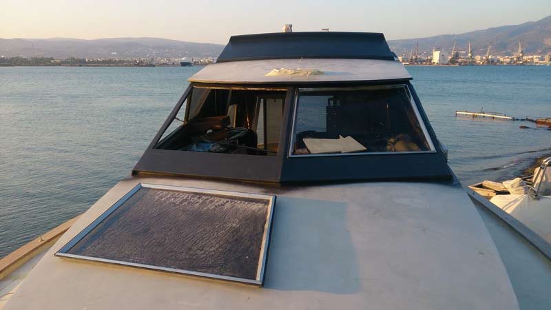

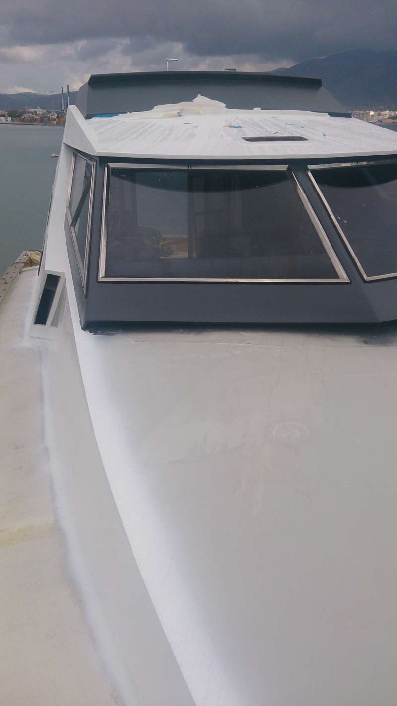

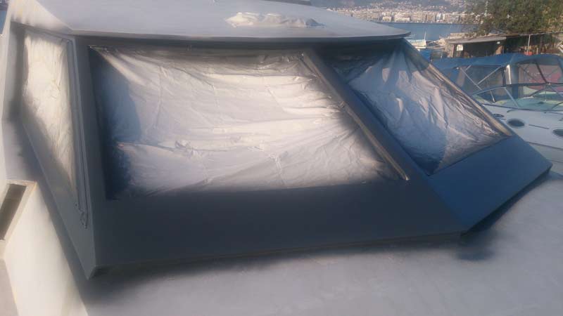

Alekos painted the lower helm window inset in the matt(ish) anthracite used for the engine room vents and portholes' trim. Looks v.good
Took me 2.5h last evening and only managed to fit the port side windscreen. That means cleaning and polishing again the ss frame, and inside clamping frame, carefully clean the rubber seal, put a thin bead of black screen silicone in the slot where the ss frame fits, carefully fit the seal, check it all around, put the screen in place with some help, add another thicker bead of silicone around the vertical sides and bottom of the window frame and push it in place. Then you got to do the very tight and nasty job of bolting the inner frame in place. End result looks perfect, well pleased. This evening I'll do the stbrd side screen.
The two pics above look well unfocused due to the haze of the anthracite paint on the masking, next one gives the real feel. Mind there are some dodgy inaccessible spots on the overhang under the frame towards the sun deck as well as on top on the other overhang of the lower helm roof that was a pain to paint strip and an even worse pain to sand. They are not perfect but one has to stick his head on the windscreen and look up (not visible from the lower helm/galley area) so not bothered.

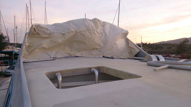

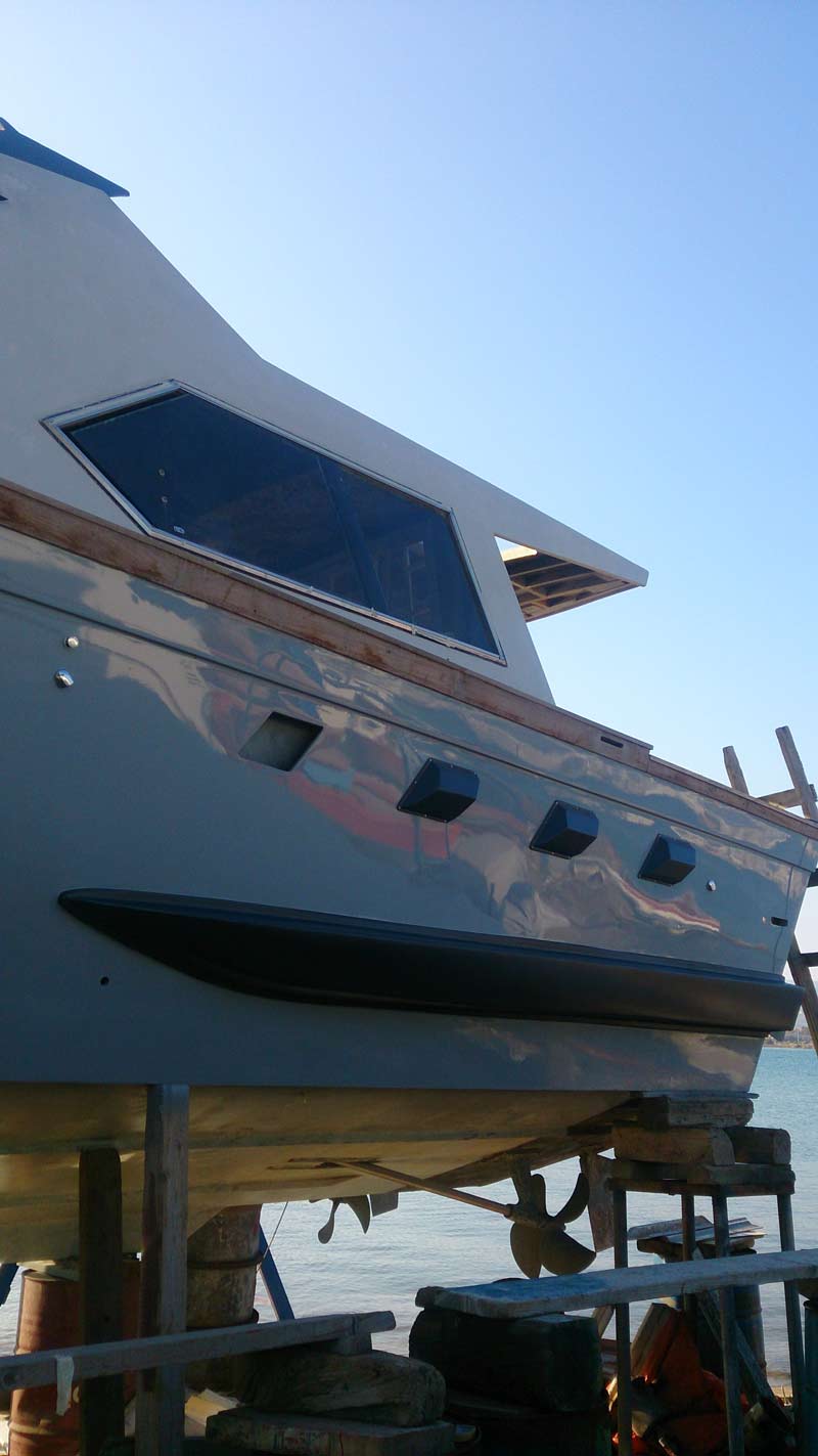

Saturday morning I started preparing the iroco strip all around for the D1 and D2 treatment that will follow (thanks Alf!). Iroco's been in place since the beginning of summer and has taken a lot of UV and heat and is well bleached. Sanded with 40grit to remove some epoxy remains and generally smoothen bits that the screws (now removed) securing the 10mm thick strip had warped the timber. After 3h of hard work I've done half the stbrd side... Not impressed and not looking frwd to the other three hrs to finish off the stbrd side. Mind most of port side has had this treatment soon after fitting and furthermore port side is facing east so gets much less UV exposure than stbrd. Again end result looks v.good.
Today Alekos is going to get the anthracite top coat on the upper helm. Finished preparations in the area after the repairs I did last week involving a thin mat over the troubled area on the bottom of the following pic. In hindside, I should probably have covered EVERYTHING with a thin mat and epoxy before Alekos epoxy filling the lot.

Moving inside, port cabin wardrobe doors in place, got to do the stbrd cabin one as well at the next rainy w/e...

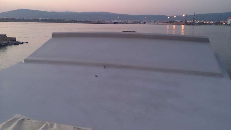

Plan is to built a smallish and very lightweight hardtop over the still to be built main upper helm seating and fit two solar panels plus a radar and a decent vhf antenna there. Have to admit that although I've been toying with this idea for the last three years (got sketches to prove!) I'm not happy with the designs yet, so nothing concrete atm.

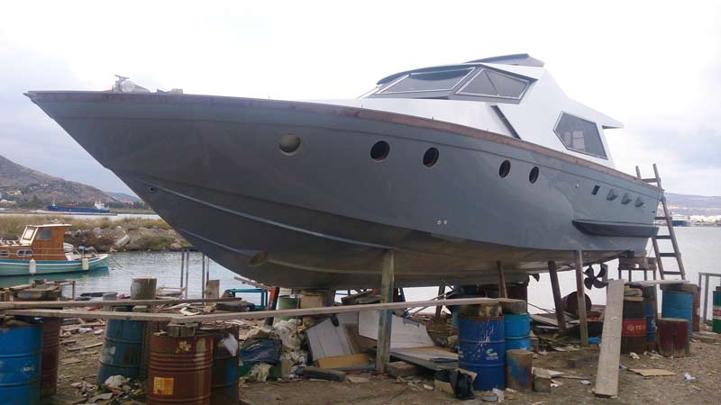

well, since decision was made to keep MiToS on the hard over this winter, I can at least enjoy as much work as I can do whenever I can...

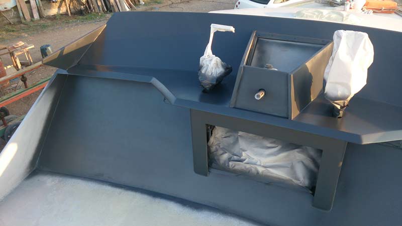

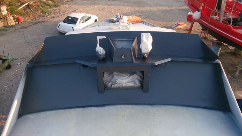

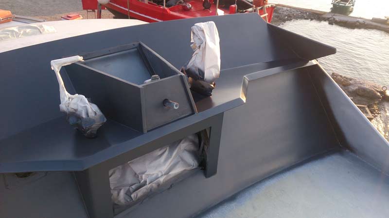

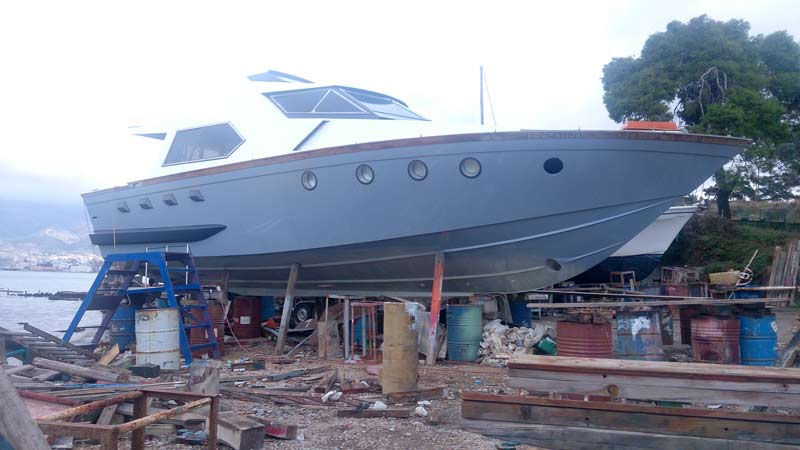

Alekos painted antrhacite black the exhausts and upper helm on Sunday lunchtime. Looks v.good although the darker the colour the more the errors stand out (but that's why it's not glossy but mat ;) ) This area is quite complex, lots of repairs, modifications and oddly shaped bits difficult to sand, prime and prepare. Overall, v. happy and will be happier once I assemble the engine levers and sort out the small "door" of the cabinet which was too wide to fit and needs some work getting it in place and fitting the hinges and lock. If the weather plays ball, will be in my w/e list.

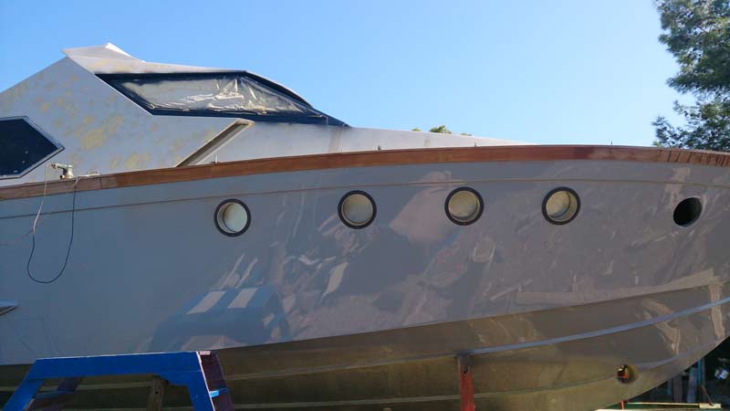

you can spot some dust from sanding the iroko rubbing strake in the next two pics:
and the upper helm:
Not convinced that the footrest area under the dash should be black, may be better white as the sides and lower helm roof. Will think about it again and may take corrective actions.
For sure I'm going to make a canvas (or something) cover soon for the whole dash area with proper "buttons".
Decided against fitting a windshield up there, can always add one at a later date.

Alekos managed to paint the "whites" on Saturday and started raining (just a few light showers) on Sunday.
Lower helm roof was painted twice, first time was late noon and unfortunately lots of humidity in the evening made a mess of the colour (actually lost all it's shine)
Light sanding and recoating cured it. Various pics of the top coat and masking the anthracites follow:
ready for painting:
and the finished article, looks awful in the next pic, slightly better in the pic after:
I'm generally concerned that the white is very bland and looks indifferent (to bad) with the iroko rubbing strake and toerail in place and treated. We shall see...
At deck level things look much better:
following is my 2h worth of work for the w/e... Upholstering the lower helm hatch and fitting the hatch with the right white silicone:
and the finished article from outside:
the triangular upholstery is ready at home, will probably fit it over the w/e if I'm lucky.
The other 2h worth of work on Saturday are managing to fit the door frame on the heads. That's a surprising difficult task, with wedges, hammers, levers, swearing (of course!). Does look good though:
Week is again too busy, arranged with my "neighbour" to lend me a hand (and a small crane...) to hang the passarelle in place. Not a job I can tackle with handpower only.
