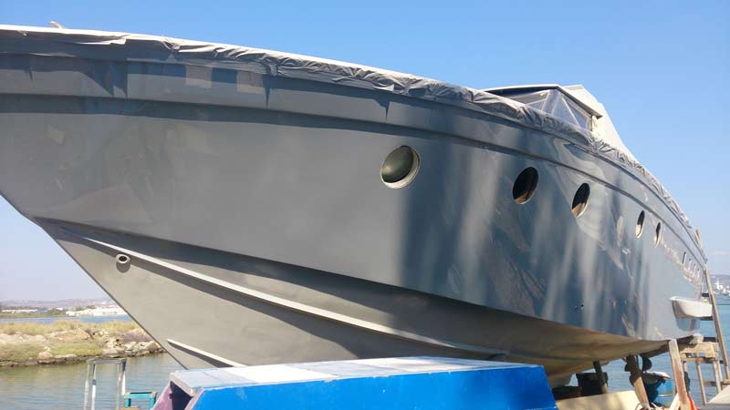

Vas whats the story with the grey topcoat? Any pics?
R., it's complicated :p

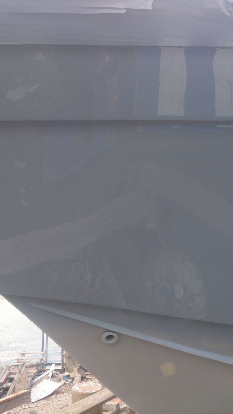

There's going to be grey topcoat all around the hull, and the sundeck and the bit around the salon sliding door.
Salon windows "wall" all the way to the f/b and back to the aft deck overhang and lower helm coachroof is going to be white.
Lower helm recessed window frames, upper helm area, round porthole rings, exhausts and engine room side vents are going to be slightly off black.
Too busy working to photoshop it. Will see it as it comes along and make up my mind on the way (as with everything...)

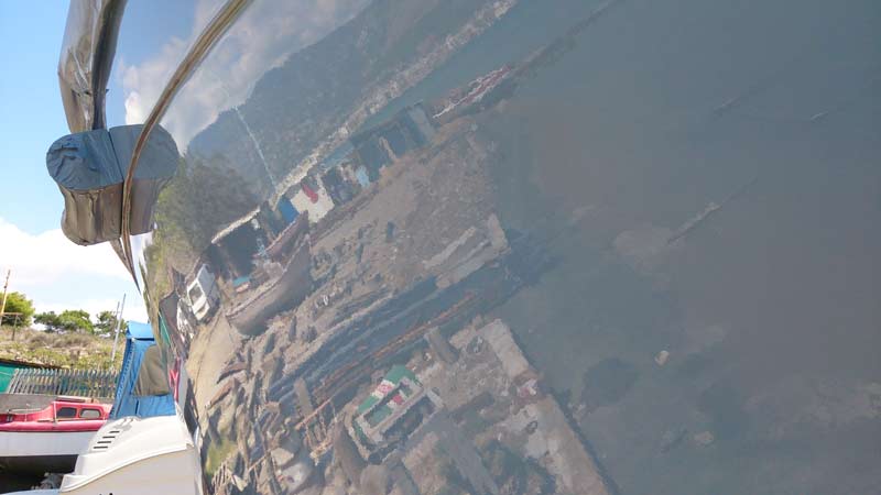

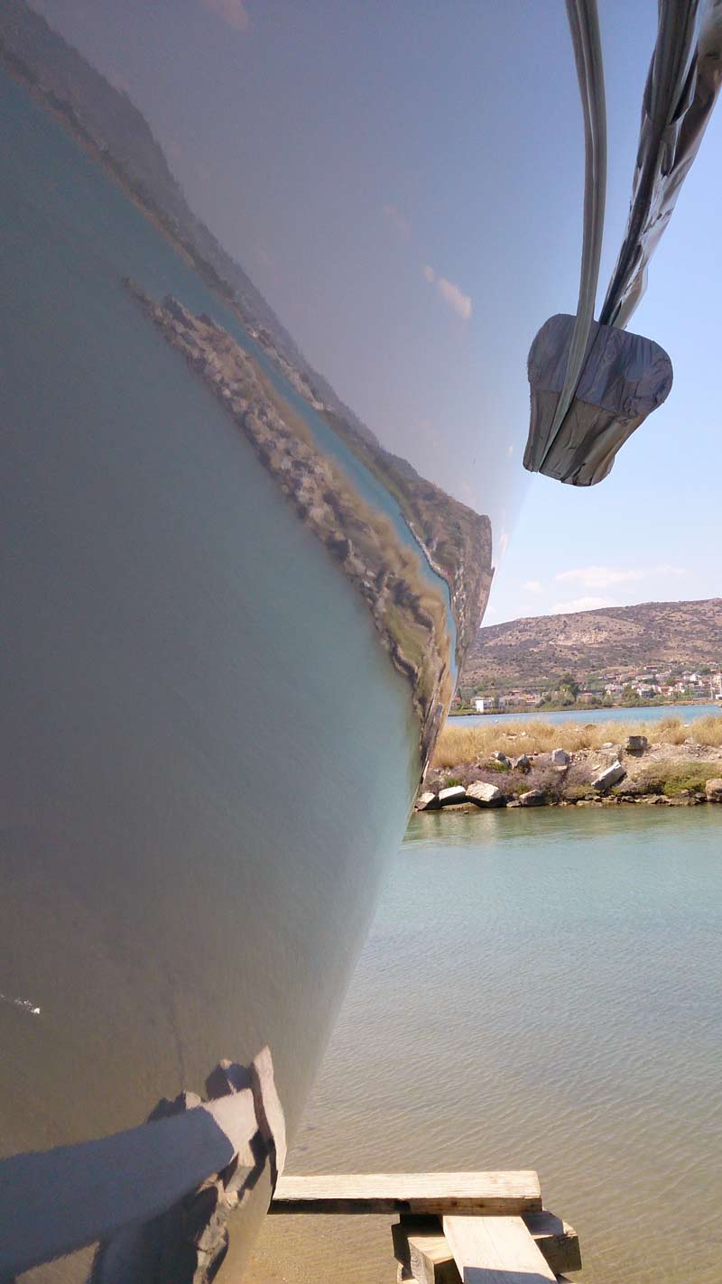

On the news front, we finally do have paint!
only on the transom though and just today. Looks impressively good and creates a mirror like surface. Photos taken couple of hours after spraying but with the sun in the wrong place so no far away pics available. Will post a few tomorrow.
Well impressed, colour is as dark as I'd like it, will look different/better in the water (IMHO)

That is some shine without even buffing!! Remote door opening with parraselle is very cool. How about a small motor to slide the door open too:cool:
Can't wait to see more and thanks so much for sharing your journey with us.
Hi Vas,
As ever, thanks for the update. The paint finish looks great, it probably didn't look that good when it was new!
I cannot wait to see it when some of the detailing is done, you must be very proud of your efforts now the end is in sight.
Mike.
Wow! That is mirror finish VAS, well done.
I didn't think you were expecting that from your comments about paint prep and re-paint next year etc.
That looks totally fab. I didn't think that quality of effect could be achieved on a refurbished wooden boat. You must be pleased. I would be.
I think you're pushing it with the motor opening the doors... Unfortunately looks like the electric hook locks wont fit in the allu frame of the door, so for the time being that's a non-starter :(
Wow! That's some finish. Can't wait to see the rest and hope mine is even half that shiny when I eventually get there! :D
I can organize for Alekos to come and paint yours as well ;)
He's already painted a 60ft custom mobo in Istanbul last year.
So impressed with the paint I forgot to ask about Alekos's daughter. Hope she is on the road to recovery

true, looks too good that tbh I'm afraid of touching and working on skinfittings et al. Was planning to bring the passerelle and fit it by creating a small scaffold and lifting it there, but I chickened out. Will call a friend with a small van with a crane to hold it steady in place for me to bolt it through and measure/fix the ram. Maybe during the w/e.
quite right,
I wasn't expected such a result, quite shocked tbh, so re paint next year is out of the question. Probably repaint in 4-5yrs once everything settles and I rethink the colouring scheme. Even then probably wont paint everything.

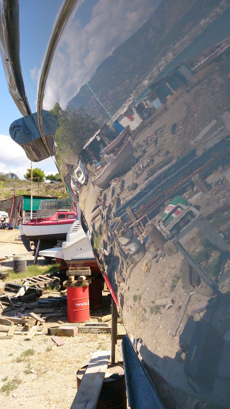

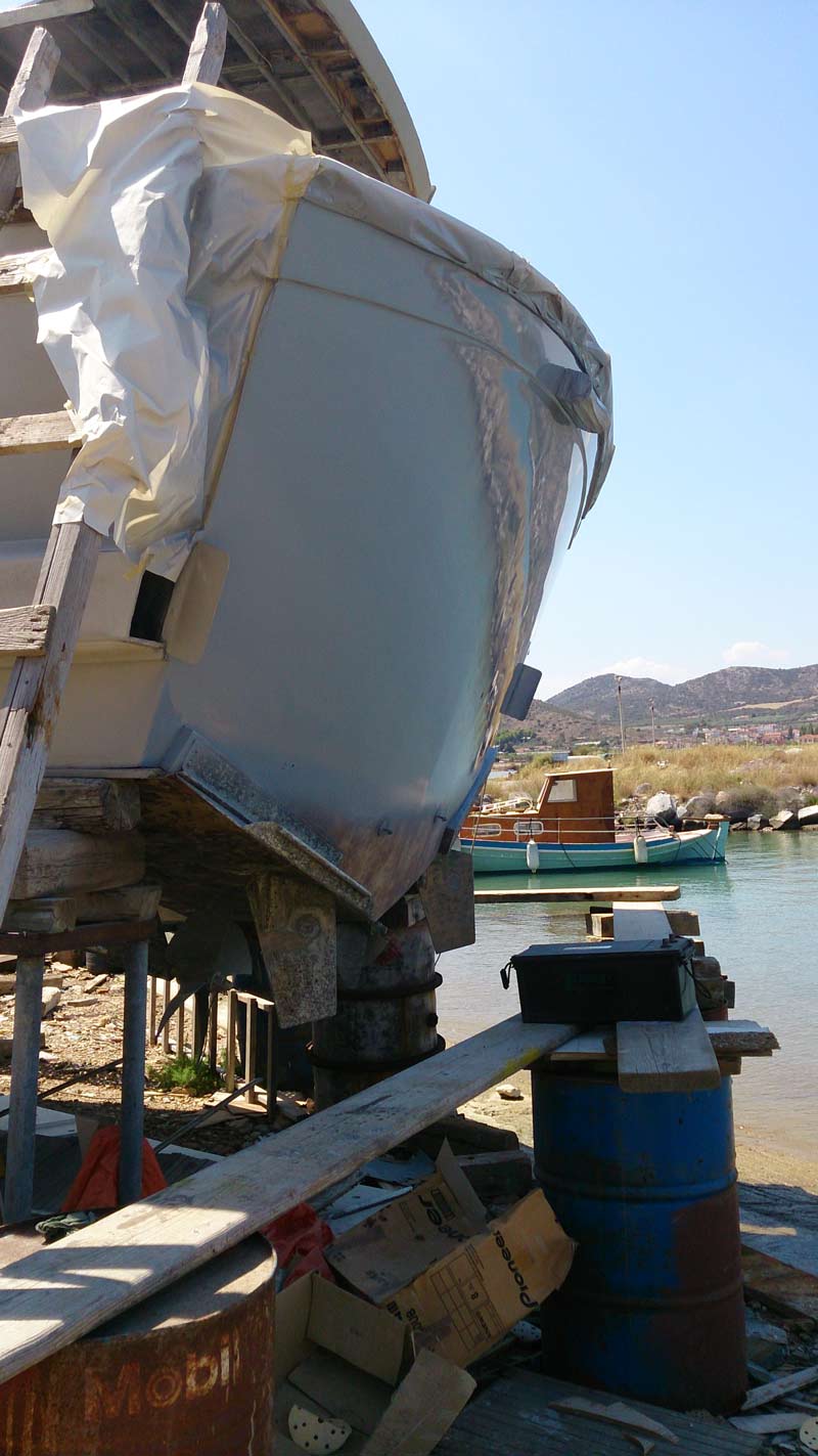

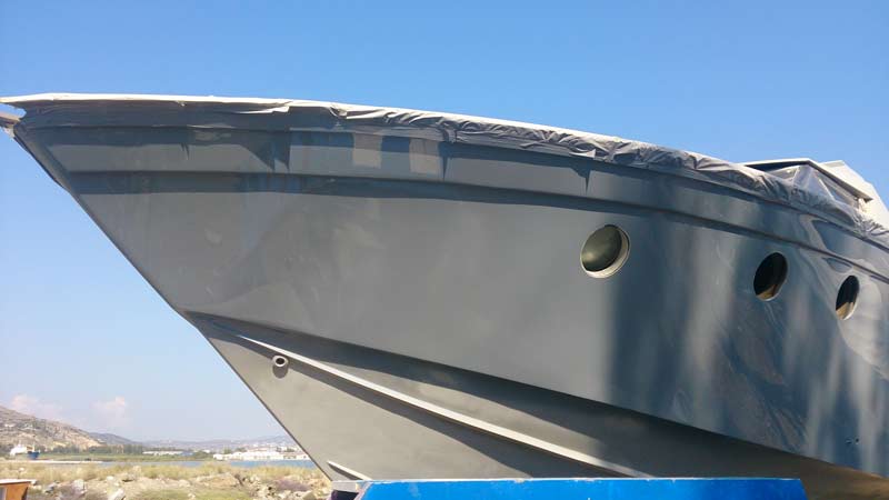

So, after a full week with dodgy weather, some showers, a couple of thunderstorms and a few days that the weather wasn't quite sure of what to do, we are back in summer mode with temps up to 30-32C.
Alekos finished off and painted the port side yesterday.
detail:
the whole thing (almost):
result is again impressive and Alekos will be painting the stbrd side in a few hours.
Bow height down to w/l was too much for him, so opted for straight painting of the hull above the top chine and will mask and paint all the bow from w/l to top chine on a separate go (probably Sat morning)
I've done various bits and bobs (amazing how many hours small things take...) lazarette is almost ready, clean bottom painted hull sides and transom to be painted so that I can start refitting h/w (mainly lights, steering sensor for the a/p, bilge pump and the bulky passarelle pump/solenoids assembly.

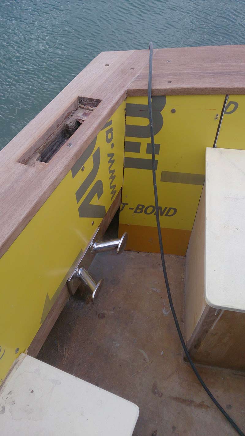

Worth posting a couple of pics of the finished aft deck alloy sandwich skin.
BTW, fitted the first 2 cleats! (even such a simple job took me 4-5h!)

Vas that's quite an amazing paint job!
Those cleats look great, but just one question. Am I right in thinking that the holes in the capping above are for your pop up cleats? If so, why have both so close together?
Vas that is amazing. She is going to look pretty stunning. Keep posting the pictures when you get time
I'm so pleased you are going to paint the area from chine down to waterline. For a few moments, when I saw the picture, I thought you might had decided to take the antifoul paint up to the chine at the bow. I'm so glad you're not doing that! :D :D (Not that I ever seriously doubted you :))
