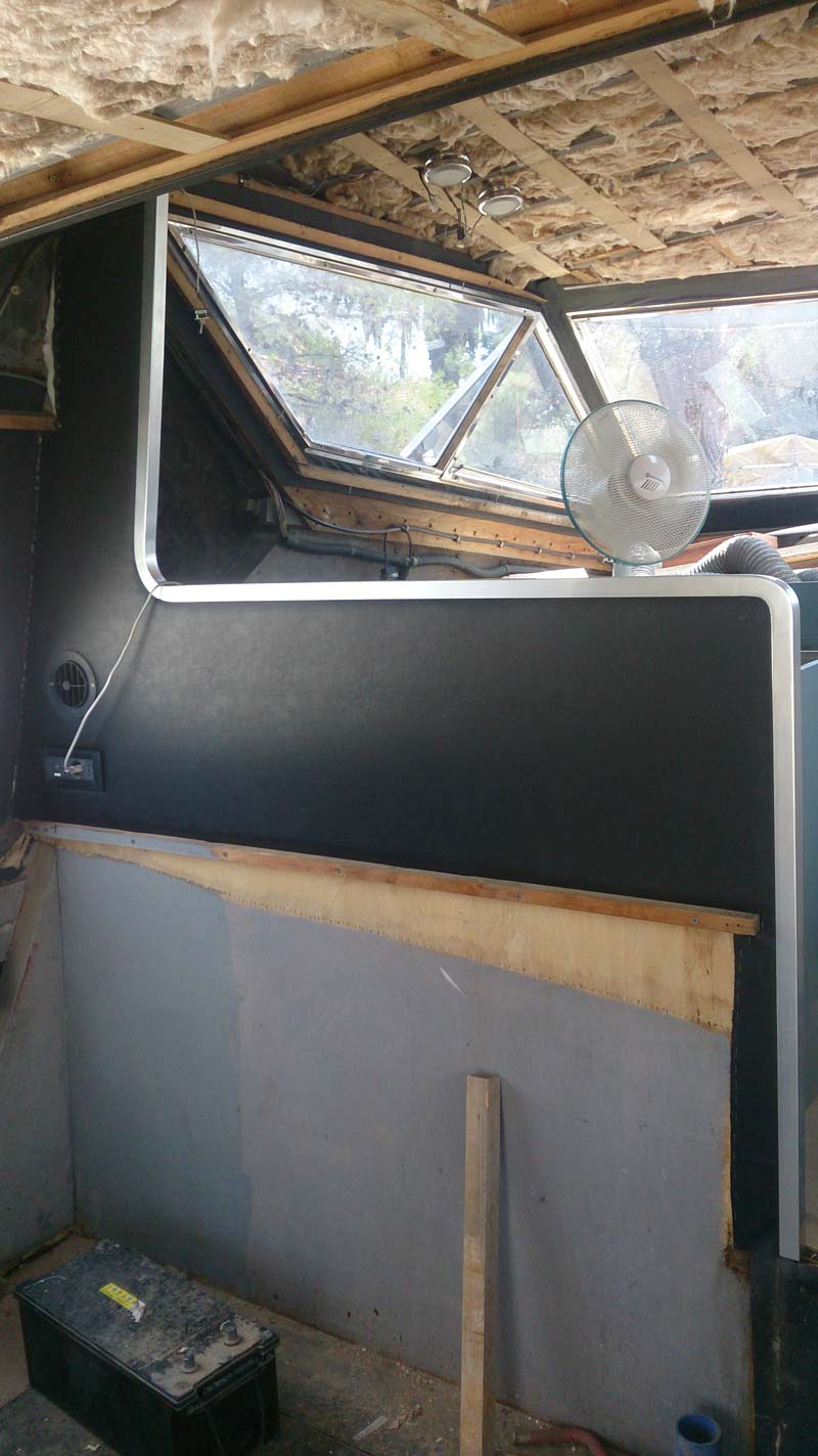

lower helm hatch is this one (in case someone likes/wants one) Alloy, v.well made in Istanbul. under 200euro.
Had to built the edging down to the lining level so that I can upholster both the edge and the lining again after cutting a hole.

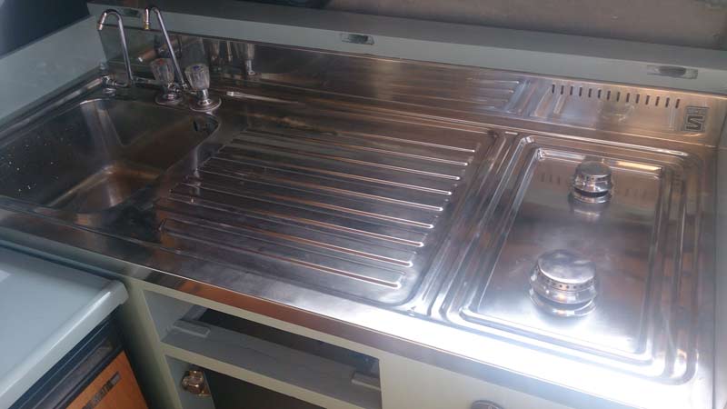

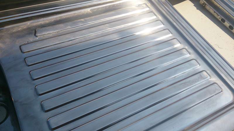

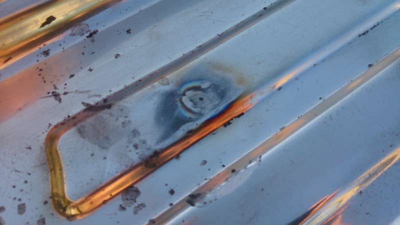

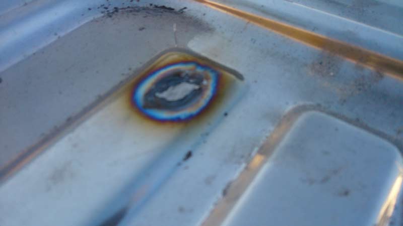

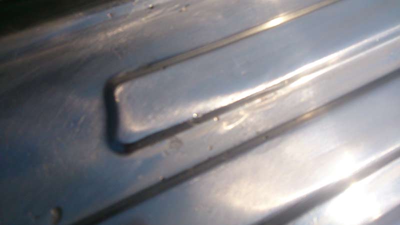

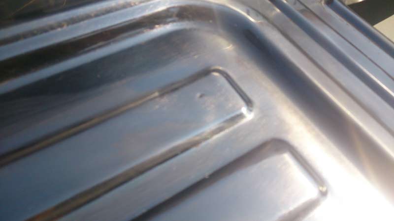

Remember the integrated sink and hob thing in very heavy gauge SS had four nice holes drilled so that PO could secure (unsuccessfully I may add) the dish drier. What the holes were successful though was in letting water down the cabinet and making a mess of it. George had to rebuilt half of it!
So got the guy who fixed the stanchion bases to weld these four holes and took me the best part of a morning to grind the welds, sand and finally polish them down to almost invisible. Actually 2 are impossible to spot, one is difficult and one is rather easy as there's not enough weld and there's tiny recess there.
Few pics to show the before and after at various stages of polish.
Hole in place:
After the welds:
Lightly sanded weld. Note some issues with electrolysis around the area:
Details of the repaired areas:
and the overall view of the assembly:

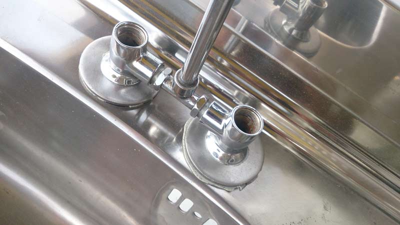

I carefully cleaned and polished the taps, renewed the rubber seal/washer in them and got them in place with a bit of sink bedding silicone I had around.

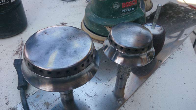

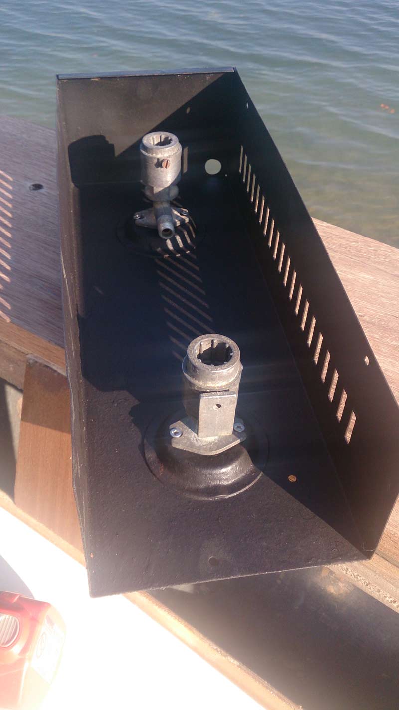

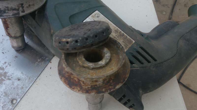

I also fully dismantled and sanded/cleaned/primed/painted the hob tray.
Cleaned and polished all the bits but I overdid the hob cover and managed to remove some of the chrome plating. During the winter I'll get a new load of bits for chrome plating to the guy in Athens and be done with.
Now all back in place wired and plumbed. No drain as Alekos is still working there and I cannot fit the skinfitting yet.

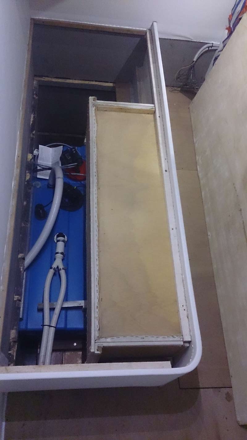

Fridge was working fine when standalone in the salon, now stuffed in place with a cabinet all around it, is simply pathetic!
Due to the placement of the evaporator and PC fan on the top at the back, I'm thinking of cutting a larger hole on the worktop and built a recess with the wall plugs and a grill for the hot air to exit. ATM I've simply moved the furniture it fits in a bit so that there's a gap of 50-60mm all around, but I have to say that I'm still not impressed at all. Will investigate further as I bent a couple of pipes a bit in order to shift the evaporator and fan 30mm towards the door and I'm afraid I'm restricting Freon movement.

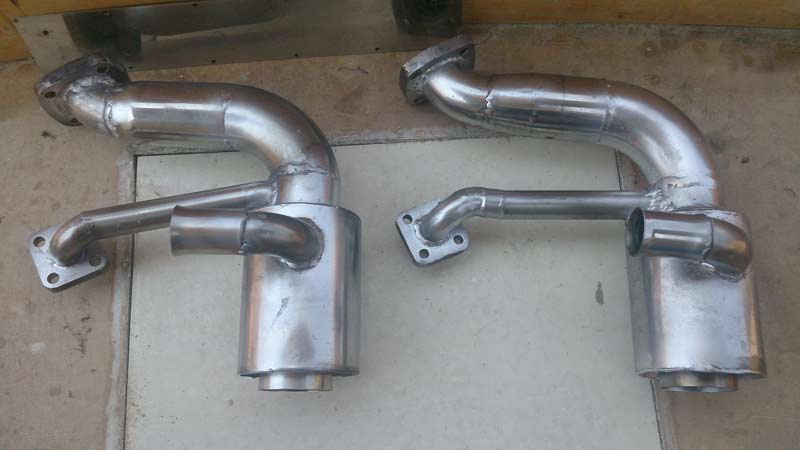

exhaust risers arrived, not spent any time down there as yet so they're just soaking up the sun on the aft deck...

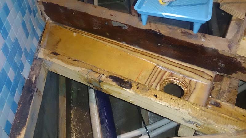

Decided to fit and sort out the heads flooring and finish off the tiling and furniture in there. One of the issues I had was forming the "collector"/drain for the elevated shower floor

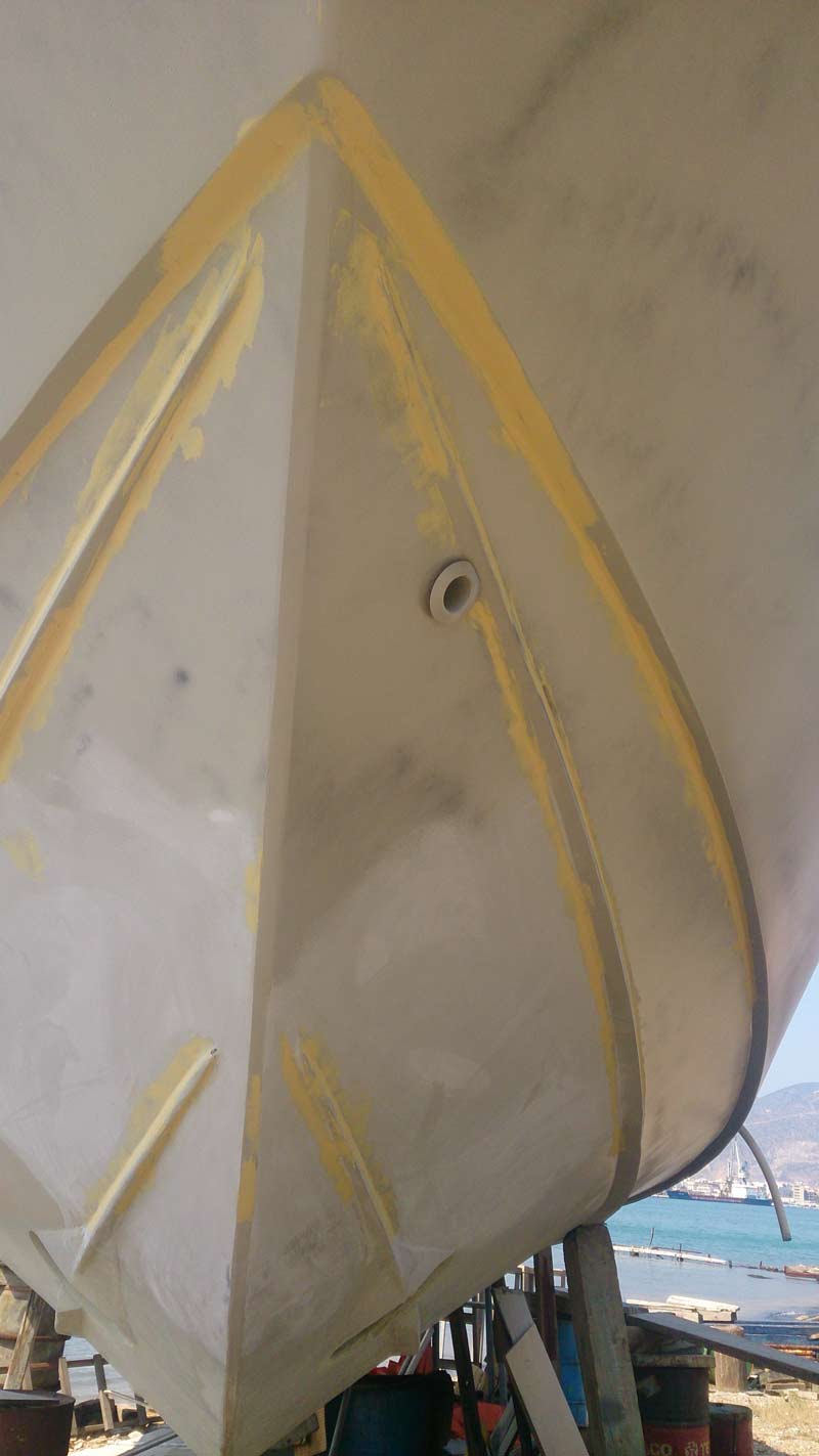

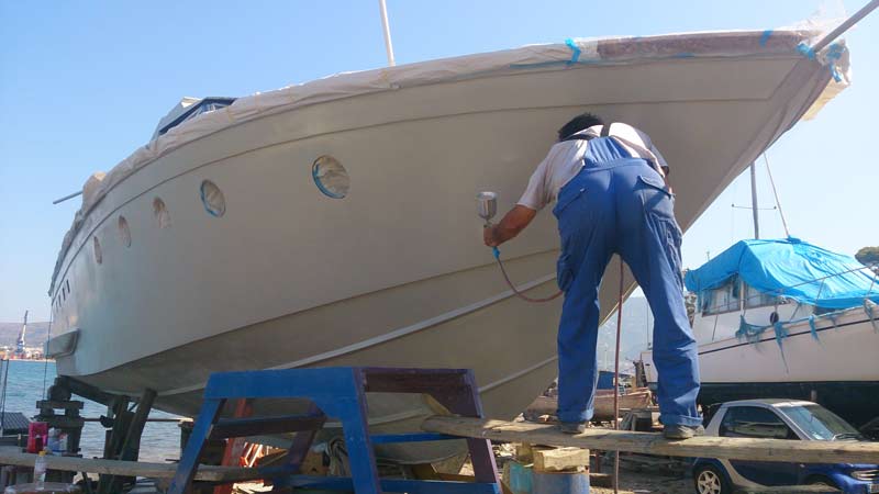

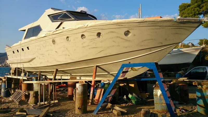

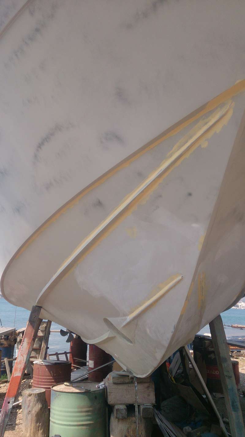

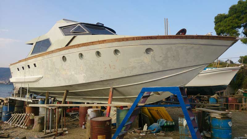

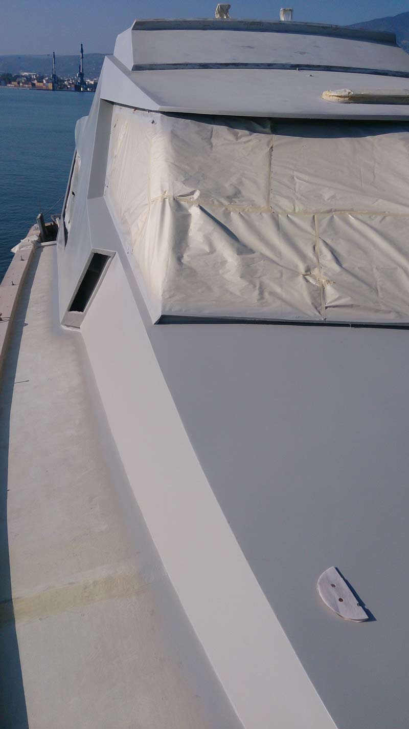

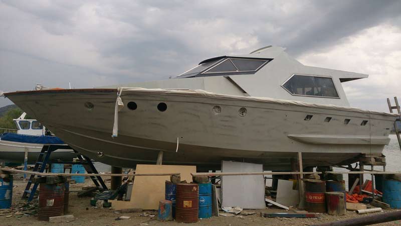

On the painting front, happy to report that all hull and superstructure are currently filled, sanded, and primer applied with spray gun.
Over the next week Alekos will be sanding, touching up with filler small details and hopefully before the end of next week hull will be sprayed RAL7001 grey as planned:
stbrd side sanded ready for priming:
Alekos working:
primed:
port side primed (had a bit of rain after that (was last w/e)
Touching up the chines:
and superstructure:

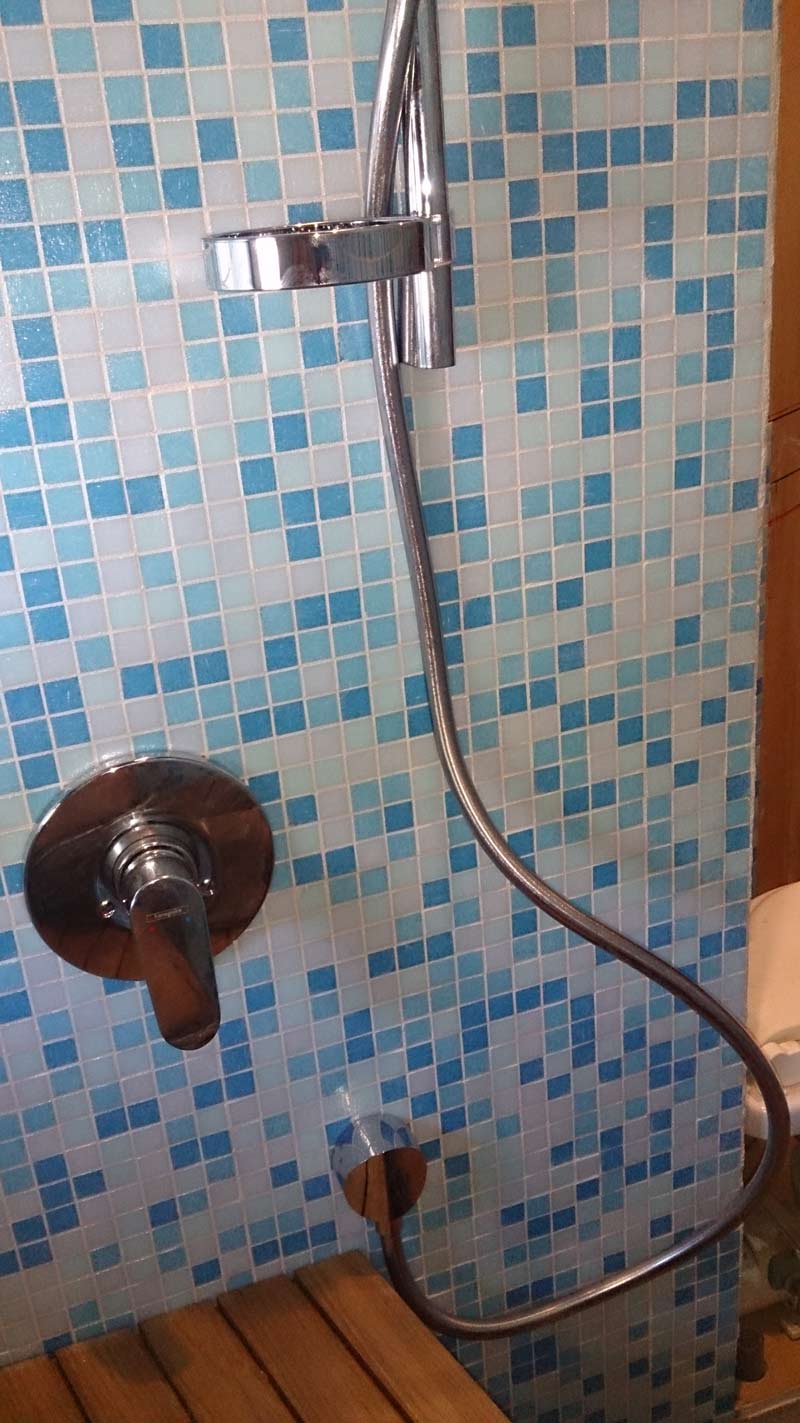

Most of my time was spent in the heads sorting them out, finishing off tiling with these mosaic tiles (20x20mm) and grouting. Technology has progressed since the time I did some mosaic tiling 15yrs ago, and the new superflex epoxy glues and grouts are a treat to work with and the end result is pretty professional. Well pleased with it.

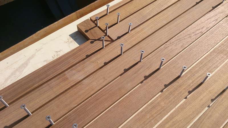

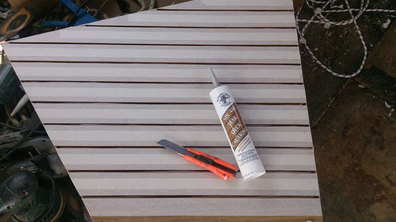

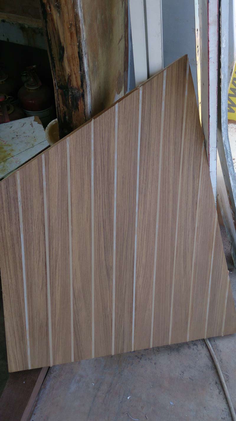

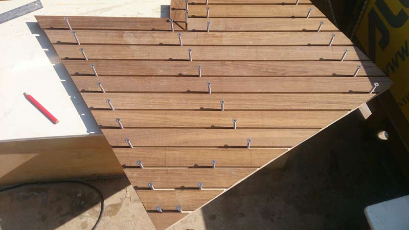

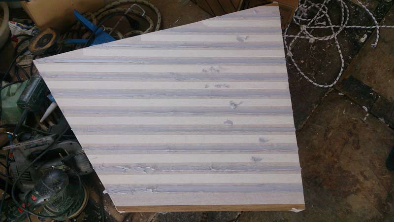

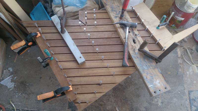

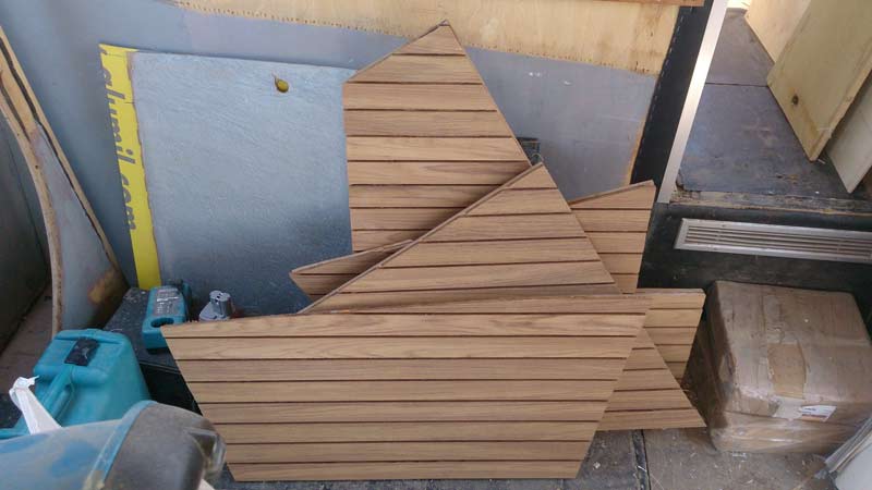

As per the other thread on teak decking, I got hold of the real thing (as per JFMs suggestions) and epoxied teak on all 5 panels I wanted. Currently have caulked only two of them, need some cooler weather to do the rest. This is my test bed for the teakdecking of the rest of MiToS next spring, so wanted to find what works and whatnot. Seems that I got things ok, although on the larger areas I'll choose smaller seams (me thinks 6mm is a bit too much - and takes LOADS of caulking!#
I used 6mm gaps mainly because I only had 6X50 screws lying around in large quantities to use as support/spacers. I did cut the teak in straight orthogonal strips no groves to be used as spacers.
So the decking first:
epoxy priming and then gluing. It was a three stage process, first test fit, get the screws in place to hold them all up, then remove, prime and glue clamping in place.
all ready epoxied and waiting for caulking
left it for 4 days to cure and removed all masking tape
and sanded it with 80grit as suggested but I only did a light sanding and will have to go for a second more serious round once everything is finished #grout and all bits of dirt were down there whilst I was working on the bulkheads.

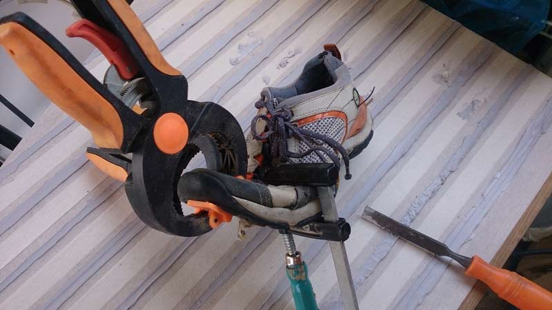

since I had the sole of one of my working pair of timberlands failing, I used the caulking to glue the sole back to the shoe. Note the design conscious selection of clamps properly matching the orangy strip in the shoe :p (not to mention the matching chisel!)
Needless to say they work perfectly! Well impressed with TDS SIS440.
Main heads look like that now:

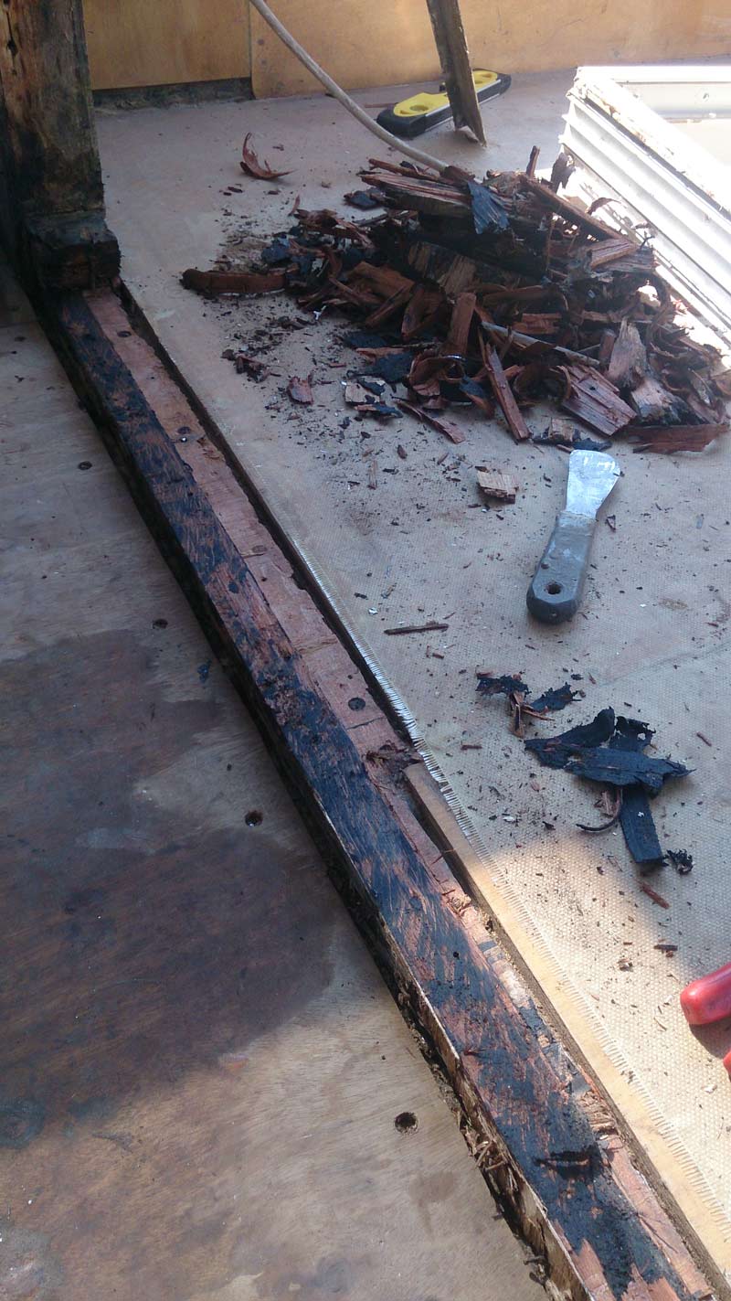

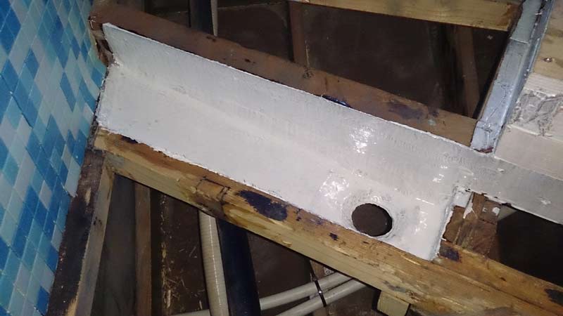

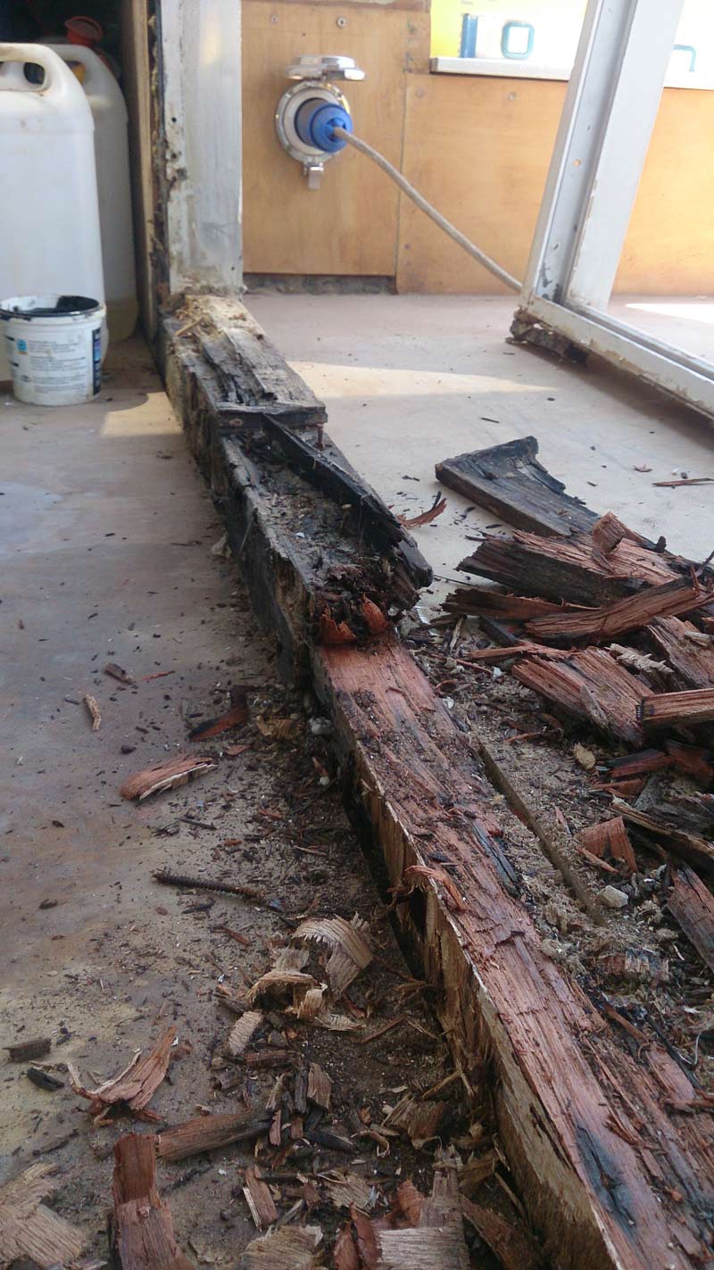

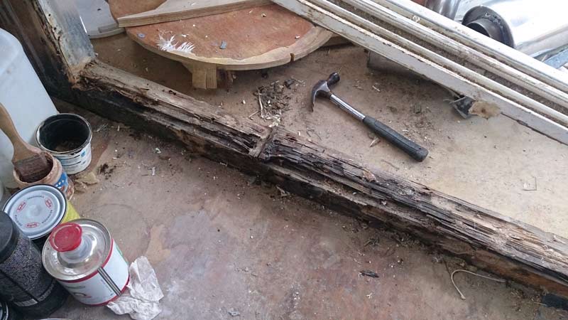

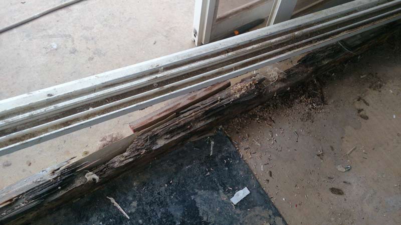

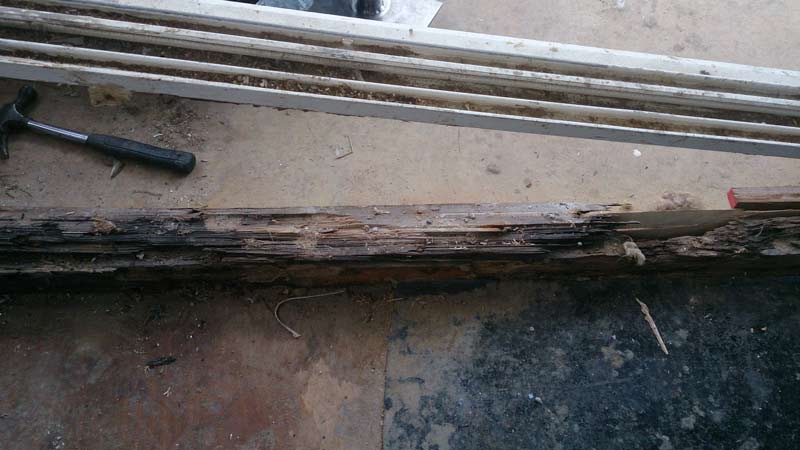

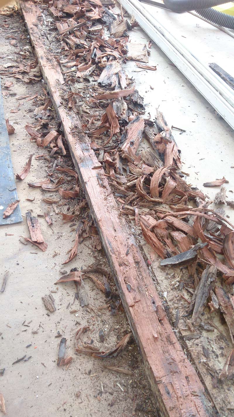

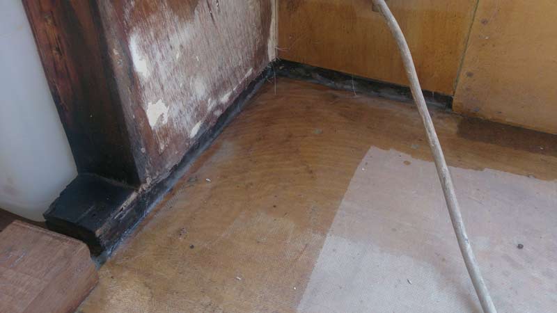

One last messy job that I was postponing like for ever :rolleyes: was the salon sliding doors. When rebuilding the salon floor and the aft deck I noticed that the main iroko beam that the frame sits on was rotted in the middle of the opening. So last week decided to have a go at removing the whole lot. Took me the best part of an afternoon and a few kilos of sweat to remove the second fixed glazing, undo all the screws and following a lot of head scratching and swearing to get the frame out. In retrospect, doorframe was assembled as a whole (not square, but slanted on the side pillars) and fitted in place with a thin bead of silicone, whereas I thought it was done in steps and was finding difficult to get the first one out. OK, I wont discuss how it was secured now, but took me another morning to clear off all the mess and assess the situation. I'm very much tempted to get my window guy to do a new set of doors again, two fixed on the side and two sliding in the middle and get them in the right grey RAL ;) to match the rest of the hull. Current one may be just about recoverable but frame has a couple of coats of white paint (brushed on!) and massive amounts of silicone. Any easy way to remove silicone btw???
Following pics show the mess produced when chiseling the whole frame out which apparently wasn't as bad as it looked originally. New piece of iroco cut from the leftovers of the toe-rail capping, and matched the curvature of the aft deck. All epoxied in place unfortunately iroco piece was around 150mm short of the 2500mm length of the opening. However on the badly rotted port side (where George had reconstructed the whole frame and skin of the pillar) I ended up removing some of the timber on the outer column piece and rebuilt the whole construction in steps (should finish tomorrow but not got any good pics now to post)
Stbrd to port the support beam for the door frame
next pic you can see that there's a top slice of ply (completely disintegrating!) on top of the iroko. I guess it was to get the flat surface on which the door frame sits without a hell of sanding iroko...
a fair amount of manual work to get all the old iroko beam out (in chips...)
cleaned up all the mess. Note (not quite easy though) that the piece removed belonged to the superstructure which I assume was built separately and then glued/bolted onto the hull when ready. So there was another beam (more substantial) underneath
new beam in place following a layer of thicken epoxy and mat to bed them all in and link to the aft deck:
stbrd detail to the side wall:
