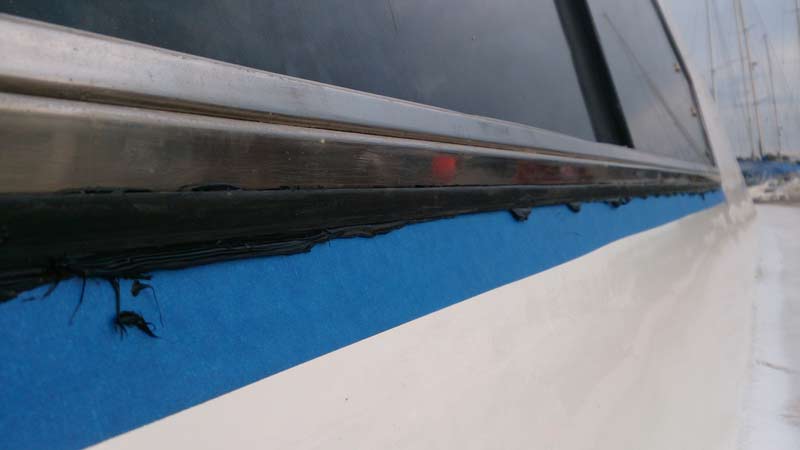

Managed to steal an evening on Sunday to remove the seal on the port salon window, clean it properly, and use the proper windscreen mastic to reseat it and waterproof the lot. Problem is that cleaning the bleeding seal inside out, removing traces of paint that went through the masking tape at places took me the best part of 3h. By that time I had the window frame literally on the air, BUT it was dark. So got some lights out, the mastic gun loaded and started working. I overdid the squeezing of mastic on the front and bottom side of the seal and when eventually screwed it in and mastic started squeezing out it was all over the place (i.e. between 2-6mm outside the seal) By that time I decided to sort out the sticking of the sliding mechanism on this port window (perfect timing!) took me another half hour and undoing a dozen M5 (iirc) bolts and eventually fixed it.
At that point it was 7:30pm, my daughter was having her first big party with 20odd kids at home and I'd promised i'd be there by 6...
So packed up and decided to let the mastic to dry a bit and return the next day to sort it out.
You can imagine the rest of the story... Monday was plain hell, Tue managed to go there for an hour to realize the extend of the mastic that was squashed out of the seam and tried to remove some of it. Mastic too fcking strong taking parts of the top coat with it :(
Not too great a problem as I can use some masking tape to create a unified stretch where I can apply some mastic at 2-3mm thick and smooth/fade it out.
Option two is masking it again and Alekos getting another bit of topcoat on that strip (but you probably need an airbrush for it!)
Anyway, p1ssed off as it really wasn't necessary and was an elementary mistake!
When I get to do the stbrd side, I'll surely apply some blue masking tape all around the seal BEFORE removing the screen and seal so that any excess mastic will stick on this tape and can later by simply removed with no harm. That's what I did when I replaced the windscreens over the final topcoat.

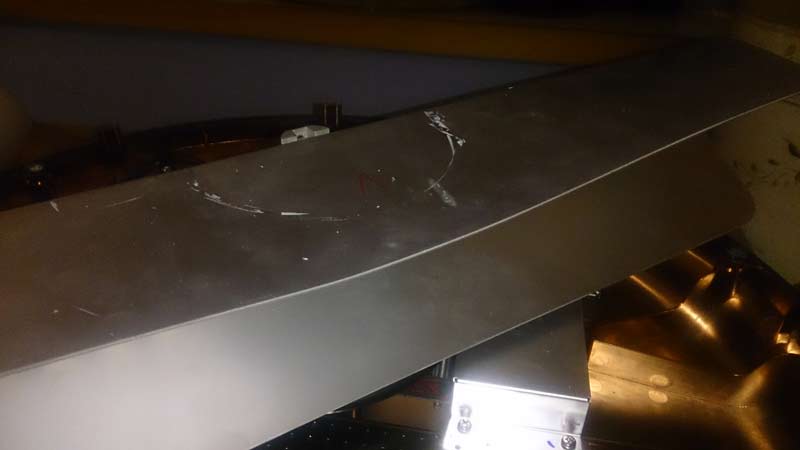

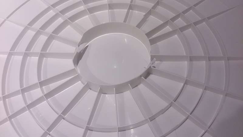

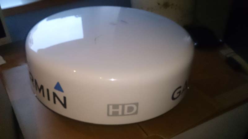

On the plus side, I bid for a s/h 24HD Garmin radome (spares or repair) last week and got it for 211quid +40something delivery. Picked it up (hardly fitted the wife's seicento!) in it's proper Garmin box with all the support, seals etc. Opened it up to find a brand new untouched item, mounting bolts never used, shiny BUT with a cracked cover on top. Crack is in a cross pattern, one side is around 200mm other approx. 50. Undid the cover, and noticed that the "deflector" U shaped thing that spins around is bent where the lid was squashed on it and the one of the two bolts securing it on it's axle popped out. Axle, belt, pulleys all look right and spin fine.

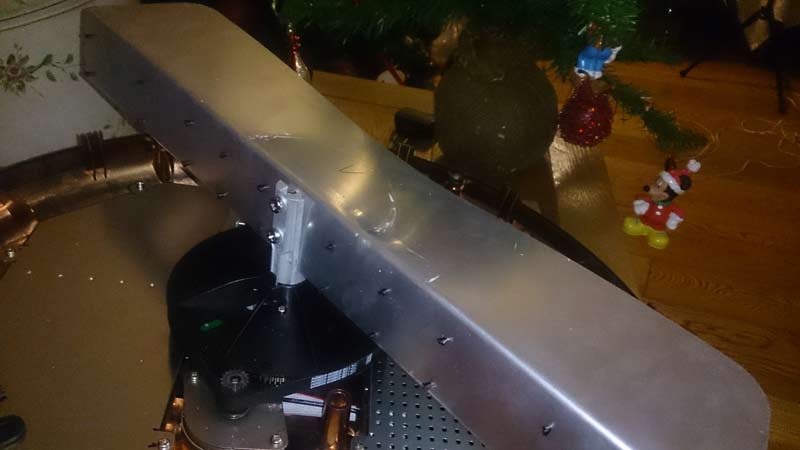

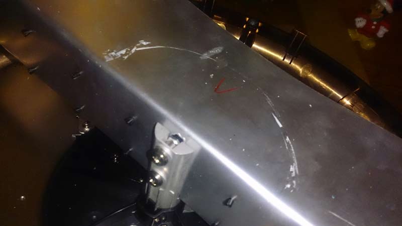

Wonder how easy it is to remove the spinning thing, to strengthen it and then hook it up to my GPSMAP3006 and see if it works. Slightly worried as I don't understand/haven't ever studied how radars are implemented and therefore cannot assess how vital/clear/impedance sensitive are the two (if I can see properly) thin wires going up to the spinning bit. In other words, can I undo them safely and do my job? If everything is fine (which I assume it is the case) I'll just have to repair the "lid".
Being plastic (I guess these fancy and difficult to glue thermoplastics) I'll have a go at one of the motorbike fairing repair companies and see what they come up with. If price's right I might buy a new lid, but I'm afraid that local Garmin will charge me more for the lid than i paid for the whole lot :rolleyes:

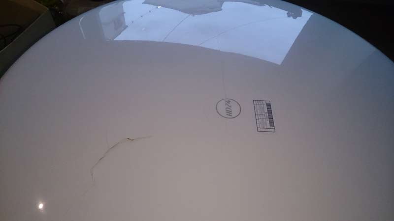

Few pics of the radome (btw, it's bloody massive!)
lid from inside:
bent spinning thing:
detail with popped bolt and marks from the plastic lid:
Ah, forgot to mention that since the spinning thing is rather slow spinning, I guess there wont be any problems with slight unbalanced spinning bits and it doesn't seem that the support is mission critical (always open to other ideas)
cheers

Pics of the port side mess (mainly bow and bottom, aft side looks ok):
It's clear that I'm only going to be using the sbrd side to go to the bow ;)

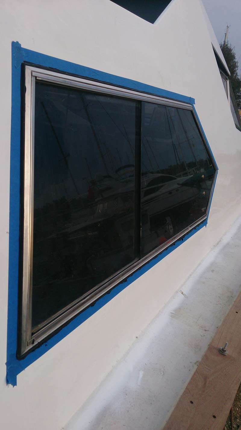

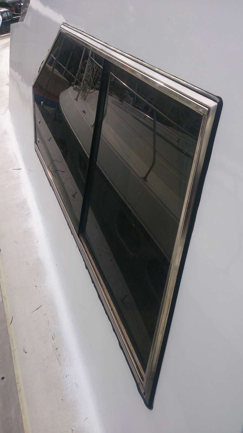

did the stbrd side properly today with blue tape and all that, looks much neater, will have to go again within the next couple of days to cut the extra sealant and clean up:

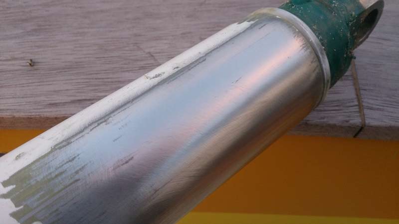

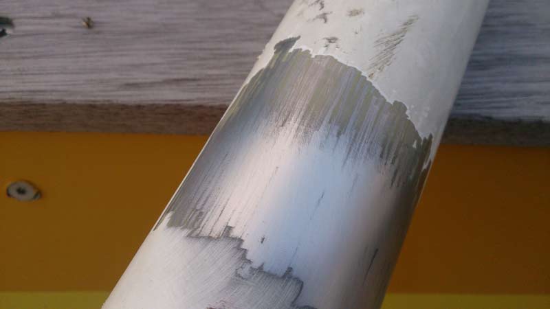

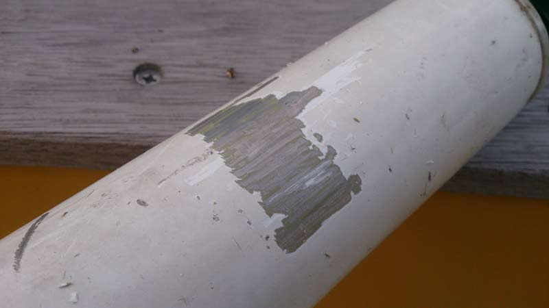

Quite happy, had an extra half hour so tried scraping the slightly flaky paint off the passarelle ram. Not much point being white on a grey hull with a ss passarelle... Turns out that it's doable - probably need another hour and a half to strip it and polish it:
(last pic was with a thin wirewool type of synthetic pad, will need a pass with the polishing cloth and should be fine)

Back at home, using a small washer got the rotating thingy secure again (didn't yet bother to straighten it though) and hooked it up to my Garmin 3006C chartplotter. First couple of times were disappointing as it was slowly turning and stopping and the plotter hadn't picked it up. Eventually secured the cables properly and plotter picked it up!

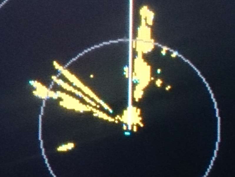

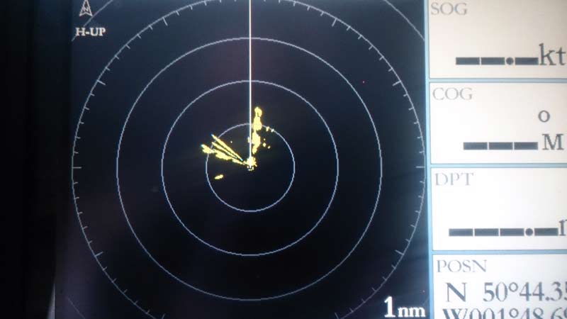

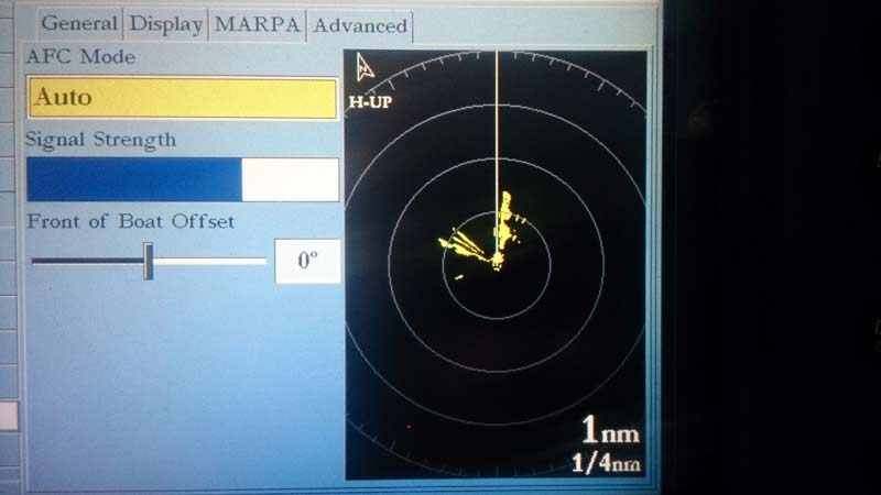

60sec warming up and even had some scan!
Problem is that through the office window with a slightly hideous church opposite blocking the view and all being quite close, it did manage to get something that resembles the plan of the area. Verdict, it works!
So next task is to get the lid for a repair, thinking if I should stick to white or get the hull grey in the lot instead. Will depend on condition.
I've got a video of the thing spinning with the lid off, it does make some noise imo it's coming from the toothed belt.
I'll post it once I get it down from 30MB into something reasonable for comments.

Vas, thanks, good going.
The radar image looks monochrome, not coloured. Is that what you were expecting? I though HD/xHD provided different colours based on signal strength.
If you decide to paint the radar dome black, I'll send you if you want a set of Garmin xHD decals in silver (grey-sliver, not chrome-silver). I'm having my radar painted black currently, so I had the Garmin decals made, perfect copy of OEM original font, and I had spares made. The word Garmin is 343mm long x 50mm high
re radar image, considering it was through a 1m wide opening with a bldg. 20m in front and a ledge halfway up the radar, I thought the image was fine :p
actually, zooming in the pic, it features a couple of colours, as I said, haven't studied radars yet, I hope it's fine

tbh, i'm slightly worried on how the repairers are going to deal with the crack, I'm afraid the med heat + dark colour will boil the thing and crack/delaminate it!
otoh, if I go for a white look, i'm pretty sure that Alekos will be able to match paint the top masking the sides and make it look like new (only seagulls and 80ft+ long vessels will be able to see the top of it :D

Thanks Vas. Yes I can see it is working in colour on the close up. Light blue means weak signal/soft target like leaves and rain etc. I'd expect to see some red, but you can fiddle with all the settings when you get out on the water. Main thing is that it works!
No-one will see the repair. You could just cut a 250mm disc of white 2mm plastic sheet and glue it on with sika flex

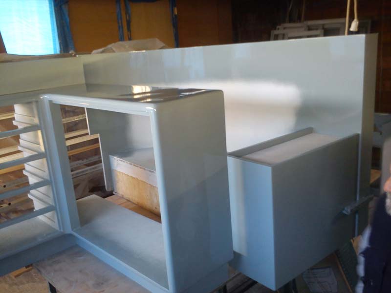

Haven't even managed to get to the boat, but visited George at his workshop yesterday to establish if moding the sofa cabinets to accommodate the stereo is feasible. Turns out it very much is with (relatively) minimal effort. So it's going ahead once I get the time to measure and finalize dimensions. Did a 20min pshop of how it would look, not bad and i'll have it just by the sofa plus sitting on the aft deck would make the phone on a 2.5-3m range of the stereo with nothing in between!
I'm lucky as all the speaker cables (nice thick ones installed last spring) can be rerouted in 10mins to the new spot and lengthwise they need less than half a metre shortening, no big deal. Power is a slight issue, but I'll route a new cable straight from the el.panel which is over a metre away and disable the existing one.
So from this:
we are getting this (yes I know perspective is wrong, but it's 1am and cannot be bothered to do anything better...):

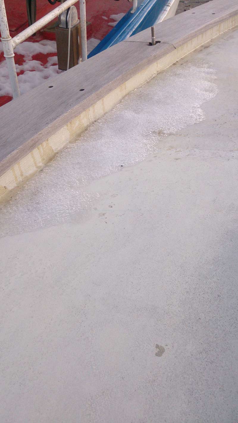

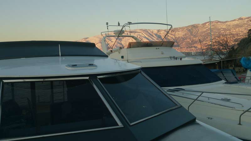

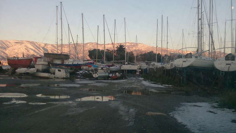

Snow everywhere but MiToS, paid a visit only managed to find this pathetic tiny patch of snow on the port side deck towards the bow. Very disappointed!
A few pics from today :
and xmas eve:

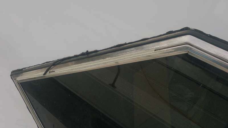

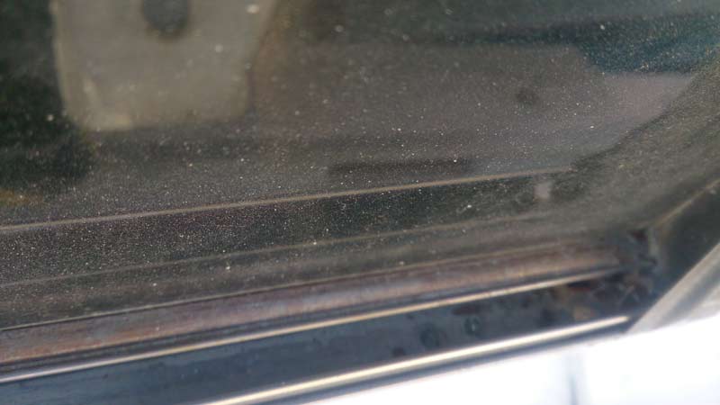

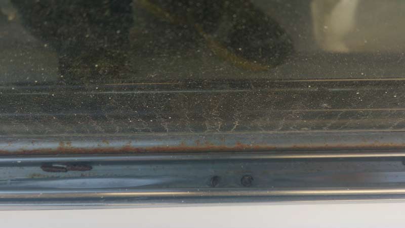

guys, got some leak on the stbrd side salon window aft. Rain water gathers in the slide where the window normally opens and some of it manages to go IN rather than OUT from the gutter. Always thought it was a sealant issue, but now that I got both frames properly sealed and bolted down, I get some water dripping in serious downpours. Now following pics show the slide/gutter (call it as you wish) where the window pane moves. I can see some holes on the U formed ss strip (maybe 3mm dia) they seem to be 3 pairs iirc along the length of this section.
Now, I wonder if there was meant to be some sort of synthetic material to help the glass pane slide and doubling as a sealing agent for this strip. I vaguely remember removing some rotten/disintegrating "thing" out of that gutter when I was cleaning the frame in the summer and I wonder if the water coming in is due to this thing missing.
So guys, could you please check when you're next there if there's something in there? A few pics would be nice ;)
This is what this gutter looks like now:
next pic you can see the slide marks either side of the holes as the glass rubs down there:
