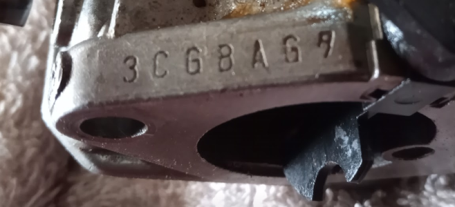

The carb which came with the engine appears to be a non-standard one from Keihin, with a number of 3CG8AG7, which I've been unable to find any reference for anywhere, which is curious?

I suspect that the Keihin number is a serial number rather than a model no. On mine (Mariner 4hp Sailmate of the same vintage) it was 3CGBVH1 which equally doesn't yield any search results.

As a slight aside the present carb is:1716114719610.png
I wonder whether the main model/type is the 3CG, and the rest just a more refined ID/version?

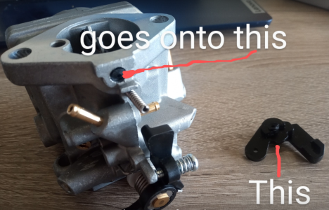

My new carb arrived a couple of days ago, in a wee box that looked like it'd been through a hard season of ice hockey.
The choke actuator had been broken off from the choke; the bit to the right has the choke cable attached to it. I didn't want to send it back as I didn't want to wait another 3 weeks, so I ended up using a 1mm drill bit, drilling vertically through the broken off bit, and through into the small hole in the centre of the piece in the carb, then leaving the drill bit in place as an 'internal splint', and super gluing the two pieces back together. I should say that I removed the bit in the carb, which comes out when the choke flap is removed, which was simple. I left it overnight, refitted it in the morning and it works.
Job done.:)
I'll admit to swearing Dave! They're identical in nearly every way, but for the choke 'flap' mounting. The new spindle goes through a hole in the top, with the bottom of the spindle in a recess at the bottom. The old one is a complete item, with a press fit cut out at the top, but the same recess at the bottom.

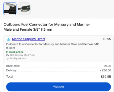

By the way, word of warning about ordering online. I want to replace the fuel connectors on this engine, so browsed in the usual way and saw this from a company in Preston.
There's a name to remember.
