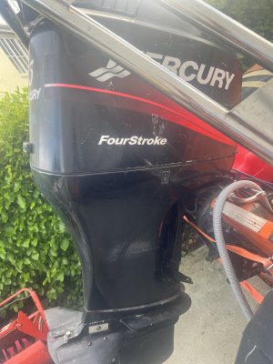

Hi everyone, I have a Mercury 75 outboard 4 stroke, used it last year up until October flushed and left it until this year. It now barely turns over. I took all four plugs out and it turns over ok but doesn’t fly. I have sprayed WD40 into the cylinders but it’s made no difference. Someone said it could be a tight water pump but any help would
Be appreciated

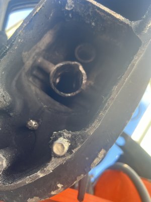

Ok so I have taken four bolts out on the bottom leg and the one up under the prop, I can only get the gearbox about a half inch loose?? Am I missing something?

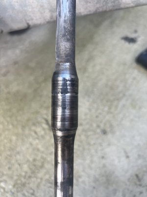

There was no top bolt…… I have dropped the leg and omg was it tight!!!! There is a bit of scoring on the shaft as shown in the pictures. Is it an issue? Also do I just lube it up and replace or do I need to change something?

Have you undone the anode bolt?
Sorry forgot the pics
Just clean the wider part of the shaft with fine emery cloth. Clean out crap from the splines and grease with 2-4-c - so when you take it off again it actually comes out!
The casing around the middle bush seems intact and judging from the marks on the wider part of the shaft it still has some life in it. Smear a dollop of 2-4-c grease on the wider part of the shaft as well - it will help lubricate the bush.
