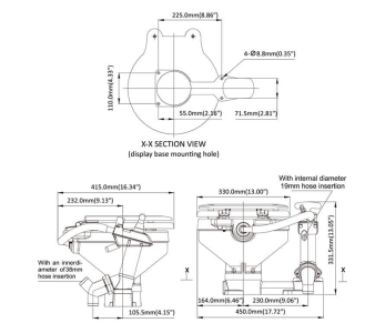

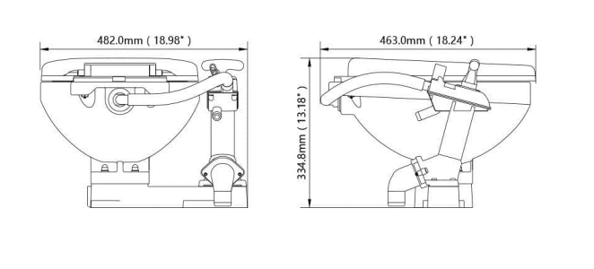

As already mentioned the common size for both makes is very small and uncomfortable, but tolerated on a boat because most toilet compartments are cramped. However if you do have the space as I do on my boat then the larger "standard" Jabsco is the same size as a domestic toilet and much more comfortable. If you are going to use this regularly surely worth getting the best rather than penny pinching on the most important bit which in itself is only a fraction of the cost of the whole installation

No I have not! But it would be nice to look at one before buying. As for size well I was given the messurment and for the standard size they appear to be very simuler to that of a house hold toilet
That is what I though! that the standard size toilet of the cheaper one in question was the same size as a regular toilet and the compact one was a lot smaller. Have a look at the images I have attached; they have come from the seller
