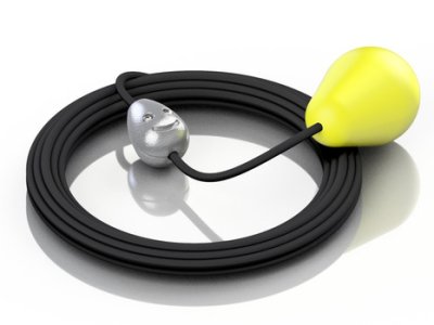

The first link you post; they look like top or bottom flout switches. i.e they are mounted to the floor or wall or the tank
But dont we need something as a warning before we get to a full tank (half way maybe) and by full in this instance I mean the float switch being less then 1/2" off of the top of the tank wall?

The photo in the link is completly different to the one you supplied in the thread!
But in the link the description states "The RSF66 series comes with a 1m standard cable length with flying lead. It is a four core PVC cable." that dose not look like you have a meter of free play to choise where you want to place your float switch in the tank because the metre coil is above the threads. Infact it dose not even list then length of the tube for the float switch to go up and down on
But the one in the photo looks like one of those boat pump out switches like this one
https://cpc.farnell.com/triton-cont...3081&s_kwcid=AL!5616!3!605262956779!!!network}!2144669031752!&gclid=CjwKCAiA7t6sBhAiEiwAsaieYh3Zd3MsLeEuQwFynKUjlfEgGAbh96NcrUMGv7bTSaegst-oHCJbExoCFPsQAvD_BwE
On the photo you supplied, there is some kind of blue thing above it on the coil. What is this? Is it a mounting point to clamp and seal it to the top of the tank allowing you as much free play of wire in the tank you want?

But dose the one in the photo allow you to change how high or low you can set the float switch in the tank?
Do you have a link to where you can buy the one in the photo please?
