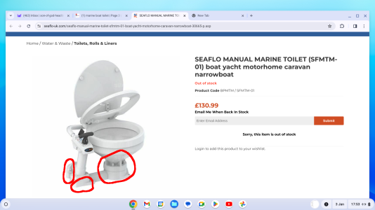

Looking at this toilet
Seaflo Manual Marine Toilet
From the photo there looks to be 3 holes to it. one under the toilet and one under the controller flush and a pipe at the back
I need a little more info really so they can find me the right size tank that will fit the outlet. Dose anyone know what the floor layout of these are like and are there really 3 holes to it, any one know the whole sizes?

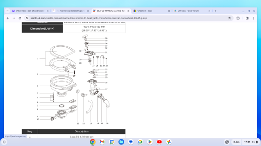

Have a look at these diagrams - I'm not sure where you're seeing three holes.
SEAFLO MANUAL MARINE TOILET (SFMTM-01) boat yacht motorhome caravan narrowboat

Only 2 holes.
1) flush inlet 19 mm dia
2) flush outlet 38mm dia

So Where are the wholes in relation to the toilet, can you see it on the image i attached? do you know which number they are?
but it dose not show you the lay out on the floor so you know what type of tank will fit it
I think you're assuming there's a hole right under the pan, through the floor - there isn't.
There's a water inlet just under the pipe leading to the top of the pan, at the back of the top of the pump. The outlet is at the bottom of the pump. Both connections by flexi hose, no other connections.
Part 8 bolts to the underside of part 3 which directs the black water to the bottom of the pump which is pumped out of part 16 which is piped to the BW tank inlet
Part 13 connects to part 12 in the bowel flush and is connected to outlet on part 31.
The part 18 has an inlet that gets piped to the flush water tank or the the sea water inlet on a boat
So only 2 holes
Part 8 is the head mounting to the floor
Im a bit confused! So i have attached a drawing of the 3 holes i was refering to
