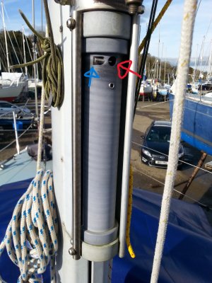

Is it like the Easyreef system (pictured)? The furling line terminates in the hole (red arrow) and the grub screw (blue arrow) simply clamps onto it. With the sail fully furled, there should be at least one or two winds of furling line around the drum so the furling line is not pulling directly on the screw.

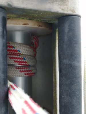

Picture of furling gear shows top of stopper knot. Do I have to remove the vertical batons, main sail to replace the line or is there an easer way?

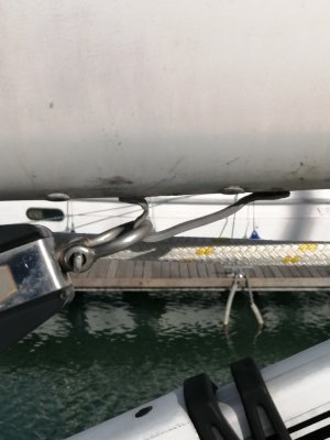

Second photo is the furling line's bite (is that the correct term?) which has been bent under the load of furling and obviously needs replacing with something heaver. Could I use self-tappers to attach something more substantial or is riveting essential?

Chiara’s slave
14 Apr 2022
7,652
Western Solent
I’m sure someone will recognise that, but sadly not me. I can only reiterate that a quality reefing line, once you work out how to get it in, will help you a lot. That one is quite stretchy by modern standards. That is not a good thing.
