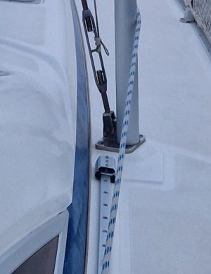

I've got issues with the original sail layout regarding the genoa, as it was originally designed for a large one (151%), so the genoa tracks are intended for a sail of this size. The compromise here is a 120% jib, I wanted a 110% but the clew is not far enough aft for the current tracks - they can't be extended because the stays are in the way, and their positioning means an in-hauler would pull the sheet hard against the stay (see pic in an earlier post) .... so 120% jib it is - it's still 45,5m2 which is big enough for me, and I'm happy with an 83m2 code as we are a small sailing couple.

My main comment would be to take a really good look at the sheeting angle and determine if a small extension of the track, or maybe a flying system would help you get the jib you actually want.
