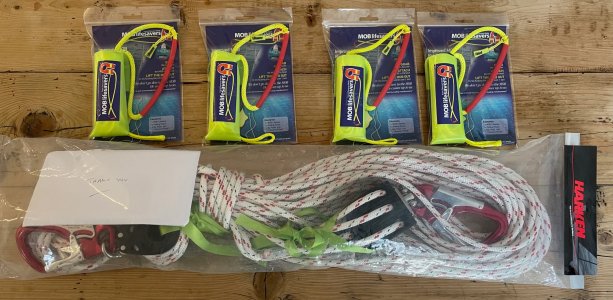

We use the billy tackle from MOB savers - picture below. Pricey, but well engineered. You can of course make your own up and save money. Jimmy Green and others can supply similar billy tackles.
My 55kg wife can lift 72kg me easily with this - albeit me not wearing soaking sailing kit which would add quite a few kgs.
One thing to consider is how to lock off the tackle. This one has a ratchet block - but you could use a cam cleat. Also the ratchet block/cam cleat should be at the top, so that you're pulling down. Obvious when you think about it. The subtle advantage of a ratchet block over a cam cleat is that it's easy to lower the casualty if/when they catch under the lifelines (which happened to me), and when you want to lower them onto deck once inboard of the lifelines.

Fit MOB Lifesavers (as mentioned above) to all lifejackets and carry a couple of spares for guests. Have an 8:1 ratchet block with carabiners at each end,
MOB in water, lifesaver floats free.
Get alongside MOB boat hook lifesaver and attach to mid ship cleat.
Connect 8:1 block carabiner to spiny or other halyard.
Hoist 8:1 block on spiny or other halyard at least 15’
Clip other carabiner to Lifesaver
Use block to haul onboard.
I bought the whole lot as noted above. I can rig it in under 3 minutes, while the boat is being manoeuvred back. My small , lightweight wife can lift all 210 lbs of me effortlessly, single handed, ratchet block, horizontal and position me in cockpit or down fore hatch. No other help needed.
Tried and tested, it works, no faffing about.
I would not use anything else on my boat, and insist that guests who bring their own life jackets fit one of my lifesavers. They fit to the lifting strop and tuck inside the stole. I flake ready to float free. If no lifting strop, then you need to consider alternative.
