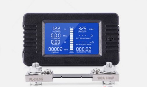

Both the battery banks (Start and Leisure ) have independant simple LED voltage alert devices fitted.
LED Green and 3 flashes means fully charged, right down to LED Red and a single flash means battery volts low and then finally a buzzer for an audio warning that something urgently needs doing.
Now, plus a recently installed battery condition monitor to Leisure bank only.
Boat on shore power over the last week. Master switches OFF, only possible drain is if any bilge pumps are activated. Bilges drier than the Atacama Desert.
With shorepower connected and on , 14.2V volts on display of battery condition monitor.
Shorepower OFF. Volts settle down to 12.8 V and 3 Green flashes from LED device.
Power up everthing and anything, within 30 mins volts reading 12.2 on monitor and single red flash on LED leisure batteries voltage alert.
Switch off all load.
Start both engines and left running, volts back up to a steady 13.8V after about 10 mins.
Generic Picture.
Generic Picture.
I have still not read the complete thread. Sorry if you have provided detail but it might be quicker for you to reiterate than me trawl through the posts (and it is still Xmas here, just :) - and no hurry - I'm not going to Hobart tomorrow :(
I may have missed a trick - but is shore power connected to a battery charger for the house bank? That is what you imply - just checking :). Which charger.
I confess a lack of familiarity with the meter you display (as its a blue display it might be Victron :) ) I assume that the meter and, the shunt, are connector across the house bank only, house bank (I don't recall on the neg. or pos. side only). When you switch off shore power and switch off domestic house bank what does the meter display in terms of amps in and amps out. It should read zero or near - post a pic. You only have twin alternators and a battery charger - no solar
I'd be less confident on the voltage readings.
I think your meter defines battery state - you need to input a battery capacity. "Your" battery capacity is erroneous - that 'fact' is the basis of this thread (you lack capacity - batteries are knackered). So what did you input as capacity - and for the gurus what impact does inputting an erroneous capacity have on the usefulness of the data displayed. Does the meter do more than display data?
I have a similar configuration, my meter displays amps in and out it adds them up, subtracts from the inputted house bank total amps which it displays as a percentage of full. When my house bank is full voltage climbs and amps (in) reduces to near zero - assuming I'm not using 'something'.
Before you installed the shunt and meter what did you use as a battery charging management system. Reiterating I don't know your meter - does it profess to manage charging.
Have you tried monitoring data on each battery with the other battery out of circuit, isolated.

that pix displayed from a sellers website.
DC Battery Monitor Meter 100A 0-200V LCD Display for Cars RV Solar System Tools | eBay
The 100A shunt is fitted.
Boat is close by,will take a pix of the actual readings today.
I quickly glanced at the link.
My display allows me to scroll through a number of screens and in addition to the 'master' screen (which is a pictorial of the battery state + % capacity) I can look at actual amps in and actual amps out - I assume your display will do something similar.....and the displayed amps will vary if you are charging and the battery is full (or not) and by switching circuits on an off you can define how much each circuit is using.....
Jonathan
