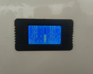

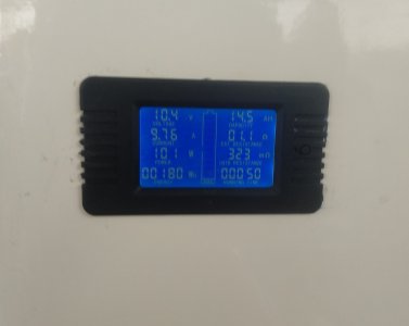

Back again with my recently installed budget battery condition display.
Two pix.
Shore power on for 24 hours and presume leisure batteries fully charged.
Shore power turned off.
A few mins for everything to settle down then everything turned on.
approx 50 mins later
2 x 105Ah 3 year old leisure batteries .

Your batteries are shagged, time for some trojans
