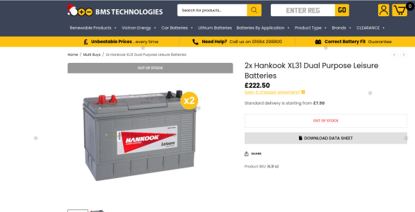

I have a couple of Hankook XL31S 130Ah batteries that are holding up well (so far). Similar to the image below except mine have single terminals. The dual terminal XL31 version is heavier and higher cost so must be be superior.

Will have look down the back of the sofa, presume that it would be sensible to purchase two batteries best able to provide the maximum ah which will fit in the available space. ?
:cry:
Yes, if you don't fancy changing to Lithium, biggest AH would be best.
I have fitted several of these and had no issues with them. Unfortunately out of stock, but might be worth a call to see if they are expecting some soon.
Hankook XL31 Dual Purpose Leisure Battery
