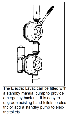

Lavac show the electric pump underneath in their diagram but there is no sense in the text of this being mandatory.

You mention that you have the manual pump before the electric but the diagram shows it the other way round. Would that make a difference as to why your pump isn't working ?
Edit just reread your original post. I would somehow try the pumps the other way round. They don't have to be bolted in place to do a simple test. The boats that I have been on with electric toilet pumps have been very noisy and not usable at night so I'm against electric pumps, especially with a lavac.

That is the nub of the issue, and I think I will give it a try, although I may not have sufficient space between the manual pump and the outlet... Which would require moving the manual pump and so more holes in the bulkhead..

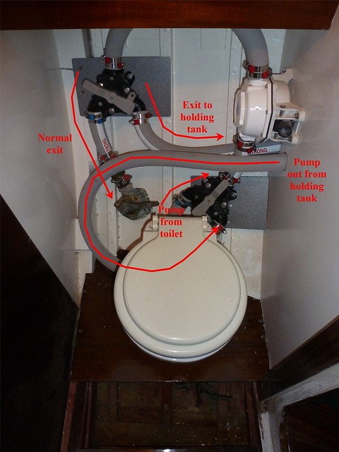

I have both manual and electric pump on my lavac and it works perfectly. I do have a diverter valve to divert either to a tank ot to sea with a separate tank pump out pump using the same seacock of the lavac all working well
Thanks for that...It looks like your manual is closer to the bowl than the electric, but also your electric pump has larger diameter passageways.
