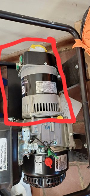

1000001648.jpgdoes anyone know can this part of a generator be changed? I.e. seapped from 110v to 240v? Thanks

Im no expert on these things, but I'm under the impression that there's a gizmo called a governor somewhere in there, which controls the revs. That's all that needs to be changed and it's a simple job for a diesel mechanic.

The label on it looks like it might have voltage taps on it somewhere. Normally 115v is two windings in parallel, 230v the windings in series.

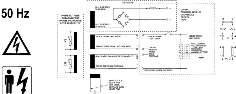

This is the actual diagram of your generator from the makers website so you'll find the colour coding correct (hopefully) >>
Download area | Alternator Manuals | Mecc Alte
Remove parallel links from 1>3 and 2>4 then link pins 2 & 3 and take your 230v from 1 & 4.

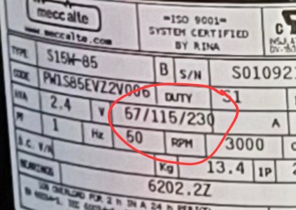

Do a search online for the manual, for the generator. Or contact the makers / distributors on the label they'll know .
I note on the label it says V 57/115/230, which suggests there is a way of switching or changing links to choose the voltage you require..
It also says Amps 2. 09 / 1.04, which suggests it will give 2 amps at 115V or 1 Amp at 230V.
I wonder if the socket is American wired? Live to earth 115V, neutral to earth 115V,( different phase) , live to neutral 230V..
Wouldn't be the first genny I've found like that...

Check again, the current rating is 20.9A (at 115v?) and 10.4A (at 230v?). The power rating box says 2.4kVA which tallies. No need to buy anything, I've provided the link to the manual and relevant page with instructions in my post above.
Yep you're right, as you are with which links to connect / disconnect .
Thank you for your help, just need to understand that info?!
I guess there is a cover I need to remove and expose these ''pins/ terminals'' then it might make more sense.
Thanks again.
