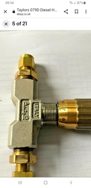

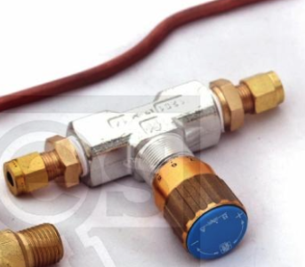

Hi Folks,
I would like one of these valves (see attached pic) but dont want to have to sell a kidney to buy one. Does anyone recognise this part and know where to source one other than Taylors and the other Taylors heater spares?
Cheers.🤞🤞

How do they get £250 for a fuel valve?
Medium Pressure Hydraulic Oil TOGNELLA MAKE FLOW CONTROL VALVE - FT-1252/2-01-14, For Industrial, Carbon Steel or similar
RS PRO Inline Mounting Hydraulic Flow Control Valve, BSP 1/4, 210bar, 20L/min | RS PRO | RS Components International
Flow Valves Aidro: CETOP modular valves, Cartridges, IN-Line mounting, Stackable valve bottom of page "Stackable - HDF Series"
Tognella Make Flow Control Valve Ft 1252/2 01 14
Looks like a standard hydraulic control valve, may be worth a visit to the nearest hydraulics specialist near you?
