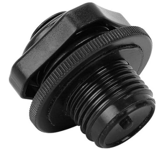

Query regarding the inflation valve for the above. I have to take a suitable air-pump to this inflatable next weekend. It's 100 miles away and I don't have ready access until then.
This pic sent to me by the owner 'suggests' a suitable inlet hose termination would be a simple tapered hollow fitting, simply jammed in. There's indication of a rubber flap valve inside....
Can anyone here advise the inside diameter of the valve as shown, so I can find and take a suitable pump/hose end-fitting.....?
The rubber flap is the one way valve to let air in. To let air out you unscrew the whole valve.
My (different model) of Intex inflatable has a tube that ends in a tapered nozzle, which tapers from about 15mm at it's smallest to about 20mm, over a distance of about 25mm.
It's a lot of bother to unpack the deflated boat so measure the actual inlet size so I hope that is some help.
It looks similar to the delrin Zodiac valve. I have one like this that is 18mm.
I have found that insulating tape wrapped around the pump hose will usually enable a tight enough seal to allow inflation.
If the valve is accessible I can pop over the river with a measuring stick, I'll be down at the boat from Wednesday.
I have here an Intex Doublequick pump, the nozzle is 17mm tapering to 18.5mm diameter, over about a 19mm length.
Measured with a cheap vernier, so 'near enuff'.

Thanks, B27 and ProDave. That's the info I need to do the job.
