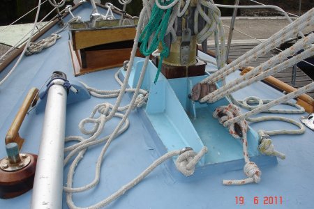

If you do find your mast is corroded at the bottom (although yours looks much better than mine did), you can have a reinforcing sleeve welded onto the outside. You can just see the top of it in this picture, level with the top of the teak chocks:

A good long soaking in penetrating oil, eg PlusGas, might help too.
Nice welding.
I try to do a neat job on mild steel- I wouldn’t know where to start with aluminium - I know TIG welding needs a bit more skill - that I don’t have.

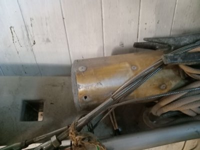

Different foot - but similarly inserted into mast base ..... (this is after repair) :
Out and ready to repair :
