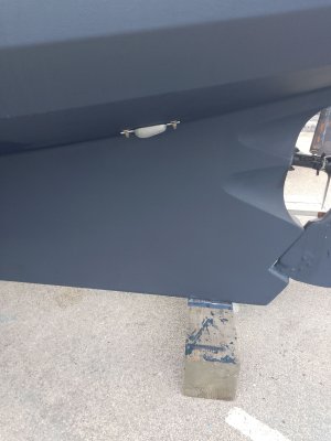

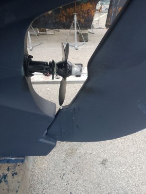

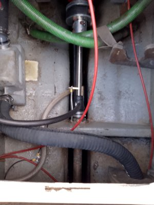

My boat is just about as complicated as you can get for a shaft drive sailing boat. The Beta engine has an anode in the heat exchanger. The shaft is stainless and the feathering propeller is a mixture of yellow metal (bronze) and stainless. The propeller has its own anode, but its size is limited so a hull anode is fitted as a backup. It is not connected to the engine because there is a flexible coupling so the circuit to the propeller is made through a contact running on the shaft. The photos show how it works. The first is the hull anode close to the propeller, second is the propeller with the anode on the end of the hub and the third is the connection to the shaft.

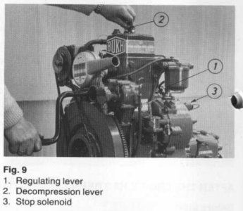

The DV20 has decompression levers as well. Hand starting was (at least) an art, I never managed it from cold despite trying. If the engine was already hot or at least a bit warm it was doable, it caught pretty easily. I Perhaps I needed to tame a friendly gorilla as crew for the cold starts.

Jonathan, I think you have perhaps confused the Bukh DV10 with some other engine (sounds like an old Seagull outboard!). The DV10 flywheel is (like all the DV series) on the front of the engine, not on the top of it. It is not at all part of the alternator (which is a standard separate automotive type alternator driven by a belt). Neither my DV10 nor my DV36 had any wiring under the flywheel.
It is precisely the fact that the Bukh DV series has a practical hand-start facility that is why it is still manufactured today - as this is apparently a requirement for lifeboat engines, which is the bulk of the DV series new sales these days. (Bukh today also produce a lot of other, much bigger and more sophisticated engine series.)
I previously had a DV10 (which always started easily, by the way), and starting it was not all the major operation you describe. I simply removed the front cover (integral with the companionway steps on my boat) and inserted the crank handle in the socket on the front of the engine. The decompressor lever is on top of the engine, accessible from the front, as shown in the following pic from the DV10 Owner's Manual. [EDIT - It would normally be started by the battery, of course, I only started it by hand to prove to myself it could be done if need be.]
You do not use a rope to start a DV10. There is no facility to attach such a rope. The starting handle is a hefty metal traditional type crank-handle (with a cylindrical rotating sleeve on the hand grip). The drive socket for the starting handle is on the front of the engine on the D10 and 20. In all the DV series the handle does not go direct onto the flywheel, but into a dedicated socket which connects to the crankshaft (or is it the camshaft? I forget now) via a chain.
On my DV36 (and presumably the DV24) the socket is at the rear of the engine and above it, so can be started either from behind the engine (installation permitting) or, with a longer starting handle, in front of it. On the front of the engine is a bracket with a guide for the long starting handle - presumably it is that bracket that Vyv had missing from his engine (see post #24).
