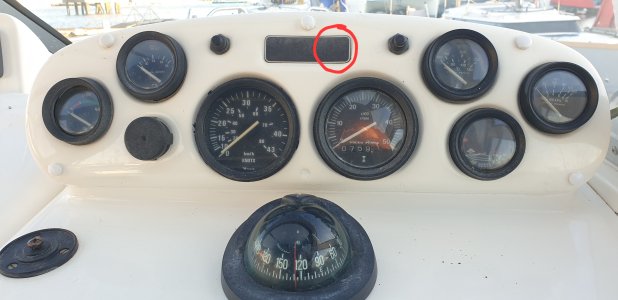

I have had a Sealine Senator 240 with a Volvo AD31P as a first boat for about a year. It's been quite a steep learning curve but I'm getting to grips with most things but the manuals don't help much.
Yesterday I did something stupid - forgot to turn the fuel on before starting the engine.
It was running for a few minutes when an alarm sounded and the right hand warning light (pictured) came on. I went to shut down but the engine might have stopped just before I turned the key - presumably (and hopefully) fuel starvation and not something else.
Possibly coincidentally, while it was running, I was watching the exhaust and thinking that there was a lot less bubbling out as usual.
My first question is - what do the three warning lights indicate? Specifically the right hand one. They are unhelpfully not marked.
Secondly, thinking of the reduced exhaust activity have I actually got two problems, e.g. raw water impeller on top of fuel starvation?
Thirdly, I have never tried priming the fuel system (which I'm sure it will need) and am apprehensive of doing something that makes it worse, so can anyone recommend someone in the Gosport/Postmouth area who could help me with all this.
Thanks for anything you can suggest.

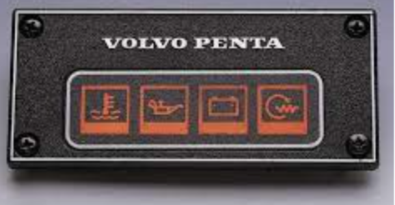

I think there are 4, not 3 lights. Left to right: water temp, oil pressure, battery / alternator and lastly the cold start / glow plug lamp.
That is assuming they are the right way up!
From memory, bleeding involves loosening the connection of the fuel pipe to the injector whilst cranking the engine. Tighten again once it fires and spurts diesel.
But check the manual procedure first.
Once running keep an eye on the temp gauge if you have a cooling worry.

There's definitely omly 3 warning lights on mine which is a year 1993/4.
I have seen a pic of it ... somewhere.

But..secondly. If I’m perhaps right in assuming my the picture, that you are on the hard and out the water…I’d think it perhaps likely that your dash light could have unfortunately indicated a high temperature alarm perhaps?
Assuming you had water introduced to the outdrive somehow…I know from experience that these vp DP 290 variants don’t always do well at picking water up from almost any means, other than conventional means, I.e…being in the water normally. Muffs, water containers etc etc…are a 50/50 at best. Especially so if no priming to the engine driven pump or close by has been performed.
I’ve only known one particular style of muffs that did half a job at this. Countless others just don’t manage.
I may be wrong in my assumptions…but if I’m not..you need to have a look at that impeller on the pump, at the least.
Best of luck.

Thanks for the long reply. She is afloat and was ok 3 weeks ago. I suspect I have two problems - 1) priming the fuel system and 2) investigating the cooling issue.
As DavidJ says above, I don't know when the impeller was last changed so that's a good place to start.

The dash warning lights may include a glow plug light even if glow plugs are not fitted.
