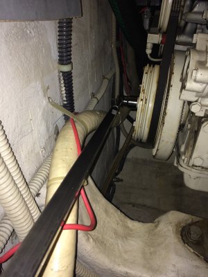

Not sure i could turn these engines, both big lumps 6 cyl 250hp turbos
Yes you can !
Diesels have loose rings which expand as the EGT s rise to seal ,
So when stone cold unlike petrols ( with compression- your point ? ) you can turn them with a spanner on the crank pulley bolt .
Or a bar on a socket .
I could easily “ bar “ 13 Litre 700 Hp MAN s no problem when I did the valve lash .Obviously stone cold .
Normal ratchet with a bit of sq bar for leverage .
Stick it on the crank pulley and away you go .
kashurst
10 Oct 2003
11,402
Spain
You should be able to turn the engine over - however a spanner won't do it. You will need correct socket and a tommy bar - something at least 2 feet long. As it rotates you will feel the compression building and releasing. If you cannot turn it over that's a problem. There is no way you will be able to turn it fast enough to accidentally start it, so don't worry about that.
Fingers crossed it will turn over OK. Try the good engine to get the feel of what it should be like. It could just be that the starter has gone pop and blown the fuse.

With a spanner on the crankshaft can you compare the stiffness of one engine with the other. Im thinking it’s not a starter motor problem (for your sake I hope I’m wrong)

Thank you I will give that a go when I return to the boat
