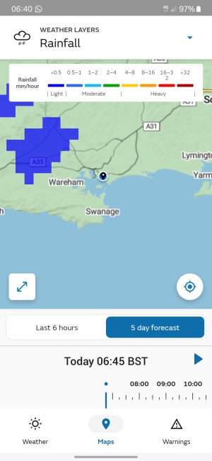

Hi Frank, funnily enough I was caught out by quite a heavy shower near the end of my morning walk today. Luckily I was close to home, otherwise I would have got very wet. As I was walking along I checked the Met office app, and the radar showed the image below (hoping this attaches properly). This shows no rain for at least 8 miles, but at the time there was the shower I was under (which took about 5 minutes to pass over) and I could see a couple of other similar-looking showers around the edges of Poole Harbour.
I'm not at all surprised that the radar fails to distinguish between low cloud, mist, fog and drizzle. A few years ago I led a team of engineers developing automated meteorological systems for UK and international airports, so I know how difficult it can be to make sense of such data. But as I said, using the Met Office app radar map, my confidence is moderate at best.
To some extent, I think that you were unlucky today. To see ths latest actual radar image, you have to use UK rainfall radar map - Met Office. The first image on the app is a short term prediction. The actual at o645 showed a small band of showers just north of the coast. I do not know why these should not show on the predictions on the app. Maybe just too small for UKV with its 7.5km effective resolution.
For reasons thst I explained above, westher radar cannot see mist, cloud nor, more often than not, drizzle. Predictions of those are from NWP models. There is no relevant radar input. Rain seen on the radar is an input into models.

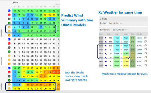

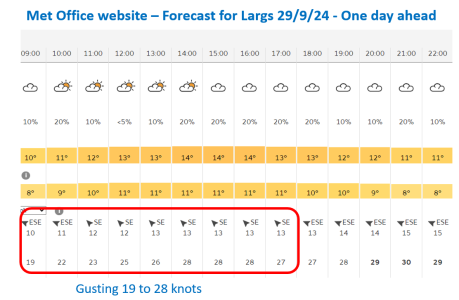

Now that this thread has drifted off into every other topic about weather models, perhaps bring back to the thread's specific point - that a few weeks back the Met Office online forecasts suddenly started regularly / always giving very high wind gust figures. Figures which were
(a) not shown on other forecast models;
(b) not shown in either of the Met Office models used on predict wind; and
(c) in almost all cases bore no relation to the actual weather on the day (over a period of many weeks).
My suspicion is that somebody has tweaked a few slides back again, as the degree of extreme pessimism in the Met Office web model seems to have reduced a bit in the last couple of weeks.
But it still seems to exist. Looking at whether to go sailing tomorrow, the forecast for 24 hours ahead we have:
- Met Office web forecast with winds 10-13mph (nice) - but gusting 19-28mpg (not nice with young family!)
- Met Office on Predict Wind with U2 showing winds also 10-13mph but gusting a more reasonable 16-20mph
- XC Weather showing 6-14mph and gusting 8-21mph - with clear indication that getting breezier later in the day
So anybody care to explain why the Met Office web forecast consistently differs so much from the UKHO (both U and U2) models in Predict Wind.
This has been consistently out now for nearly 2 months and hass made met Office web forecast (previously my main reference) useless as "crying wolf" on most days.
