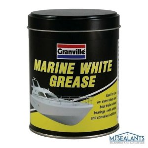

Thus type of tub is the best to use with the mini gun.
It has a plate inside that has a hole in the middle. You put the tube over the hole and gently press while pulling the filling bar out.
A full size grease gun would take over 10 years to empty if just used on one boat.
If loaned out it would not be returned as you will forget who has the dammed thing.
