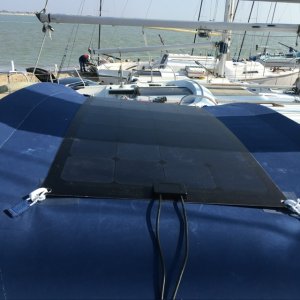

I have a couple of 30w panels which I'm thinking of fitting to the top/sides of my sprayhood so that one will always be in full sun irrespective of which way the boat is laying when on the mooring. The panels have 4off 8mm id eyelets and I was thinking in terms of some sort of quick fix/release system a bit like a drop nose pin but the sail maker tells me there isn't anything like that available. He's talking about sewing material to the hood to make a pocket that the panel will slide into and be secured on one edge with Velcro. He hasn't seen a panel yet but I don't think it's going to work because the panels nearly fill the available flat section of the hood.
So my question is simple, can anyone suggest other methods of fitting panels? They do need to be easily removed if I need to fold the hood down.

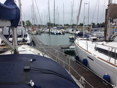

I attached a 110W with simple bungee through the eyelets.
Worked well. Even at F7 and above.
However after a couple of seasons the panel failed - i assume due to micro cracks.
I would do it again, if I was I would try to make a backer out of GF to add to the panel to avoid flexing and make it rigid to the shape of the sprayhood.

Not withstanding concerns re concave bend on panels etc. gregscope system of having tags sewn on to top of hood witha small lashing from eyelet in tag to eylet in panel. If you have room for that method. If not perhaps tag with eyelet under the hood with lashing around the edge. You could attach tags in situ using a piece of cloth and thin whipping twine and needle to sew it on. ol'will

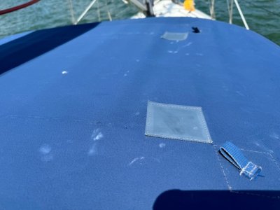

I like @Trident solution. Cheap and reversable.
Here is a close up of mine. Notice that there is a mark around the outline of the panel. I assume this is from some gentle rubbing. For longevity i would have added another reinforcement strips.
