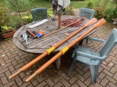

Bought a set of old style wooden Oars today from a nice chap in Colchester area. £35 for the pair and in very good nic
The G and P stand for general purpose, and it used to be quite common to see GPs , enterprises and the like with rowlocks, in reality they don't row very well. They are too wide and the thwart is too low, also they are not directionally stable. The least worst option will be to have Mrs Plumbs row while you steer with the rudder, also keep the plate about 1/3rd down.

But GP14 should row OK when you need to - with rowlock plates set next to edge on little blocks. 5ft width same as my 10ft dinghy and same freeboard - Oar lengths look OK - Agree put plate 1/3 down but tie the rudder with an elastic. Centre main block not really a problem.

Not sure you are correct about that. Look up sailing Skismo on you tube. The chap on there rows his GP 14 a lot. Mind you his oars are 90 inch mine are 82 inch. I can quite easily lengthen mine if needed by extending the handle and moving the plastic mount bits.
Just ordered the Stainless Steel Rowlocks from Temu for £12 for a pair. Now just need to workout the best place and where to mount them. Started using Temu a month ago. Once you suss out how to use it it is ok and very good value
