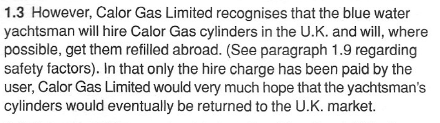

Calor Gas bottle refilling by amateurs isn't as 'forbidden' even by Calor themselves. Attached is a snippet from a Calor document, released back in the days when they were a good company, entitled 'L.P.G. (BOTTLED GAS) FOR BLUEWATER YACHSTMEN - Information and advice form Calor Gas'.
Among the good advice and information, it includes advice on re-filling, including this telling para:
I suspect that The Carriage of Dangerous Goods and Use of Transportable Pressure Equipment Regulations 2004 is difficult to enforce in the Caribbean. :)
