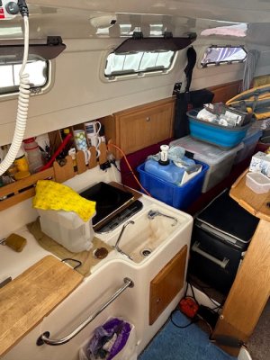

We have a portable 40 litre waeco/dometic fridge and on our last 9 week cruise also had a 12litre brass monkey unit which we had set to freezer temperatures.
I found this too small to be useable though we did freeze some meat in it and some bait extending our meals selection.
Our next planned big cruise entails 3 months without the ability to resupply and I have decided to use our 40 litre portable fridge in freezer mode and convert our 80 litre built in ice box to a compressor fridge with a retro fit kit. Swapping out frozen ice blocks from the Brass Monkey to the ice box proved non viable.
Despite our chosen craft being a 28 foot trailer sailer we have 840w of hard ( some able to tilt ) solar panels and a further 400w of foldout flexible panels on both our upturned inflatable on the foredeck and on our dodger.
I agree lots of extreme adventures have in the past been carried out without any refrigeration or other modern conveniences at all but I have found some of these more modern inventions have gone a long way towards getting the fairer sex to happily participate in our desired journeys. 🙂
Despite our diminutive size we also cook via induction and use a variety of other 240v appliances on our small yacht. IMG_2178.jpeg
Despite our diminutive size we also cook via induction and use a variety of other 240v appliances on our small yacht. View attachment 172906

Thanks Grith, mighty impressive power you have ! (so to say) Yep, as a member of the fairer sex I agree that a few home comforts go a long way to get us on board. :) Hope all your planning and doing in preparation for your next big trip goes well. :)
