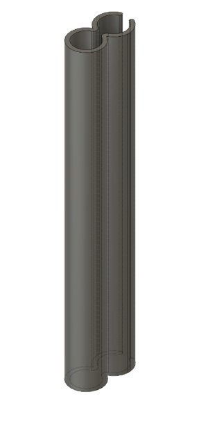

I've done two types. The first one had these spacers in every section and it was not possible to thread the new stay in without dismantling the foil sections. I had to 3D print some new ones in nylon.Foil spacer 2.jpg

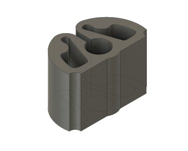

The other type, just completed, had these the full length, again preventing the new stay with fittings going in without separating the foil sections. I had to print more of these too.

It's very easy to separate the foil sections though, so no worries.

I've done two types. The first one had these spacers in every section and it was not possible to thread the new stay in without dismantling the foil sections. I had to 3D print some new ones in nylon.View attachment 195816
Exactly ... separate the sections and feed each set on and move on to next ...
Its a good idea anyway to separate - as over time you often find with tension / curving of foil - that are hard spots at joints when hoisting genny ... gives chance to sort the joints

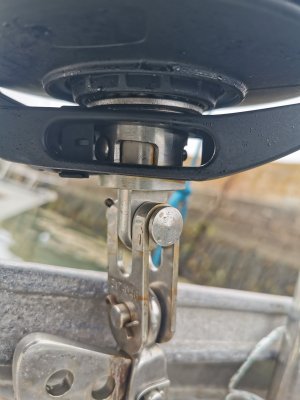

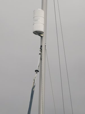

Okay, so my system is a Seldon Furlex 104S.
Will I be able to pull the stay through?
