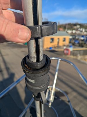

The halyard swivel on my old Plastimo 608s jib furler has been quite stiff.
My understanding is that in order to replace this I would need to detach the forestay and remove it from the top. I am keen to avoid this if possible and dismantle and clean it whilst it's still on the boat.

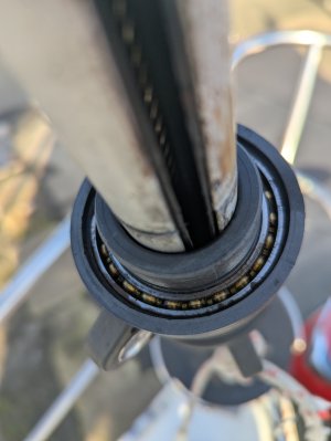

I have managed to unscrew the top cover and cleaned a bit of old grease and crud out of the top. I would like to get it apart so I can clean up the bearings etc and re-lubricate. However the inner spindle does not want to move down. I have tried a bit of gentle persuasion with a wooden block and hammer whilst supporting the outer shell.
I wondered if I could carefully prise the shell and spindle apart using short rope strops to each attachment point and a car jack. Does anyone have any experience of dismantling these whilst still on the forestay? Any thoughts or tips?
Photos attached

Hi Gary. Do you rinse it out with just the cap off? I am concerned that this would just wash any crud into the lower bearing if the shell and spindle are still in the original position. Also the water wouldn't be able to drain out. Maybe I am overthinking this.
Many fullers recommend just hot water.
You may be overthinking it, but perhaps not.
Maybe try washing in situ as advised above and see if it works (no crunchy sounds afterwards !)
Perhaps use pressurised air to blow anything out once dry? The bearings look secure in the race, so hopefully no chance they can come loose.
If you do get it off then you always have the option of replacing the bearings if cleaning doesn’t help. It was a while ago I did it but an easy job.

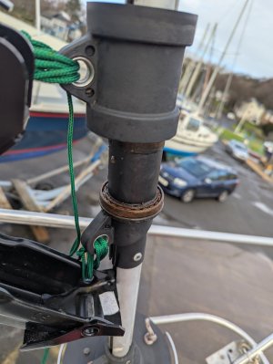

UPDATE
Thank you to everyone for your input.
So the car jack idea worked a treat. See photo.
I have now been able to clean out the bearings and swivel with plenty of detergent and hot water. Bearings are feeling a lot smoother. I have left it apart at the moment to dry out a bit and will then clean with white spirit.

Ok, the bearings were gunked up. Why?
Could it be that a lubricant (grease?) was used in the past?
My thoughts is/are. use nothing except a fairly regular rinse with water.
