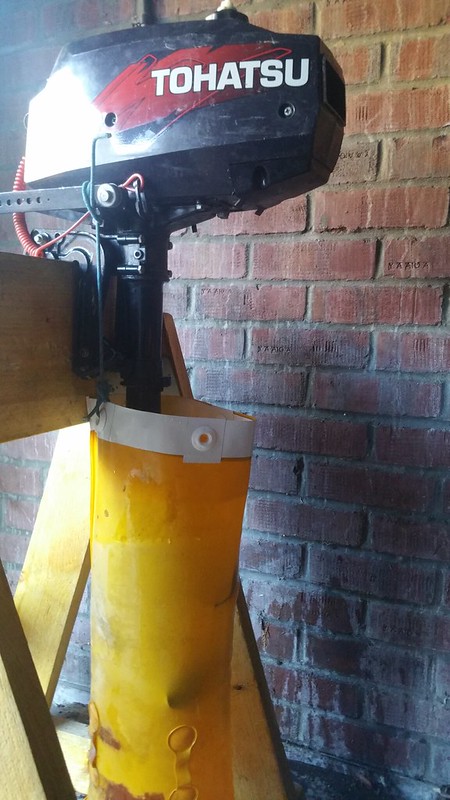

On bigger engines it is easy access designed to mate to hozelock type hose pipe fittings. You can be flushing minutes after securing to your pontoon berth.
Part no 8M0057047 is the kit that allows that for the smaller engines.
I was just too cheap to buy it and had the hose lying around. The bare screw in barb comes with the engine.
