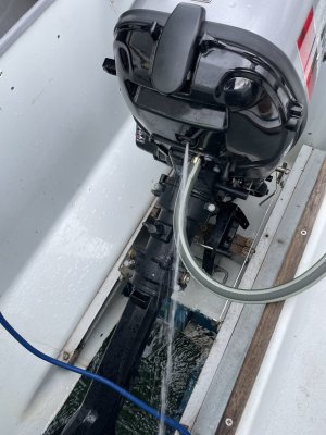

Where is it? I have a new tohatsu 6 and was disappointed to find you can't use flush muffs with it, have to use the old bucket of water.
Shows it in the manual on the Mariner which is the same motor with different decals.
Underside of the power head, 12mm(?) bolt?
