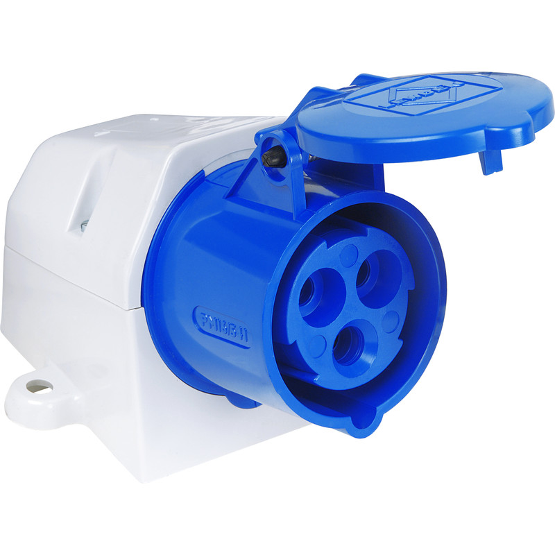

Female socket on boat for mains connection?
Most boats, including mine, have this on board, preferably in a sheltered spot
Industrial Connectors IP44

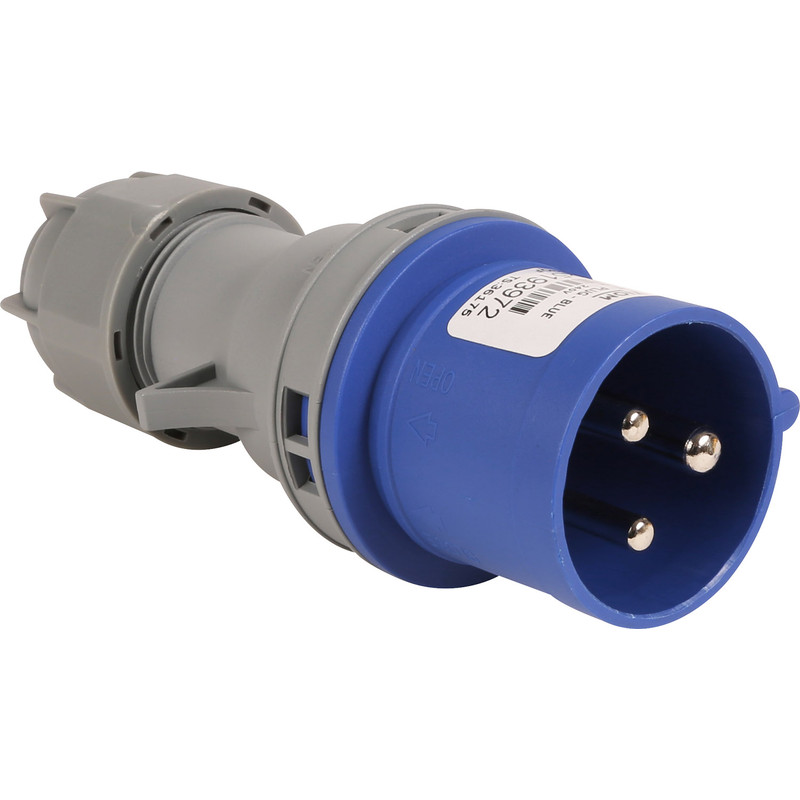

And this on the end of the cable
Definitely one of the cheaper ways to improve safety on board
That is a death trap like that for anyone who may touch the cable

The plug on the cable you attach to the source of 230v should be male, and the other end that you attach to the boat should be female - once you have attached the cable to a power source, the cable is live.
