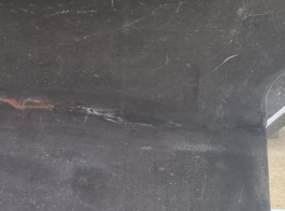

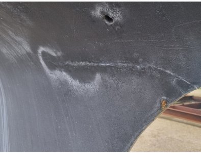

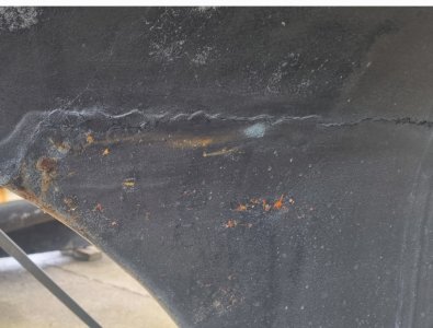

Hi I had a look today. She looks pretty good. She had a refit in 2014 new engine 6 years ago new standing rigging in 2017. I've seen on the Internet pictures of 1/4 berths. Are they a cut yourself jobby or is it alot of work? Also I sore some cracks in the keel I'll add so pictures now.

I've seen boats that have half inch thick antifoul that's built up over the years, it eventually starts to fall off in big chunks, maybe that's cracks in very thick layers of antifoul? Whatever it is definitely needs proper investigation before you make an offer. Has it been for sale 18 months (clue there)? It'd be a shame if it was something that needed major work, newish engine & standing rigging are big plusses.
As an aside these older boats can be very good value, I bought a 1969 Bowman 26 a few years ago, nearly new Beta engine, windvane steering, recent standing rigging & sails, tiller pilot, new bunk cushions (surprisingly expensive to replace) for 4 grand. The engine alone would have cost more than that.

Are you getting a survey done? Money well spent if you ask me. You could ask on here for recommendations of surveyors in your area perhaps.

Had one for 10 years-sailed very well. Suggest from photos that the keel bolts will need drawing and examined. Quite a few were home fitted out (mine was!).
