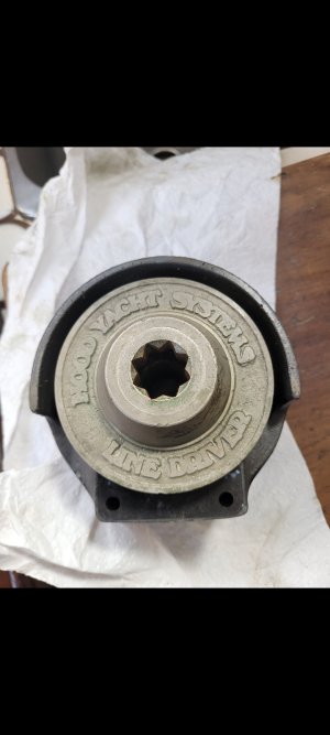

29 Apr 2024 #1 S SV Elizabeth New member Joined 28 Apr 2024 Messages 2 Visit site Can some body tell me how to dismantle a Hood continuous line driver, I had expected to find screws in the back of it, but not the case, as it seems to be screwed together from the inside Allan Attachments Screenshot_20240429_130111_Gallery.jpg 926.1 KB · Views: 14

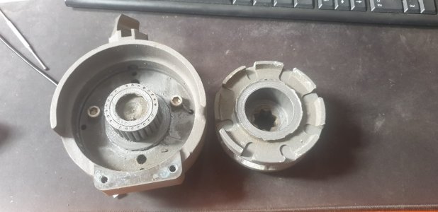

16 Aug 2024 #2 S Se7enSeas New member Joined 25 Oct 2021 Messages 1 Visit site You can just pull the drum straight out and the inside and bearings. If it's siezed it may need a little force but it's a solid unit. Attachments WhatsApp Image 2024-08-15 at 16.41.26_5c02d2cd.jpg 103.7 KB · Views: 4
17 Aug 2024 #3 S SV Elizabeth New member Joined 28 Apr 2024 Messages 2 Visit site Se7enSeas said: You can just pull the drum straight out and the inside and bearings. If it's siezed it may need a little force but it's a solid unit. Click to expand... Thank you
