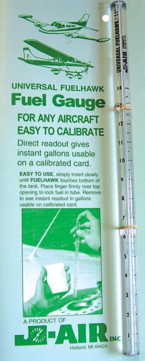

Alternative is rigid thin clear plastic tube. Poke that to bottom of tank, block top hole with finger, withdraw from tank to see fuel level, take finger off to return fuel to tank.
Very common method in general aviation.
Aircraft Equipment and Operations | Fuel Testers & Gauges | SGE084 Universal | Fuelhawk Fuel Gauge Universal (11 inch) | Pooleys Flying and Navigational Products and Accessories

Its actually what I thought about using on my mobo which has a plain flat stick - not very good .. and the pine dowel I made - very good.
One tip to users of this type .... make sure tube stays vertical !! once it angles from vertical can creep up and you lose the level. I used to have such on another item and the filler pipe was not dead vertical ...
