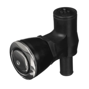

Was it on the transom? You could use a U, as Refueler suggested, but it must be high enough to prevent impact pressure from driving the water over it, and it must self-drain overboard.
(This type of transom vent has internal baffles to kill the velocity and a built-in U to resist slap. Common on powerboats. $25.)
I would NOT terminate it anywhere inboard. Reasons given.

I have a Raycor. Works very well. I've tested the Cleanway; a little combersome, but very effective. ABYC requires an installed mechanism to prevent overfill spills through the vent on all covered new builds.
Racor Lg100 Lifeguard Fuel/Air Sep.Gas/Die
Prevent Marine Fuel Spills, Fuel Overflows - Clean Way Fuel Fill
Taking the Spill Out of Fill-ups - Practical Sailor
