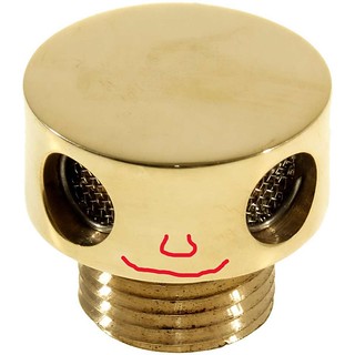

That style vent is actually designed for the gauze to face DOWNward .... not horizontal ... usually fitted into a vertical surface.
But anyway - with an inverted U any orientation of the fitting would work ....

Here's one shiny example, in brass....
This is not the most important issue, not a 'deal-breaker', in my quest but, as I'd encountered quite a few bodges on this boat along the way, I thought to find what others thought and did re 'breathers'. It's a diesel system, of course, so 'flame protection' is not a concern.
