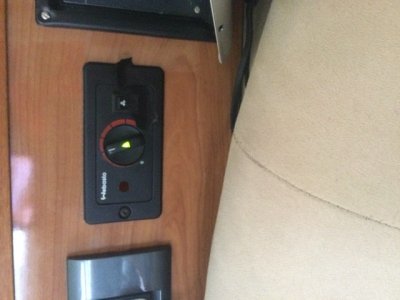

Ours is a webasto it’s so frustrating the control is a on off switch and a dial to control the heat which is crude it’s either to hot or to cold . Is there a better controller .
Pic or model number of your controller ?

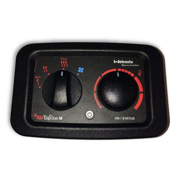

My Webasto has a switch and a dial, but works nicely at controlling the temperature, yours is either a different model, or it doesn't have an external temp sensor.
This one paul

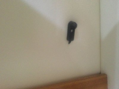

Mine is one of these, but it has a separate temp sensor. Perhaps there is a sensor option for your heater, what model is it ?
Is there a Hole in the control unit for sensing the Temperature ? - It may have a build up of dust - a Long shot I know but maybe use a vacuum cleaner to remove any debris - it wouldnt harm and a cheap fix if it works
