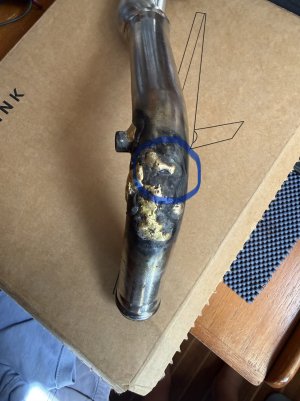

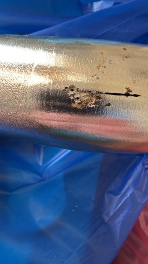

Our single cylinder diesel gen set has managed to rot out (despite it being stainless!)

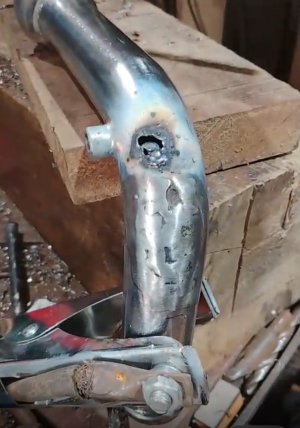

It started out as a small hole which I hoped could be filled with weld.
But when the local welder started he discover a whole area was rotten. We can discuss the quality of his welding another time!!
He tried patching it up with braze but it still leaked.
OK so investigate the price of a new one…
None in stock in the UK and if they can get one that’ll be £408 plus delivery please.
Ouch.

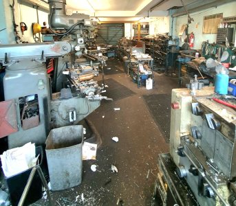

My kind of engineering shop. You can almost smell the cutting fluid.
Three Bridgeports I think and a horizontal mill too, loverly.
The only critical part of an elbow is the OD at each end so yes, weld it up from standard bend and two turned ends. Is what I would do ( or buy more solar panels and batteries with the £400)

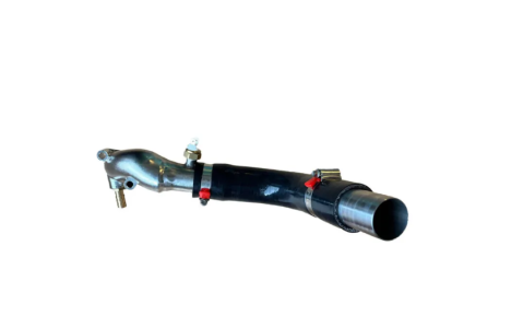

I’ve got a disc cutter with me so… Latest plan is to cut out the rotten bend and insert a hose. In a bizarre twist that’s what you get when you buy a new one for £408.
I’ll cut off the mount for the temperature sensor and get the local welding guy to braze it on just below the injection elbow as in the picture above. I could probably get away with zip tying it in place but brazing on the mount will be a proper job.
Local friend is driving me to the hose shop later this morning. Fingers crossed we’ll find a robust hose of the correct internal diameter and radius bend.
