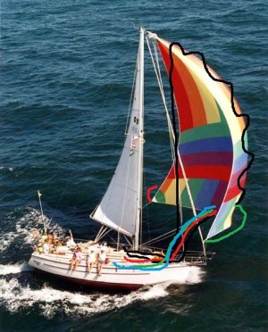

this is probably not the best spinnaker photo to mess with given i need to use different colours.....
there are 5 lines
Black line has 2 tails. one going up and zigzags thru the sail exiting at the hard. the other tail goes from the foot of the sail to the bag
Green line goes from the tack to the main eyelet, same as red line
Blue line attaches from the main eyelet and is a straight down haul
the point where the bag would be is the first point on deck where i made the lines touch, they then go a bit aft just for "illustration" purpose (not even sure the drawing can bear that weight of such word as illustration ahahah)
the retrieval process could be:
spill the sail by release the clew and tack guy/sheet
sheet in green and red line to max possible
sheet in top black line to max to fold the sail up
sheet in blue/black line to bring everything down into the bag
the sail would have to go up before it came down and inside the bag and the bagging would have to be in concert with the release of the main halyard
it a bit of lines to handle, but would this work?

the green and red lines were an attempt to fold the sail onto itself before it goes inside the bag. ie, its what you mentioned by zigzaging the eyelets. staggering the eyelets its a better solution.
when i mentioned zigzagging the black line i meant it as threading in and out the sail but along the centreline of it.
the second tail of the black line could indeed disappear, but the blue one would be the "bagging" line because one would need something the bring the bunched up sail down whilst keeping it bunched up (ideally the black line would "lock" onto the main halyard, this way the sail would be locked into a ball whislt descending). and ,thinking of it now, the blue line wouldve to be anchored at the head of the spinnaker, not the bottom. to ennsure i would have enough travel to fully recover the rail
i still want to sail to go into a bag, not a sock. my boat is 30ft, i dont mind undersize the spinnaker if it means having it i compacted inside a bag that i need only to clip to the deck and guardrails, and that i can easily handle thru the fwd hatch. the idea is to be fully handled by a single person and avoid crowding a small, to begin with, deck. Because that means trippping, falling, injuries, or worst.
