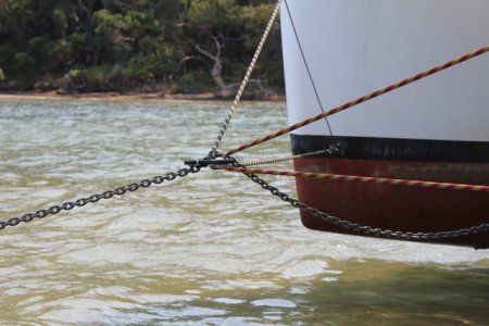

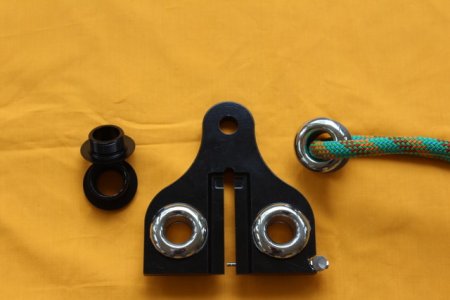

Deck bushes are bit like Low Friction Rings, or maybe more accurately LFRs appear to be derived from the idea of 'floating' deck bushes. Applications are limited by your needs and imagination.
To illustrate a bit of lateral thinking I used them in my design of a catamaran (it could have been a monohull) bridle and installed 'deck bushes' in the bridle plate. I had the bushes custom made as I could not find ones of the sizes I needed.
The application is described in this article:
Adjustable Snubber Bridle and Chain Hook - Practical Sailor
I had two types of deck bushes made, the black ones are in, black anodised, Aluminium and the silver ones - 316 stainless. They are the same size. The plate itself is made from Duplex stainless.
