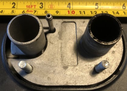

I have installed a 2kw Chinese heater. It is either going in the bin or hopefully back to the eBay store because it overheats and stops with the error code E-05, even when set up in the garden without any ducting or other air flow restrictions. I believe it is a rogue heater, as many other people use them without any issues.
It is the same size case as the usual 5kw/8kw units out there, about 37cm long with 75mm ducting.
However, most of the 2kw heaters are smaller, about 32cm long with smaller 60mm ducting.

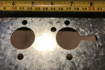

My questions are, do these smaller 2kw heaters still use 24mm exhaust hose? Are the fixing point centres and combustion in/out vents the same as the larger ones, will they fit on my expensive mounting bracket?
Here are pictures of the cheap mounting plate supplied and ports on the 37cm heater. The fixing studs are 55mm x 44mm, and the inlet/outlet centres are 55mm apart.

Our 5kw Chinese packed in and the replacement turned out to be a 2kw version. All exact same fitting sizes except the inlet and outlet air hoses are smaller on the 2kw.
Were the combustion inlet and exhaust the same 24mm on the 2kw as the 5kw?
I take it you mean the warm air ducting was smaller? Most 2kw have 60mm duct instead of 75mm.
I’m not too concerned about the ducting, that just needs a cheap adaptor, it’s the expensive exhaust and mount I’d rather not replace.

Last week I replaced an old Webasto with worn screeching bearings with a 2kw china heater. The exhast od is 24mm. I bought a stainless steel adapter from Ebay to allow the step upto my 28mm ID stainless exhast. I just gave the eBay seller the od and ID sizes and it was made to measure. It was a tenner. Just used my verniers to measure up. The replacement webasto parts were about 300 quid. The china heater under 100 quid and it works very well.

The combustion and exhaust are the same size on 2kw and 5kw also the mounting plate is the same.

Sadly this is still needing further clarification as there are 2 sizes of 2kw heater commonly for sale.
To save anyone having to read the whole thread;
Large size same as 5kw or 8kw 37cm with 75mm duct
Small size 2kw only 32cm with 60mm duct

The genuine small size 2kw is 24mm ,the larger size 2kw which is actually a 5kw but ran on low is 2kw is 24mm and the falsely advertised 8kw which is actually 5kw with a 8kw label is 24mm.Hope that helps.
Thank you for the comprehensive info. I did think it highly likely that the larger 2kw size I have is just a detuned 5kw.
I recently replaced a 20+ yr old Eber with a HLN "chinese " heater - is better made but pricier than the cheaper types but choose mainly because its exactly the same size as the D3LC it replaced and with 4 KW output. However I found after careful inspection of the old exhaust which I inteded to keep that the exhaust easily cracked on the bends and had to be scrapped. So please don't assume an old exhaust is still good - they clearly have a limited life.
