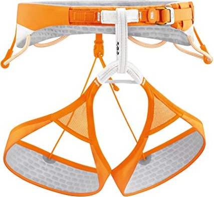

I agree totally here. Surely just about all crotch straps are designed to stop the lifejacket riding up when the wearer is in the water so wouldn't be designed to have the full body weight as either SWL or from an ergonomic perspective? That's what I've always assumed and I really don't fancy being lifted out of freezing water by even a couple of 1" webbing straps - that would be about 100Kg on them if you lifted a largish bloke out. It's also a huge load on the heart of the casualty given temperatures and the angle he/she is being lifted at. Ignoring the angle of lift the LJ would need to be similar to a climbing harness - Petzl know more about this than most and this is their high-end offering (actually it looks a little like something from a specialist lingerie catalogue in that photo :eek: ). Something like that would be pretty wearable on board but it still needs something that can keep you attached to the boat and tow you on your back.
https://www.petzl.com/GB/en/Sport/Harnesses/SITTA

The Petzl design, and many other reputable products of similar designs from other manufacturers, is excellent for what it does. I use one for mast work and many foredeck hands, on large racing yachts, use them similarly. They are comfortable and you can wear them for prolonged periods. They do not replace a harness, as they have no shoulder straps (so wear both).
As you say they don't keep you attached to the yacht nor tow you on your back - but that is an easy fix. Good hooks are available off the shelf - sourcing a good tether is easy.
It would be easy for a manufacturer, or decent sailmaker, to fit those leg straps to a current harness or fit shoulder straps from a current harness to one of the illustrated devices.
