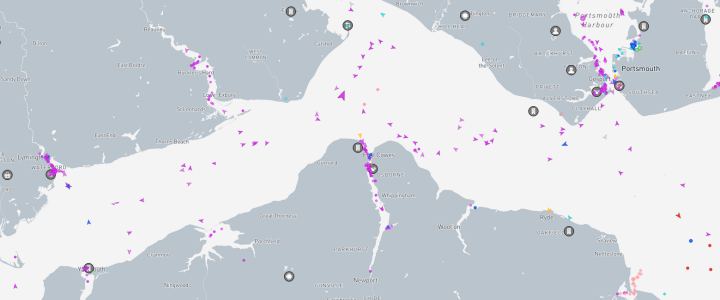

They probably have Class B switched off on receive.
I had a friend, sadly no longer with us, who used to get so annoyed when I emailed him to ask how his sail was. I had set Marine Traffic to let me know when he left harbour. Given that he was only going out around Belfast Lough I am not sure why he wanted the world to know.
Just look at the Solent now:

We don’t turn ours on in the Solent unless it’s dark or foggy. No need for more clutter

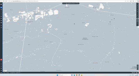

Orca uses internet data from Marine Traffic. Using internet AIS for navigation can be very dangerous, as it's often several minutes behind real time and there are lots of dead spots where it doesn't work at all. Relying on overlaid data to predict a vessels future position would be particularly risky.
On our canal there are no internet connected AIS receivers feeding data to Marine Traffic.
At this moment there are 2 vessels within 30km of my boat that are linked by satellite that are shown as moored, and there are 4 vessels in our marina that are transmitting that they are in moored in the harbour but cannot be seen on Marine traffic but were showing up on my AIS, plus a few more, more than 35km from my boat that show up on both Marine Traffic and my AIS.

Marine Traffic relies on data being sent to it. I suppose they don't have a lot of AIS receivers in Birmingham or wherever you are.

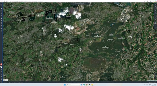

We are at Kerkhoven in Belgium, you can see one green dot for a tug that is anchored just NW of Leopoldsburg and another beside Kanaalmeer, The authorities are pushing for all boats to have AIS on them as they want to make the sluis/locks automatic and to traffic plan for better water conservation. It's Sunday, the lock keepers have a day off and they won't start a Sunday service until after 1st May.
